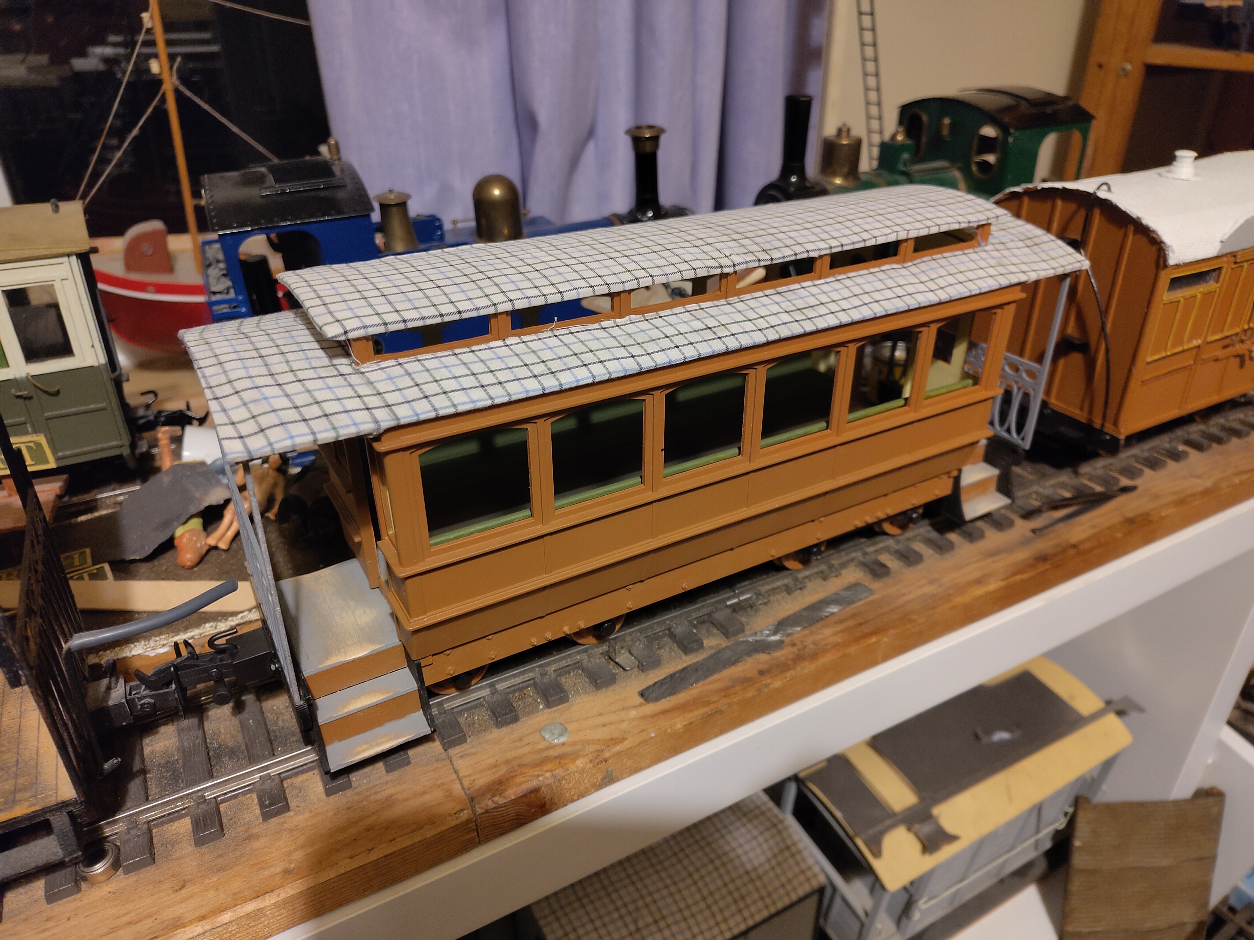

Back in April 2024 I bought a Bachman Street Car from ebay. At the time I had not seen StuartJ's post about his conversion! What I had in my head was a conversion to a typical Colonel Steven's backwater railway balcony carriage with some hints to the W and U carriages thrown in. It was also bough as another excuse to have a go at painting a carriage in Stratford Brown with lining.
The body was kept pretty much as is with some of the holes filled. The roof and balconies, however, were redesigned to give a more Wisbech and Upwell carriage feel - as usual, these were drawn up and laser cut. The balcony ends are a snug fit into the plastic moulding of the body and were epoxied on.
(to build)

The solebars were then detailed up with Cambrian plastic nuts and bolts, with reference to the W and U carriages and the curved ends of the roof were sawn off and replaced with LASER cut ply ends which were carefully glued and clamped to the existing roof with high strength epoxy. I am reminded of a saying from a boat building friend of mine "He who dies with the most clamps wins".
Following this the carriage was primed ready for painting - the balcony railings are LASER cut from 1.5 mm mild steel using the department's fibre LASER.
(to build)

The carriage was then painted in Revell AquaColour MudBrown using an air-brush and a lot of swearing (I've since discovered I was using the wrong sort of air-brush for this sort of application) and lined using a bow pen and humbrol enamels. I wish this was a little neater - I'm still learning.
After this the roof was covered in shirt material - the plastic has a texture moulded into which would be impossible to replicate on the wooden sections so the shirt material was the quickest way to get a uniform finish. Using old shirts like this is handy as the grid lines help to keep the waft and weave square to the roof!
(to build)

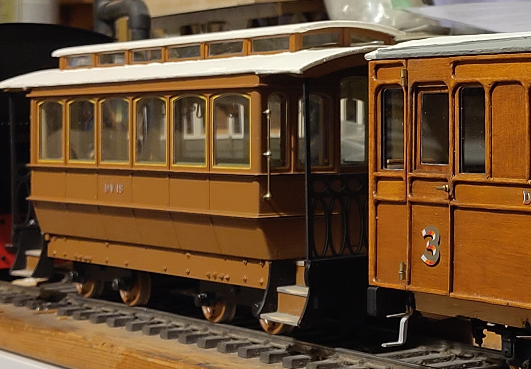

The roof was painted white and the interior was painted in Railmatch GWR carriage cream, with olive green used for the seats in a nod to the DVLR's original carriage livery.
The carriage was then re-glazed. Rather than the original plastic moulded glazing, I LASER cut individual windows from thin acrylic which were glued into the window recesses with glue'n'glaze. This means that, as the carriage passes, the light reflects in different directions from each window so you can tell it is not a single sheet. It also tidies up the interior a little. It also allowed me to add some LASER etched detail into the end windows.
With the balcony railings attached, Brandbright bogies fitted and shortened Accucraft chopper couplings fitted the carriage is now in service. It has recently acquired GER style transfers to bear it's running number "DV 19" from Endon Valley Decals. I'll order another sheet with "SECOND CLASS" to put near the ends on each side. A bit of light weathering and some brake gear and it'll be complete.

I don't think anyone would have guessed its origins if you hadn't told us.
Another great addition the fleet.

It is on record somewhere that I have a general disliking of balcony coaches, but this one is a stand out model and certainly one I could live with. Great job.

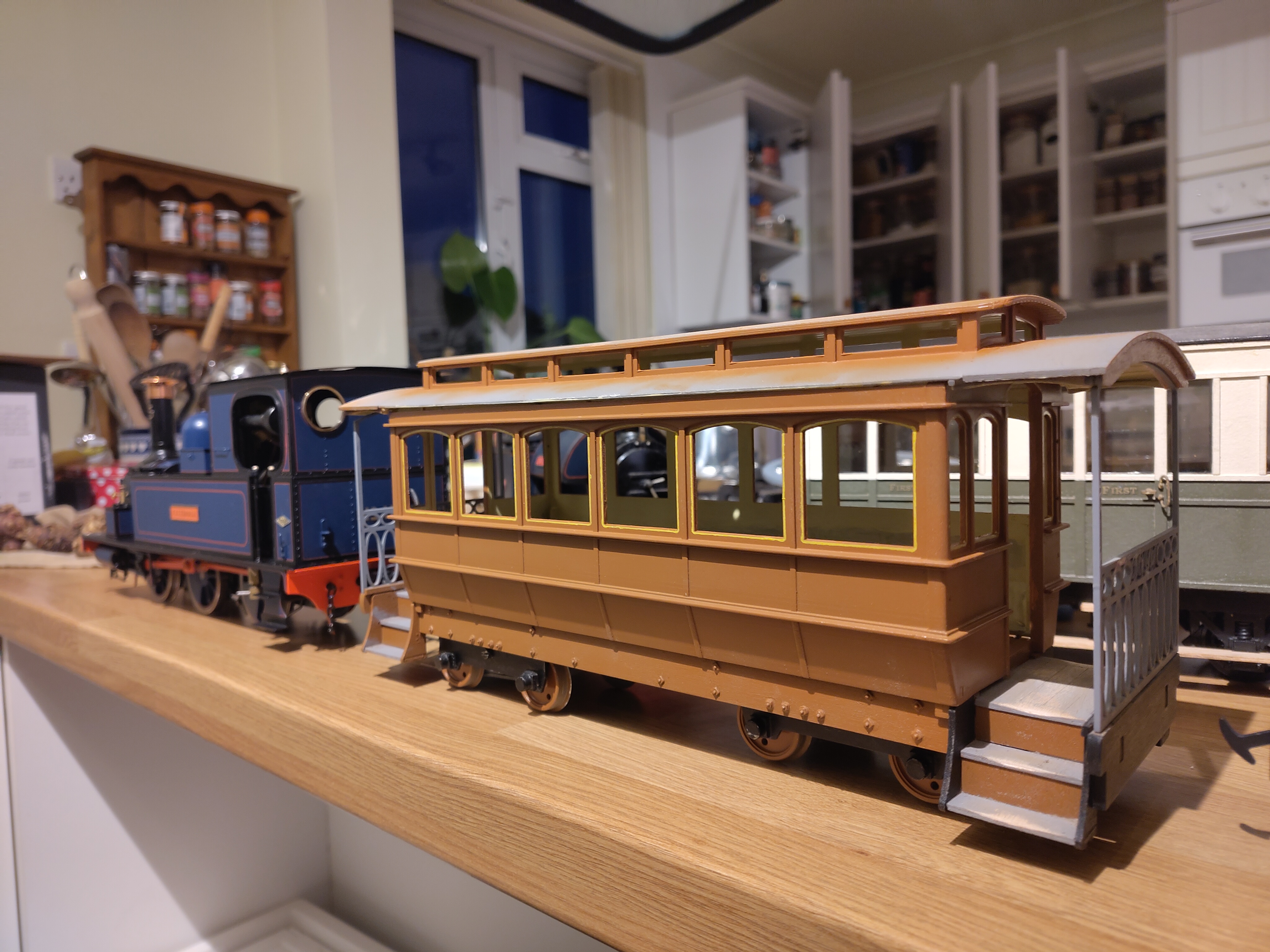

As we've discussed before, they are quite reminiscent of the Mt. Lyell coaches once you put 'railway' balconies on them. They are quite small in 16mm scale though.
Alternatively, with two extra windows and different 'tramway' platforms/balconies they are also quite close to the Manx Electric Nos.57/58:-
Manx Electric Railway - Saloon Trailer by Stuart, on Flickr

Certainly some similarities there Stuart, thanks for posting. Would you happen to know the width of the car body of the model.
