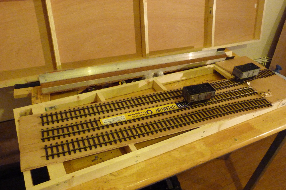

Sector plates are quite simple to make compared to traverser tables
In the second image i have soldered brass tube to the rails and used brass wire as a bolt to lock the track in position.

Hmmm. Maybe - I'll have a measure up and see if the space/geometry works for me. Thanks.Preseli Chris wrote: Tue Aug 06, 2024 10:35 am Sector plates are quite simple to make compared to traverser tables
Re: The First Great Project...
Thats actually a pretty neat idea Chris.

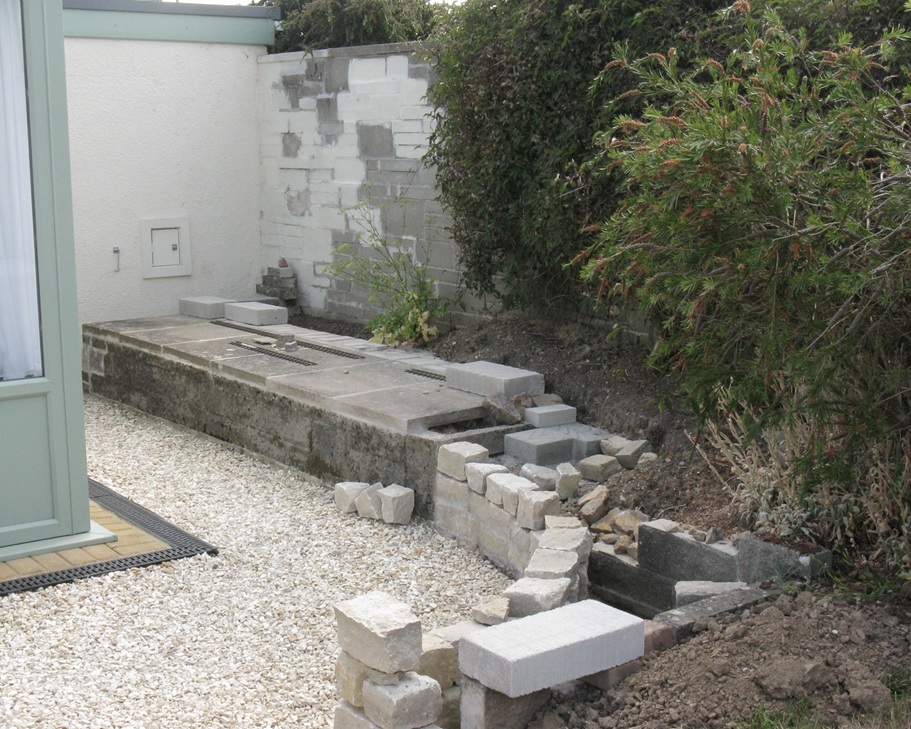

Well, 2025 saw much less progress than I hoped for. The replacement of the conservatory made a big hole in the spring-summer period and then the summer and autumn saw numerous domestic and personal issues demanding urgent and extensive attention. However, the generally milder temperatures have helped extend the construction season into December and I have been able to continue block laying and concreting until recently.
The photo below shows the south or garage end of the steaming up/cool down station yard. A new wall was built as a ‘counterscarp’ to the garage wall itself, to reduce damp problems. A dividing wall was constructed to parallel the existing (low) patio wall and act as the second base wall for slabs. The space in between was filled with flint rubble and some tatty old bricks, once compacted this forms a secondary supporting base for the slabs and allows any water percolating through to drain away via weepholes I created in the old and new walls. The strip next to the garden wall was excavated and much vegetable matter and rotted manure mixed in – when I’ve finished repointing the wall and it’s painted (spring 2026?) then I’ll plant a couple of climbing plants and some lower ground level items.
The height of the slabs now is around two blocks (laid on their largest face) and mortar layers below the ‘cat flap’ in the garage wall. I plan a ‘spine’ down the [central] edge of the slab for the main line and will add support for the loop and sidings when I am clearer as to exactly where they are going. The idea is that when everything is built and tested, I’ll put some earth/gravel/compost in the spaces in between and this will let me grow some ground cover plants in the station area so it’s not all bare stone and track. The slabs are laid on a slight slope so water should drain towards the path. I hope that this and various weepholes I’ll include in the track support walls will stop these areas being too boggy.
On the other side of the garden, I had to attend to other significant civil engineering works due to last year’s Storm D’arrrgh. Two retaining walls (and much drainage!) were installed for the raised flowerbed in the corner. The boundary side of this has been planted with hazel and hawthorn, together with some wild flowers – experts might be able to spot the Red Campion and Herb Robert. Some bulbs are in there too. Somewhere!
Backtracking towards the photographer, the line of blocks went in on an approximate five foot radius curve – these are not the finished PW but placeholders, so plant roots will not be disturbed when the time comes to lay the track permanently. I expect it to be two years or more before I reach this corner, it is down in Stage 3 (of 3) of construction.
I attach a revised plan – this may well change again when construction springs out of the garage ‘bridgehead’. The main change is the expansion of the ‘other’ station in the corner – I thought two or three extra sidings would be very useful both for extra operating interest and for coping with guests’ stock on running days for the local group. I do wonder how popular an end to end (‘I’ or ‘Y’) system will be until I can finish the circuit? We will have to pay attention to our signalling. Provisionally, I plan to adopt Tal y llyn practice, with limit of shunt and ‘U’ boards going in on the trackside. I don’t mind acting as a blockman or bobby but I seem to be in a minority in the local group there, so I’m working on most signalling and point changing being done by the driver(s).

It's high time for an update!
The groundwork for the spur station continues. Most of the first level is complete and I am now stalled until the points issue is resolved and I know whose points I will be laying and what radius they are. Once this is sorted, I will lay blocks under the lines, leaving space in between for soil and plants so we can have a proper rural station with some greenery and not just an expanse of concrete. I will leave some of the lower level [slabs] exposed to kneel on or place steaming paraphernalia on but want the middle and back areas to be 'landscaped'.
Some more painting and pointing on the rear wall has been done but I am rather behind schedule. The new garden wall progresses, with blocks both laid and selected ready for the next batch of mortar. This morning I worked on the new steps onto the lawn (right centre second photo), digging foundations and selecting blocks. Progress was made but the soil is desperately hard, we've had well over a month without rain and the ground is very hard. Someone broke the pick earlier....
which will delay things a bit until we can sort a repair or replacement.
