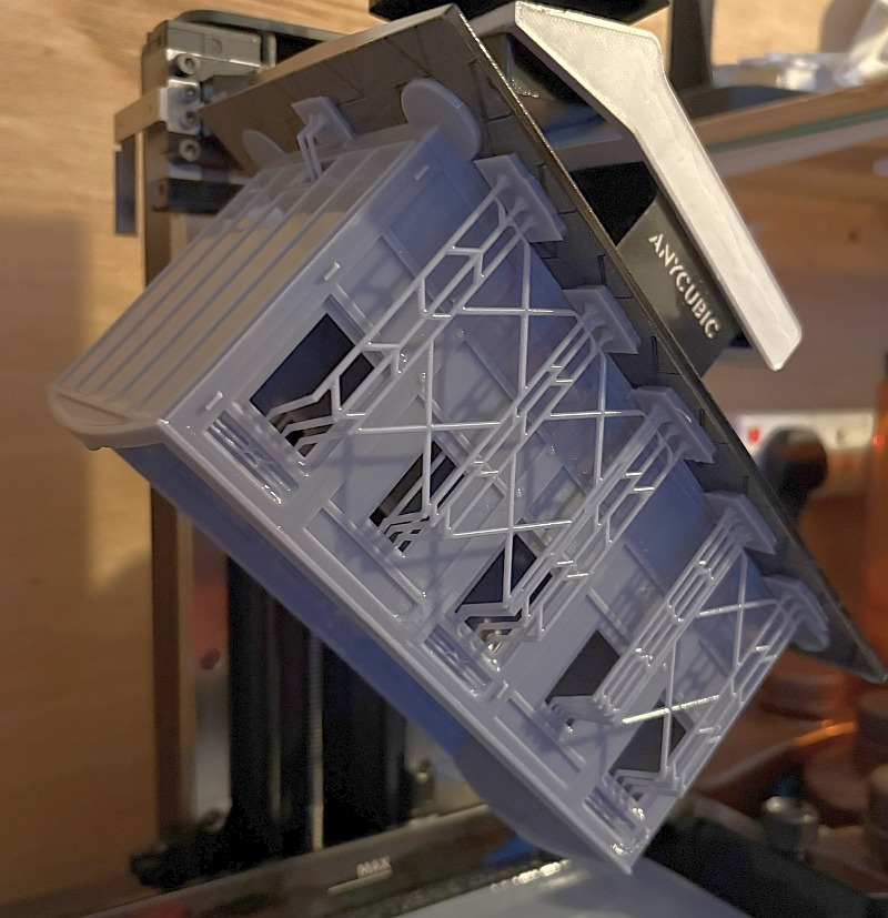

After the very wet and not very cold winter we've been having ( although it's bitterly cold and might snow today!) my garden track looks like a cross between the BigDipper at Blackpool Pleasure Beach and the jungles of Borneo, and is not very conducive to photography! I promise I'll take some pics and hopefully one of my awful little video's as soon as it's worth it.
In the meantime, I did manage to put a sneaky print of the body of one of the All Thirds on over night and it is currently dripping:

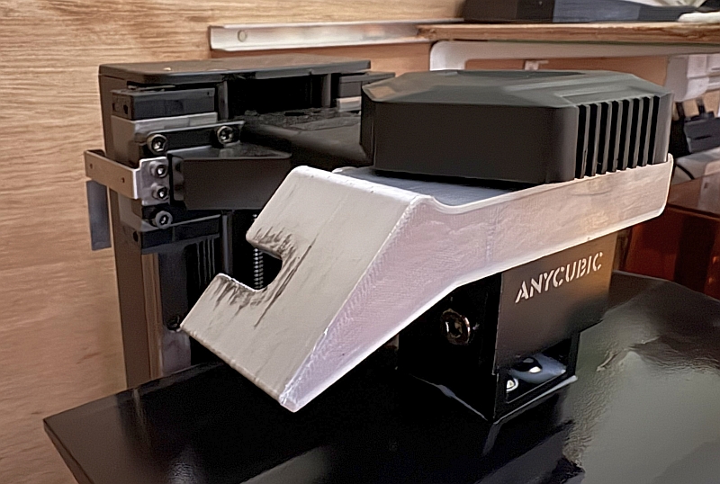

Does the build plate tilt on your printer? I wish mine did, it would help catch the drips after printing.

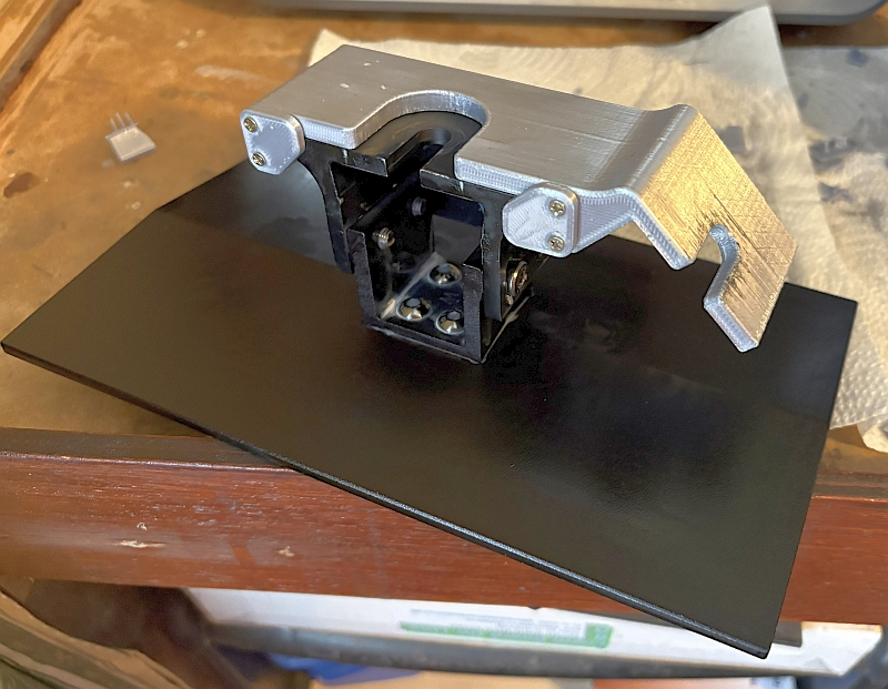

ge_rik wrote: Fri Mar 13, 2026 7:36 am Does the build plate tilt on your printer? I wish mine did, it would help catch the drips after printing.
No, not as such. The silvery coloured bit is a printed part which is clamped around the plate mount bracket and gives the angle.
So the pic below shows how it sits it is whilst printing. Once the print is finished, I simply loosen the big knurled knob, slide it forward and relocate it on to the slot in the angled bit. You can't really see but it is also slightly angled forward so that the resin runs to the bottom RH corner and improves the amount that drips. The stl for it came from Thingiverse. Just do a search for your machine and look for "drip bracket" or similar. you'll probably find there are half a dozen variants by different people and its just a case of looking until you find one you like. I think i printed a couple of others before I found this one.
