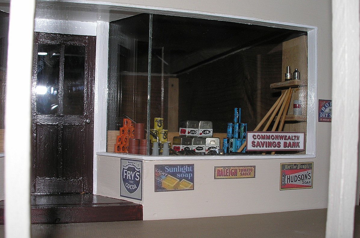

Post by LNR » Sat May 30, 2026 4:46 am
Microscope slides and thin picture frame glass are my go to sources for glass windows. Being outside and close to the ground glass is easier to clean and doesn't scratch like clear plastic.

Posts: 1888
Re: Hammertoe, my 16mm scale 45mm gauge Indoor layout
Post by LNR » Sat May 30, 2026 7:20 am
DCooper wrote: Sat May 30, 2026 4:57 am Do you have any hints of tricks for cutting such thin glass?
I seem to have about a 40/60 chance cutting glass, in favour of it breaking!
A "diamond" cutoff wheel in Dremel equivalent is best for thin microscope slides I have found, though getting slides is harder now. Of course I'm not fitting glass "into" a frame rather glueing it to a surface.
Railway Scenes 150.jpg (284.32 KiB) Viewed 6006 times
This night shot of the windows and door of the Nayook store is 1.5 mm picture frame glass and has been outside for years showing no signs of scratching.
