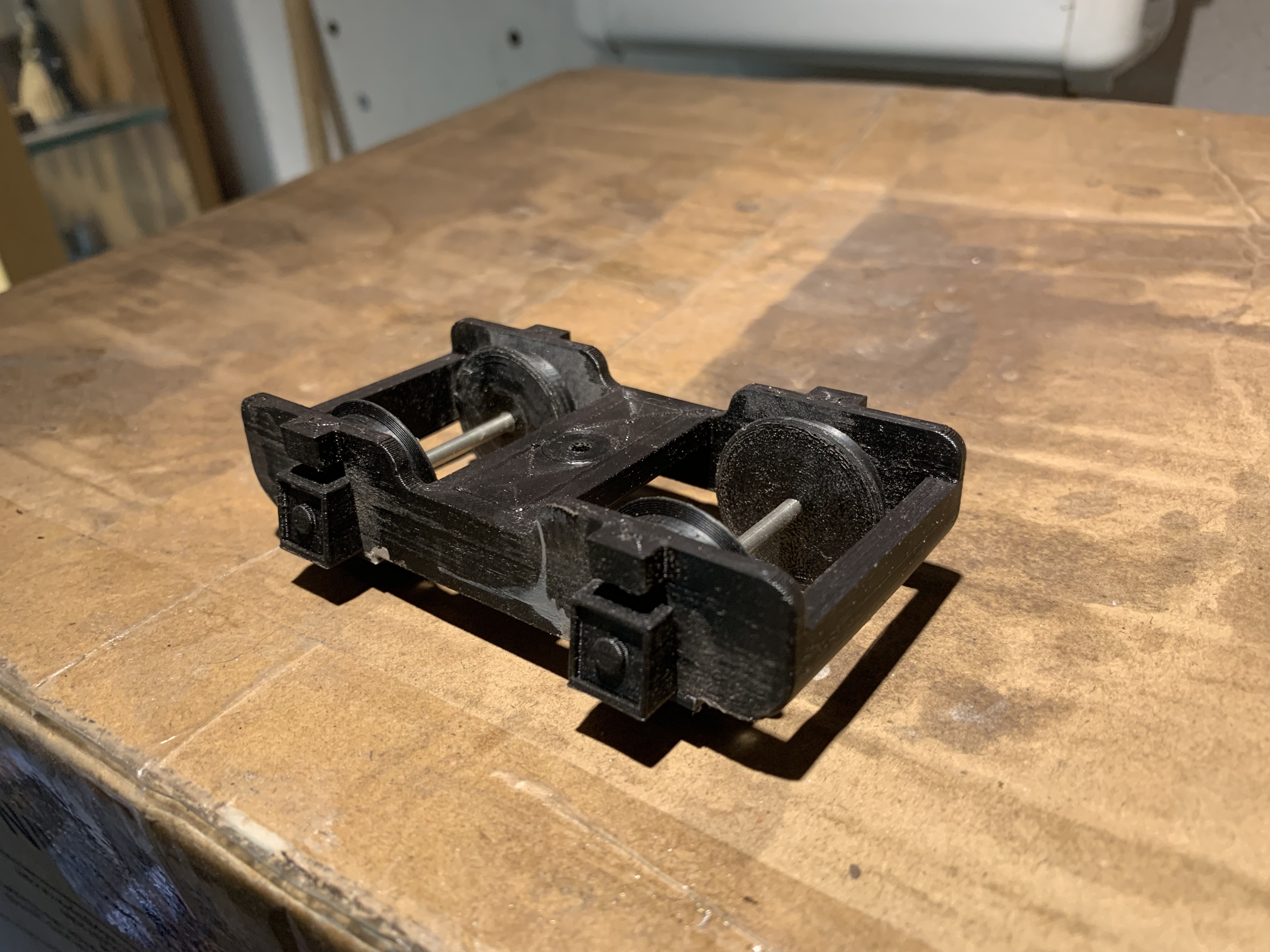

The bogie was printed flat on the bed, upside down, and you can see that it has the slots in it for working sprung axle boxes - rather like the ones on the Cleminson Coal wagon. This time they take 10mm long 1.5mm diameter springs. One bogie body, a wheel and an axle box:
and one assembled bogie:
The components needed some fetling to get them to fit, and move freely.
The external detail such as strapping was printed separately and is bonded to the body using acetone. Remember I print everything in ABS - and the solvent glue for ABS is acetone:
