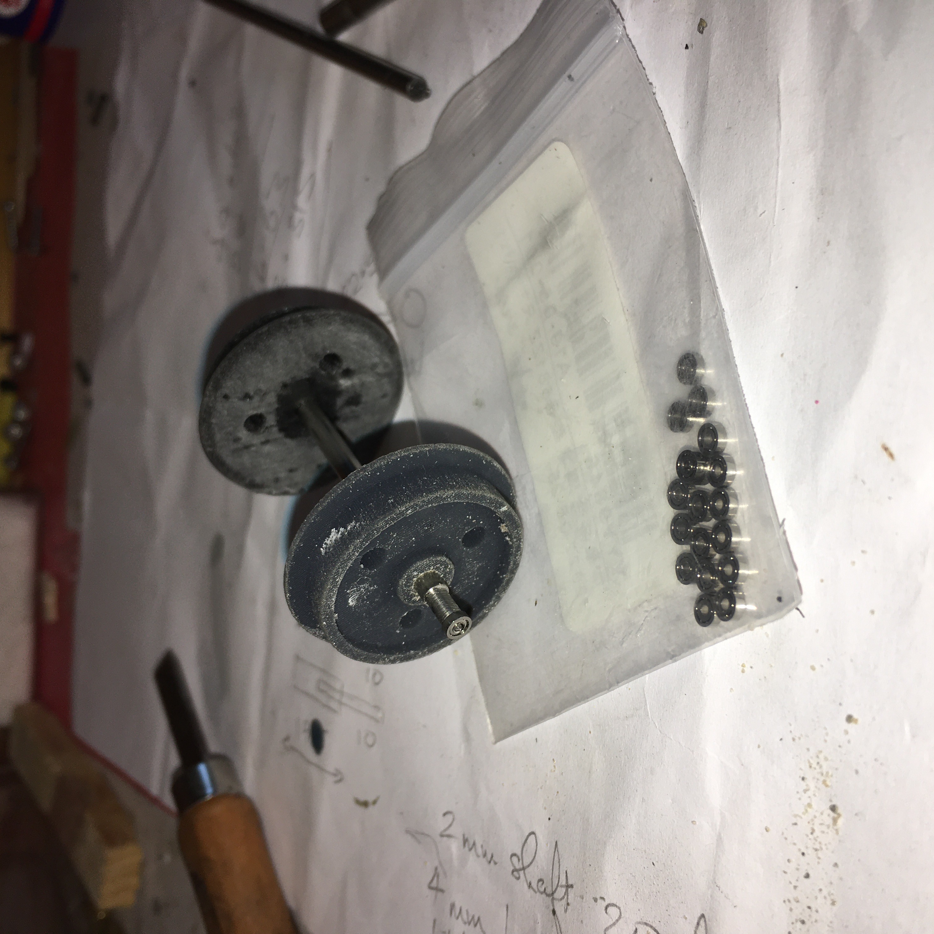

A bit of a change of direction on the wheels. I found some stainless rod which was 2.98mm diameter, and which I could make fit into 3mm reamed holes in the resin printed wheels. So back to resin printed wheels. The axles were turned down for the bearings:
That is the 3mm OD, 1mm ID bearings which I have been using on my slate wagons, fitted onto the end of the axle. Of course I had to fix the wheels onto the axle using superglue.
