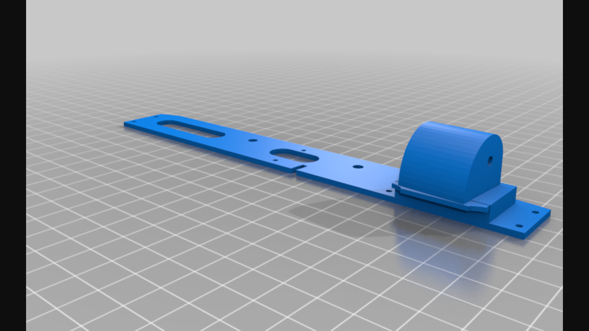

Post by tommygander1941 » Fri Jun 27, 2025 9:44 am
Ah yes, well the 32mm one is good. It's more the 45mm one, the cylinders are spaced further out from the frames but include the top bit of the frames which go against the smokebox, on the real loco they should be part of the main frames yet on this 3D model they are further apart from the actual frames which gives the D shape smokebox, when it should be curved
Screenshot 2025-06-27 09.42.53.png (660.24 KiB) Viewed 74322 times
Screenshot 2025-06-27 09.45.02.png (660.43 KiB) Viewed 74321 times
