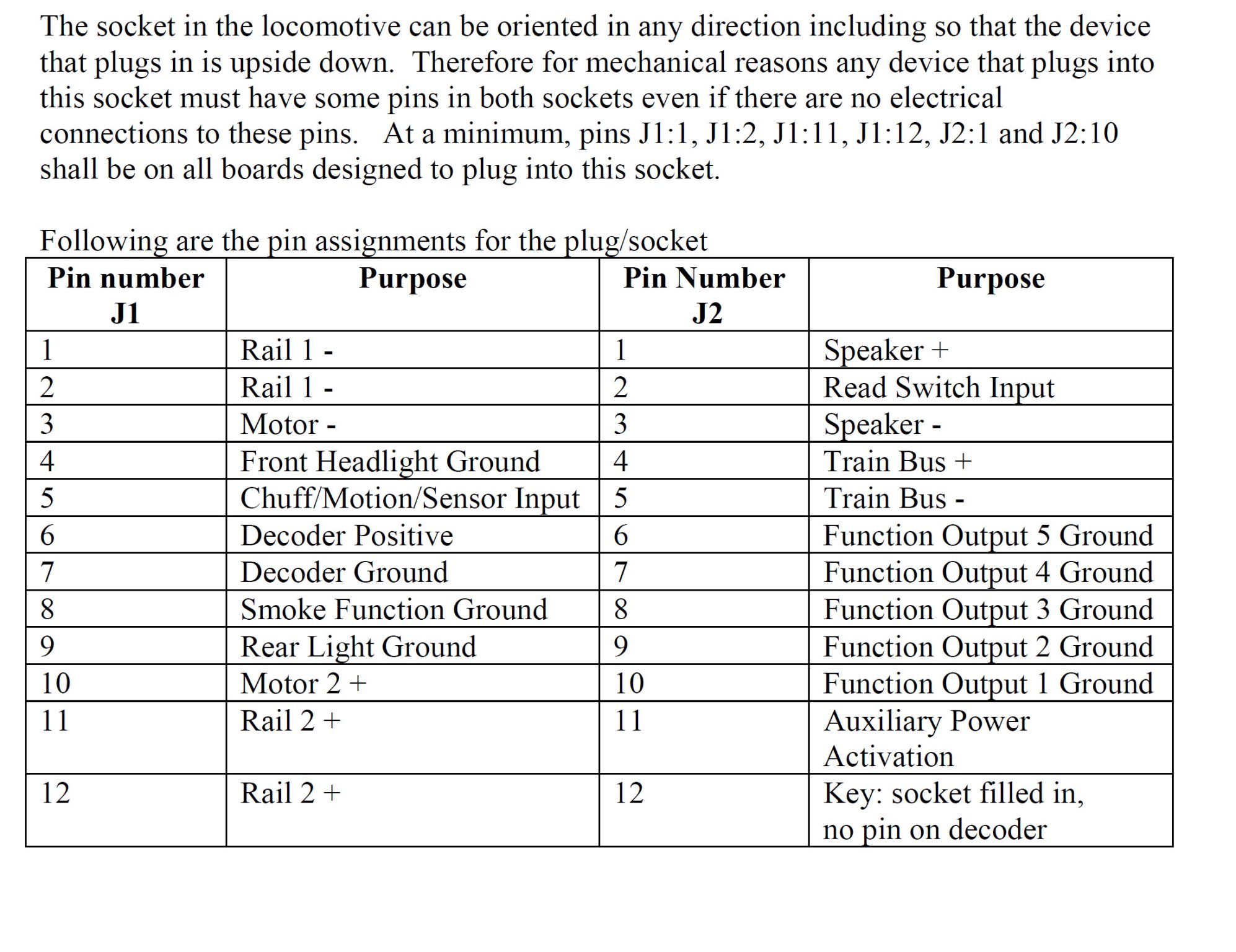

indeed I could rip out the motherboard and start from scratch but rather than go down this path I was hoping to find what the pin in connections are for J2 6 to 10 on the motherboard socket.
As I said in the first post I have the locomotive running with sound so this is not a a deal breaker (I didn't bother to connect smoke, ashpan flicker, etc. on the Shay which had already had its motherboard ripped out before it came to me).
What I was hoping for is something similar to this:
(table courtesy of Pete on another forum)
Would have been good if Bachmann had put something in the Mallet PDF that indicated what were connected to Function 1 to 5 pins (if anything).
Once I sort this out (if able) I will post a similar table for the socket on the motherboard.

many thanks to those who assisted - I have attached my first version of the connections for the Bachmann Mallet and those to a LokSound 5XL decoder.
Everything is working except for the smoke generator which works if I set the switch on the smokebox front to DC but not with it set to DCC.
Suspect this is more a programming issue I have with the decoder - otherwise it all works.
Any corrections or revisions would be most welcome.
