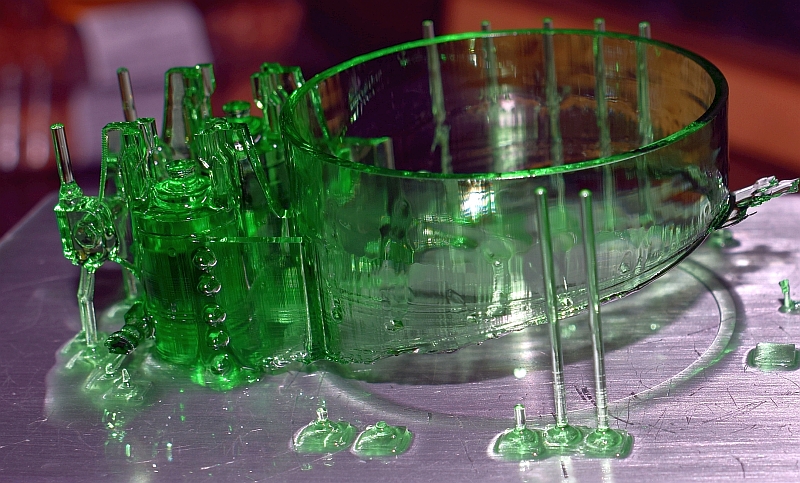

Several weeks ago I printed the boiler complete with cylinders, slidebars etc, for my DeWinton. I printed exactly as I had hoped with no problems - until I realised that I had the diameter wrong (I had thickened the walls inside the original cylinder instead of outside, so that the o/a diameter was 3mm to small).
No problem - rescale the boiler and reattach the cylinder ,etc, assembly then reprint. This is where it all goes to pot. The boiler cylinder now refuses to print properly. It lays down a base layer and then creates a diagonal opening/split which slowly gets small er until it joins itself up and then carries on up, printing properly. I have tried it at least 6 times, using 4 different types of resin and even redrew the whole thing part way through this saga.
I'm as sure as I can be that the drawing is fine and the slicing doesn't have any problems that I can see. The only thing I can think of is that the settings are incorrect, but I'm using the same ones I've used since forever, and the same ones that printed fine the first time and that I've used for all the small parts I posted a few days ago.
I suspect that it may be to do with the suction created inside the print as it goes up and down, but how do I allow for that in the settings? Any suggestions?

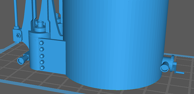

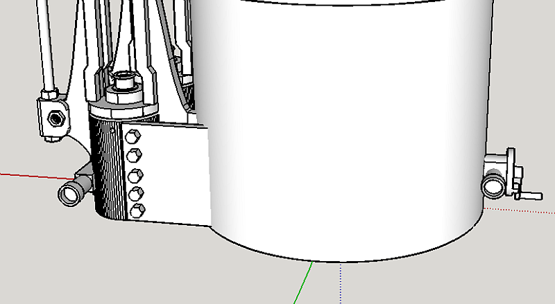

Sketchup drawing Chitubox slicer Failed print number 7

No idea, sorry. My only observation is that the summit of the missing chunk seems to coincide with the height of the bracket on the opposite side.

Thought it might be of interest to show a print coming off the flexible plate. I have literally just flexed the plate and swmbo managed to grab a piccy as I did so.

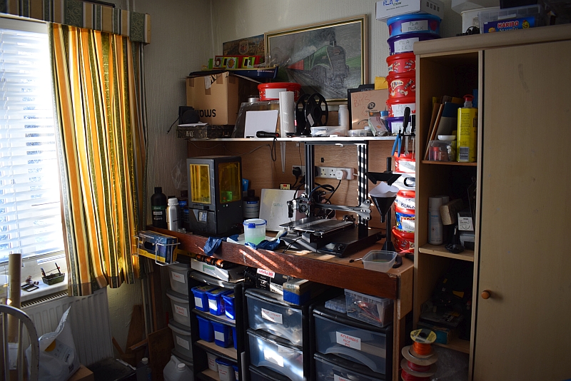

How are you getting on with resin printing in the temperatures we are experiencing? You must have it set up in a comfortably warm area!
- Posts: 6064
Re: Print splitting
I have both printers set up in the small spare bedroom that I use as a workshop and general dumping ground. Atm, the radiator in there is off, but the door is open so it gets some warmth from general heating in the house, although that is also turned down significantly!
