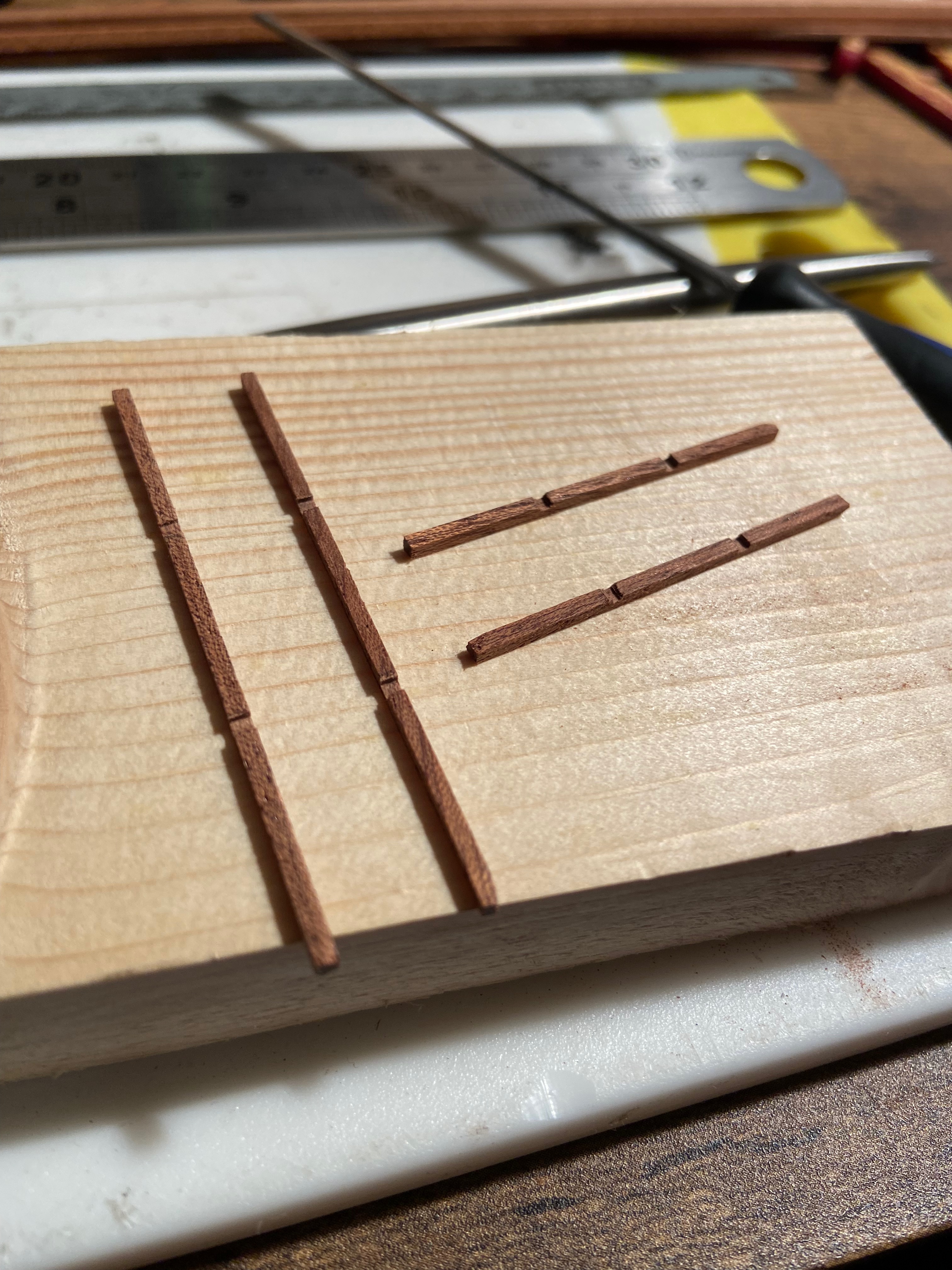

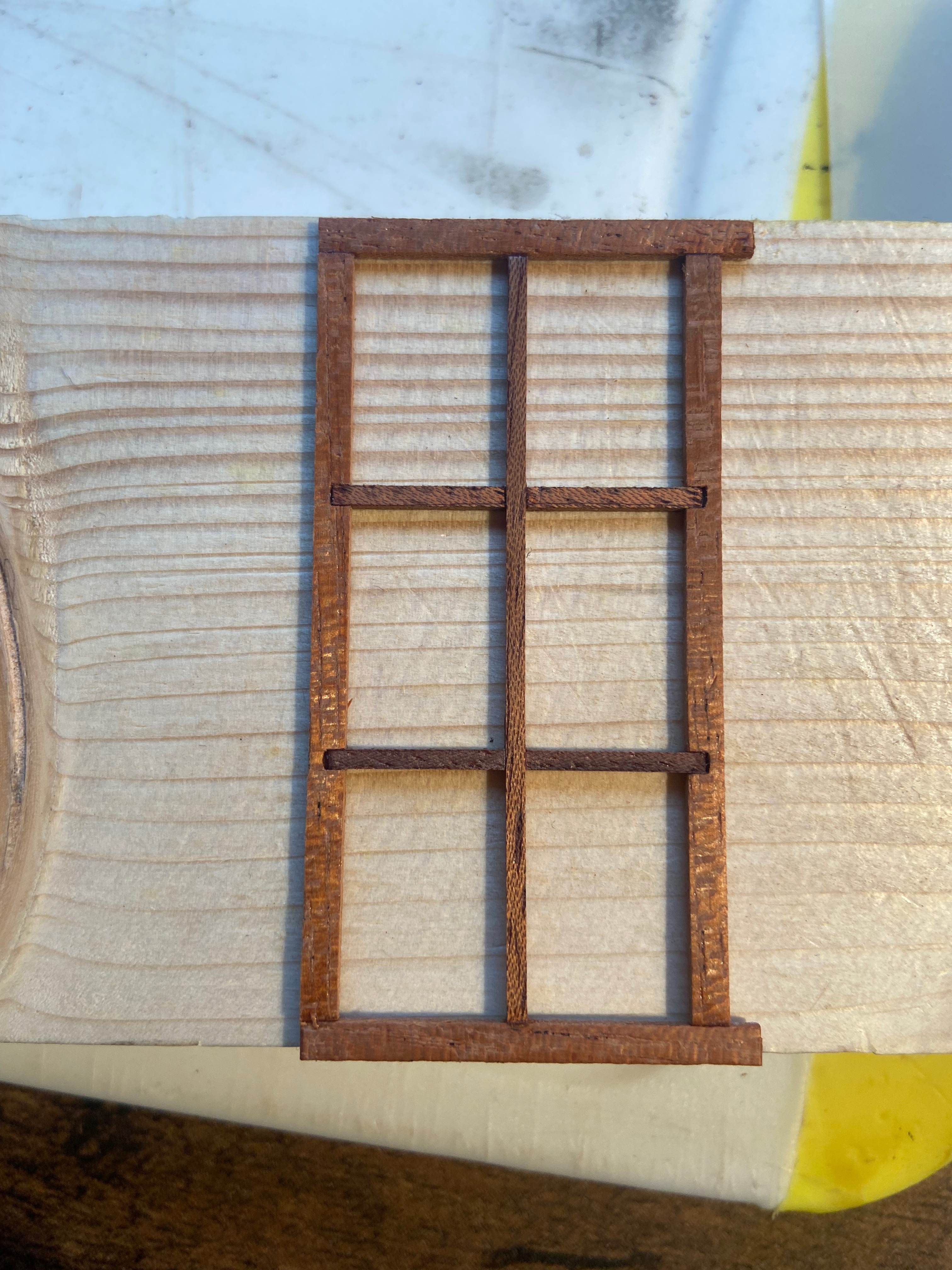

I then decided to make a move on replacing the windows I had ripped out. I thought I would trial some frames made out of 1.5mm square hardwood strip to see what would be possible. Whilst the frame worked well around the edge, I found that trying to create any sash bars was nearly impossible with just butt joints. I trialled some miniature lap joins instead.
a needle file was used to create the notches - here are the results:
Success :D

To continue the build, here is the first window I trialled. It uses the joining method shown in the last post to hold it all together. I have also added a simple frame to the window in the door as well.
As I was happy with how the side windows looked so I turned my attention to the front.

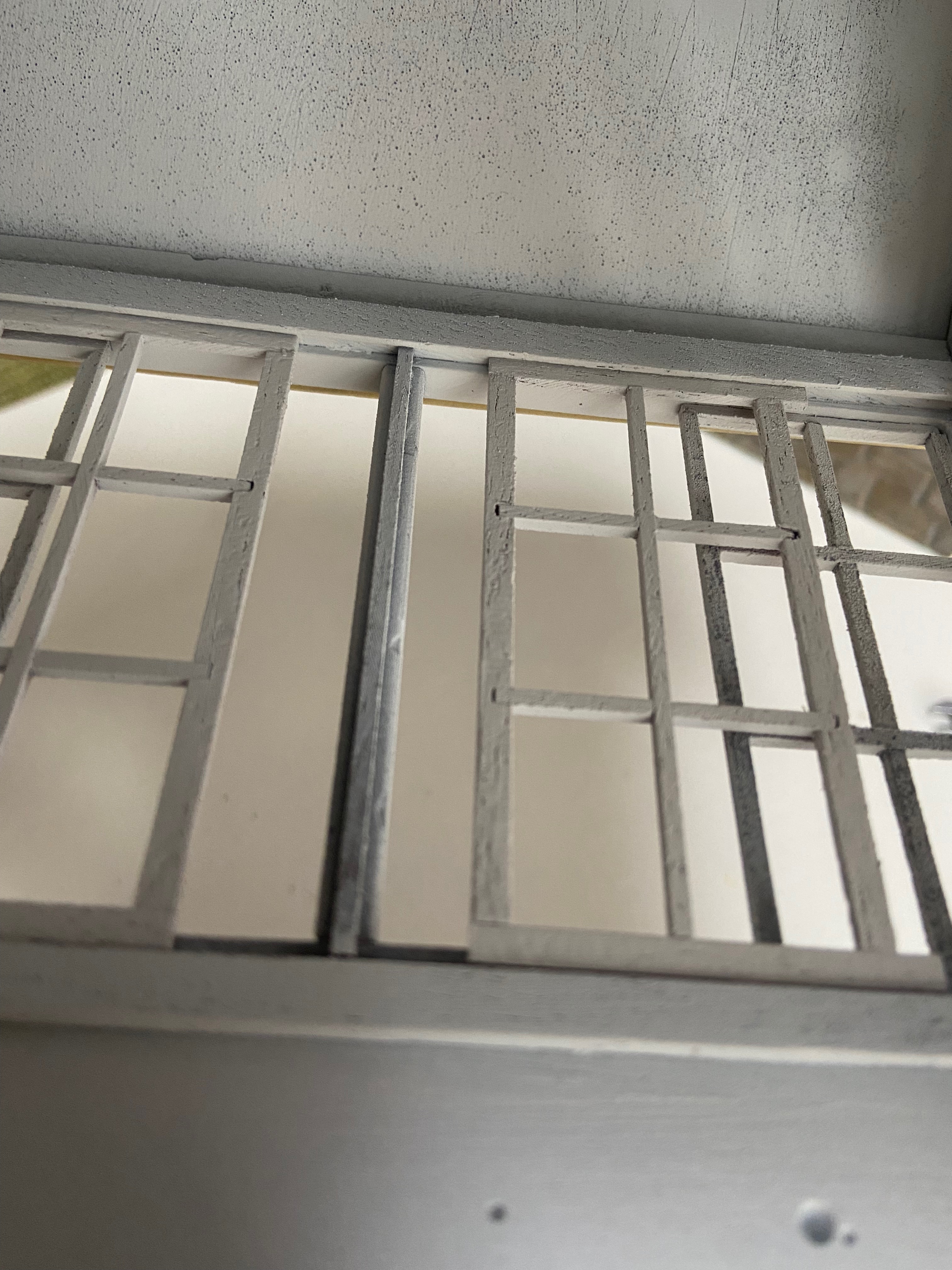

Looking at prototype photos for inspiration I had noticed that almost all signal boxes had sliding sash windows. Also, I always like it when doors, windows etc are modelled with the ability to be opened and closed. I thought it would be nice when, for example, I'm running trains on a hot day, to be able to open the windows on the signal box - adding a nice bit of authenticity to the scene I feel. So with these criteria in mind I set about head scratching.
some sashes were made up:
These were then trialled in the window frame to see if it could all be made to open and close
The dimensions of the sash were designed to fit behind the existing frame (on the inside of the wall). This would mean that they only need a thin runner along the top and bottom of the window to hold in place.
this photo should help it all make sense:
After many happy hours of cutting and sticking what were basically match sticks, I had got this far:
First coat of primer has also been applied
It still needs more sanding and filling but it's getting there!
more to follow!

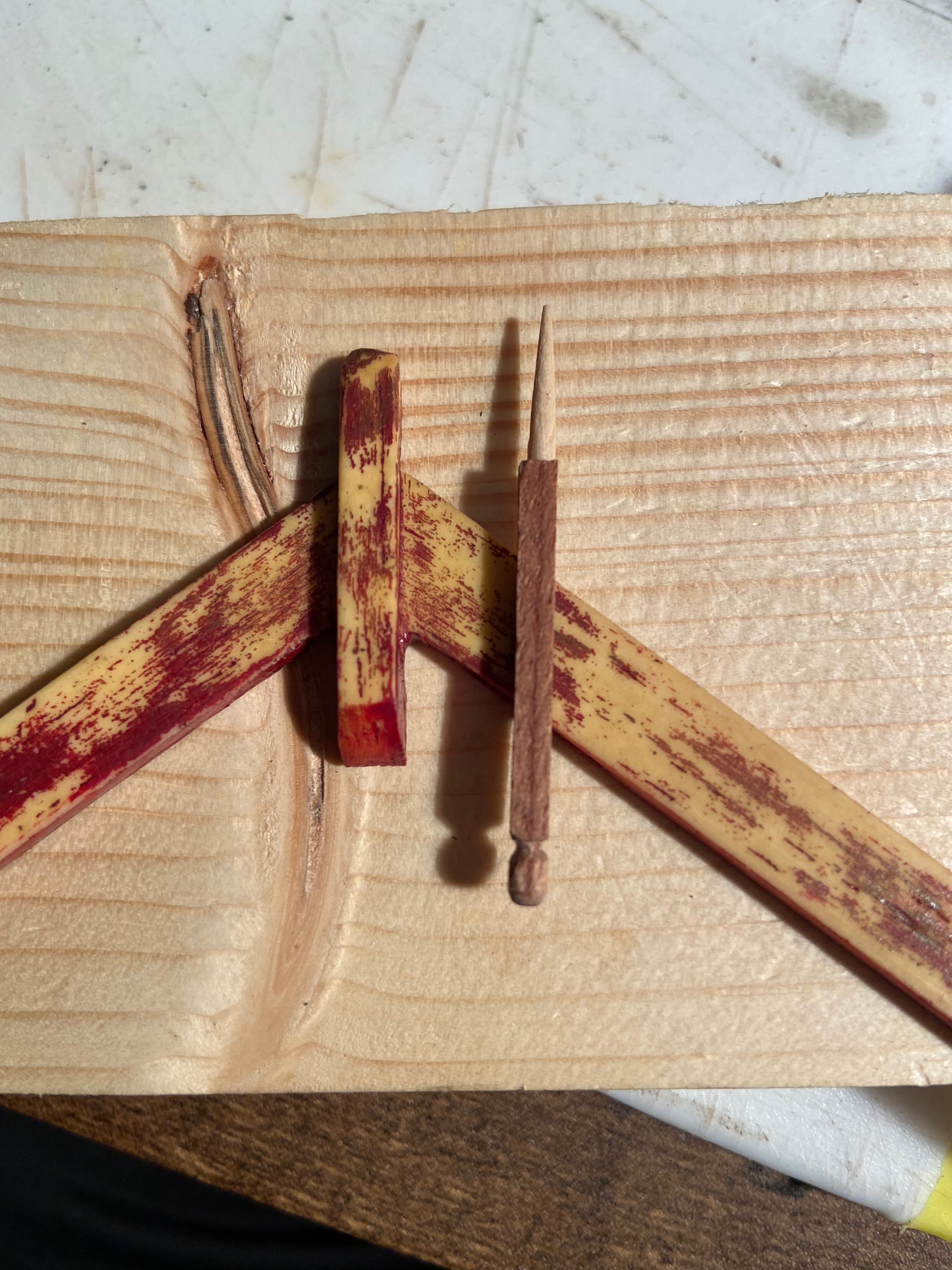

To finish the roof I now needed to replace the resin barge boards with wooden ones. I couldn't resist tackling the finials first however!
The spike is made from a cocktail stick guided into a 2mm hole in the end of the finial
I also added a little carving at the other end
Here is a comparison with the old resin one:
I thought the new finial looked quite vulnerable considering how thin it was however the building is far away from any 'hand of god' operators when the railway is in use so I'm hoping all will be fine! Plus, it will get taken in during the winter months.

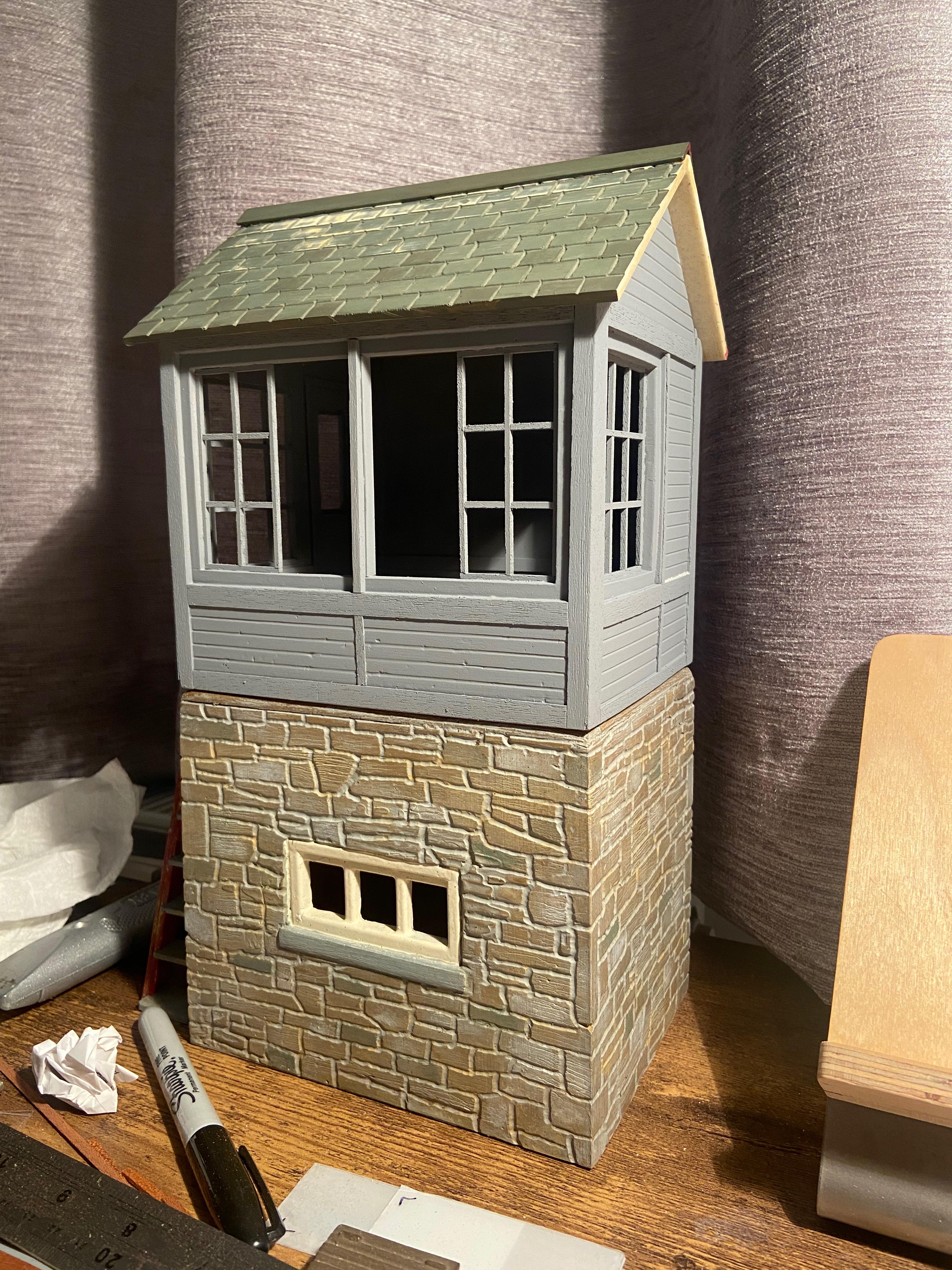

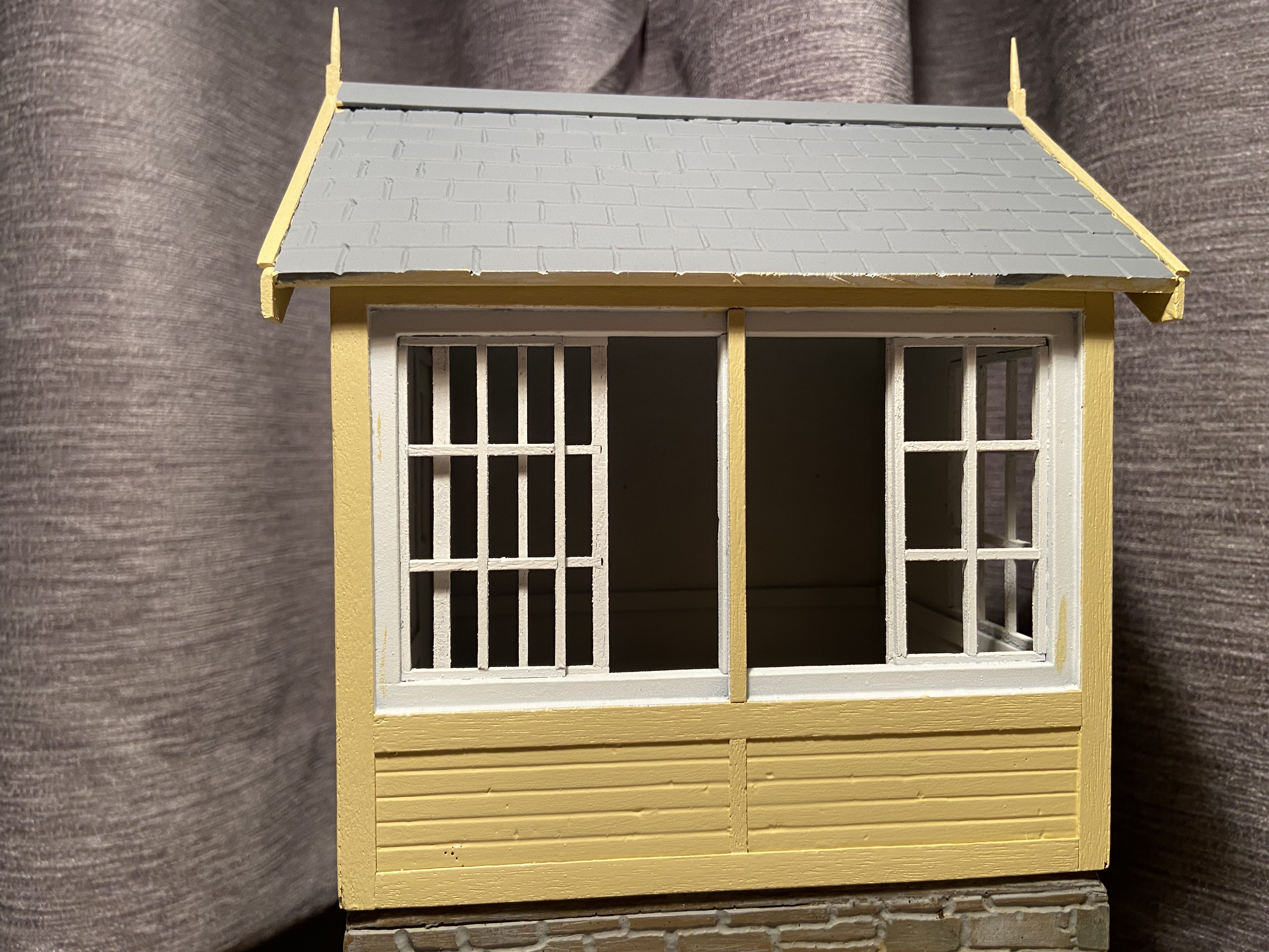

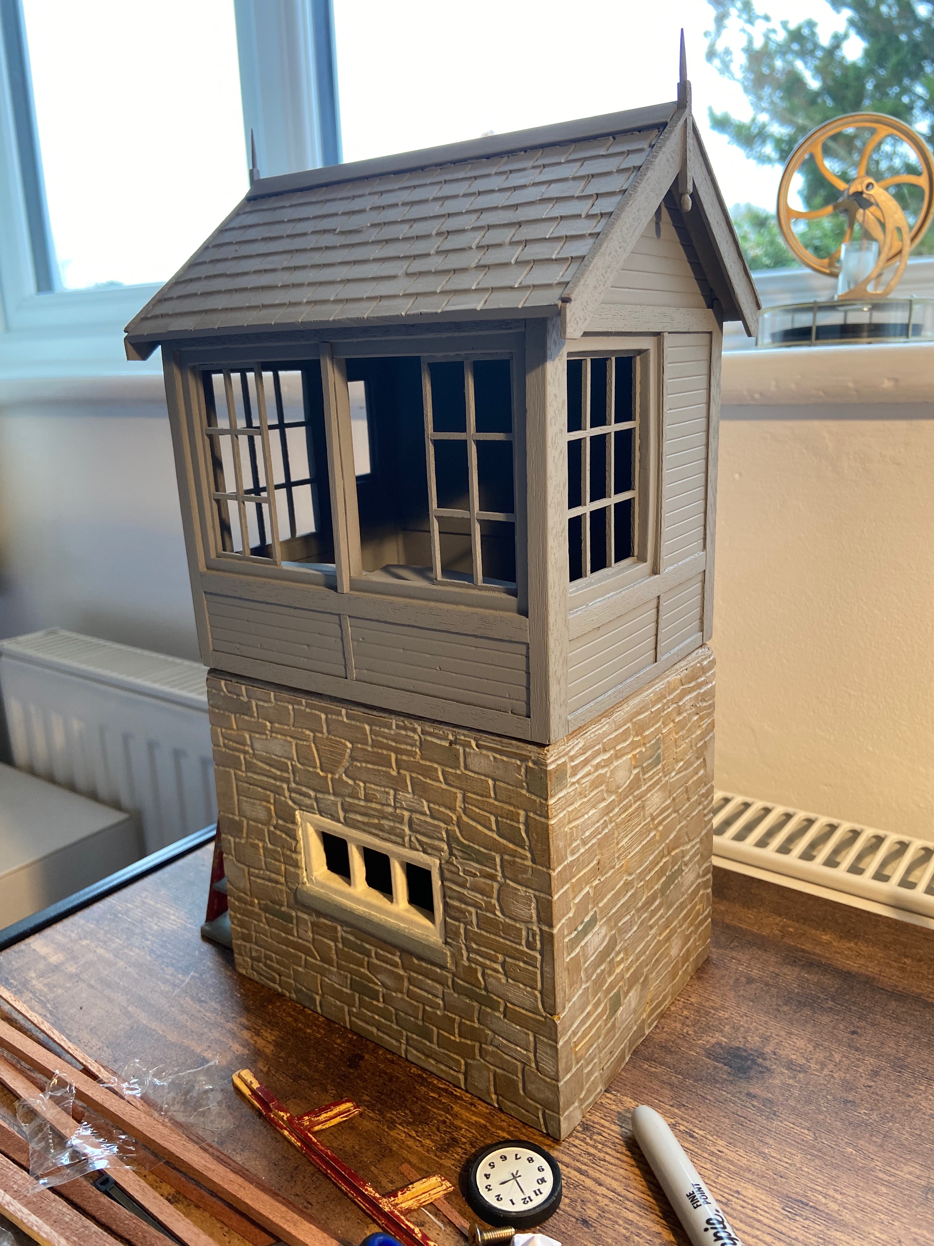

some more photos of the building being trialled on the base:
Windows closed:
Windows open:
I couldn't help but brave the cold and see what it looked like in situ :D
Jobs to do include but are not limited to:
- painting the slate roof
- repainting the door on the base
- giving the windows final coats of white (they're still in the primer)
- adding the steps and replacing the balcony
- do something with the window on the base (Suggestions please! so far all I've done is remove the old frame)
Im not sure how to create a realistic slate effect on the roof so help on that would be appreciated cheers :thumbleft:

Superb job George, it looks so much better then the original and you have thought about the potential problems of winter weather, so should be OK.
I can't offer a 'best way' to complete your model, just do what satisfies you and that is sufficient. You might teach us something new?

For the slates, I'd give it and all ver wash of whatever base colour you want, no need yo worry about streaks if they occure. Then add small amounts of succesively lighter or darker colour to the base paint and pick out a few random tiles with each variation. Then finally, once it is all totally dry, go over the whole lot with a thin wash of very dark, (not quite black ) paint. this will find the tile joints and just even everything to look like years of engine soot.

I find applying the paint (over a good colour base coat) with a sponge gives a good effect, a couple of colours that a similar, and then pick out a couple of slates in these colours.
