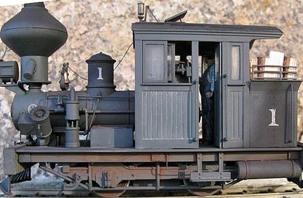

This year rates up there as the worst of my life, but I have finally got some modelling enthusiasm back. So I started looking for a loco to build. I don’t need any more, but having a ‘project’ and a goal will help. So I got started.
I found this pic of a cute little Heisler type geared loco here: https://www.mylargescale.com/threads/m ... ler.90542/
I thought it could be built on a ‘diesel‘ motor block. (I don’t have any spare steam motor blocks but do prefer steam to diesel).
I ‘scaled’ the size of the loco from the sleeper spacing in the pic.

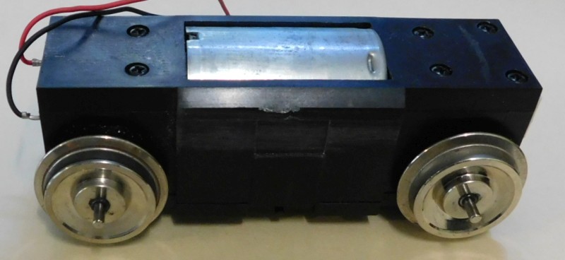

The USA Trains motor block I bought years ago, seems a pretty good fit for wheel dia (28mm) and axle spacing (95mm) and only 40mm high.
As the pic shows, the motor extends above the plastic motor block by about 3mm.
I also had an old boiler discarded from some previous build, which seemed it could fit the bill.
So I started ‘sketching’ by ‘skewing the pic to give a side-on view. Then using Libre Office drawing function in their Writer program to overlay the various bits at scale.
I already have a number of small locos that are 240mm long so I decided to aim for this length again. This gave me the rough dimensions.
to be continued....
to be continued....

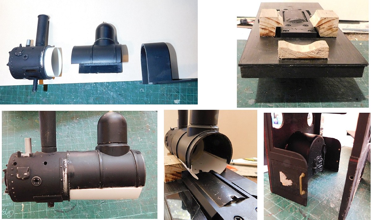

part2

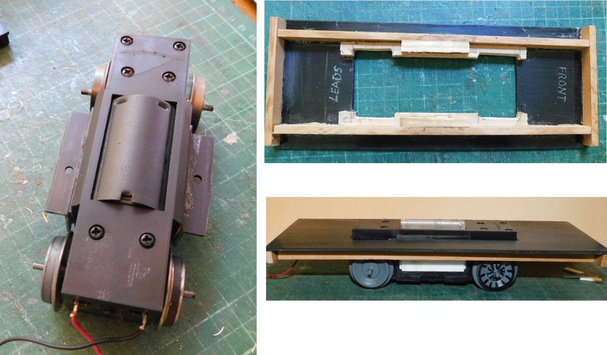

My first attempt put the baseplate on top of the motor block but that looked way too high, so I cut out a hole for the motor and lowered the baseplate by 10mm to be 38mm above rail.
I contact glued some 10x5mm timber under the 2mm styrene baseplate for the ‘frame’ and similarly glued some 10x10mm aluminium angle to the side of the motor block. This allows the base to be screwed (from beneath) to the motor block. Note my painted spokes – more on that brain wave later.

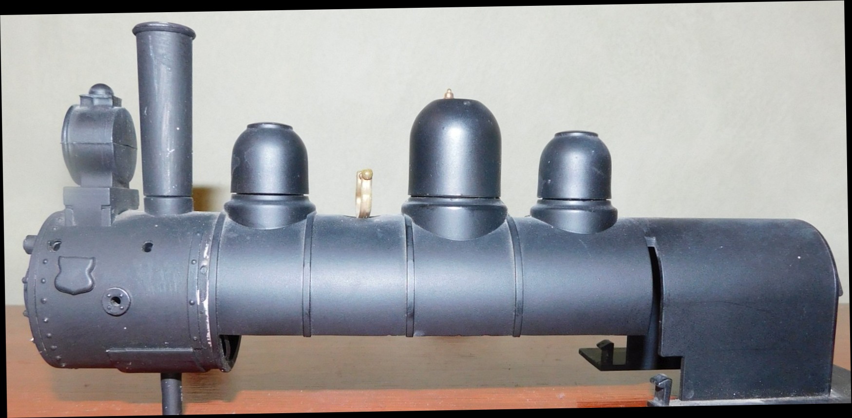

Now I took the old boiler and cut it into 3 parts.(top left pic) By the time I was finished I think it would have been faster to start from scratch.
Because it was from a tank loco, the boiler was only a ‘half cylinder, so I had to fill the underside in. (bottom left)
But the major problem was that it rested on the motor but had to be attached to the baseplate, so I had to figure out how to support the cab end on the baseplate– After 3 attempts I finally used some timber disguised as ‘tool boxes’, which cantilever over the motor block. The boiler will be contact- glued to these. (top right).
The firebox is attached to the cab, not the boiler, so that it lifts off- see later.
Now I started thinking of where everything will fit and how to access to it.
I had two, 18650 LiIon cells lying around (from an old laptop). I tested them in series with the motor block and they gave 30 kph scale speed which I figured was fine for a Heisler. They will go in the boiler along with the Hobbyking 2.4GHz receiver. The bunker then has plenty of space for the ESC (speed controller) and my design of sound circuit and the reversing relay (more on this later). Plus the on/off switch and charging lugs (not shown)

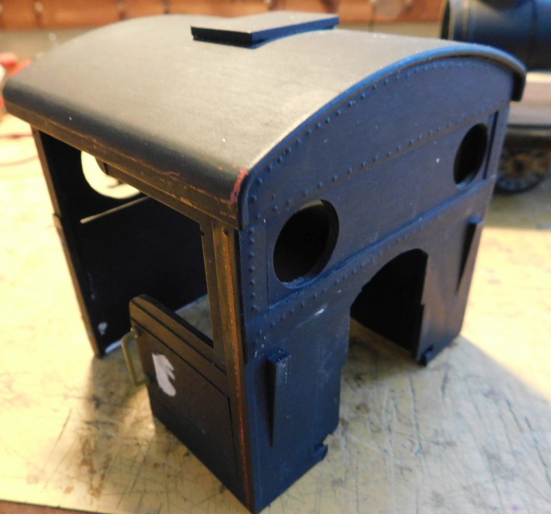

I had a cab from an old Bachmann Porter which was the right size so I used it.
The cab is not attached to the base and just lifts off to allow access to the batteries and Rx in the boiler.
Usually I like porthole windows, but I didn’t think they suited a Heisler, so I squared up the rear ones, but the front ones were too hard to get at for cutting.
Then all I had to do was make the bunker from some 2mm styrene. As usual, I covered the main styrene with 0.5mm styrene with the rivets embossed from behind.

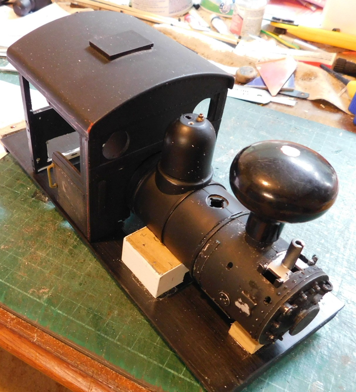

Phil had brilliantly suggested plastic door knobs for the balloon shaped chimney. I went search my junk piles, sure that I had some, but didn’t find any. A search of the big hardware shop’s website turned up nothing. So I decided to turn it from wood. While looking for my hole saw, I found this…
I think it was a ‘handle’ from an old hammer drill. Anyhow, it’s a great start and close enough for size.
Here's the first mockup.
