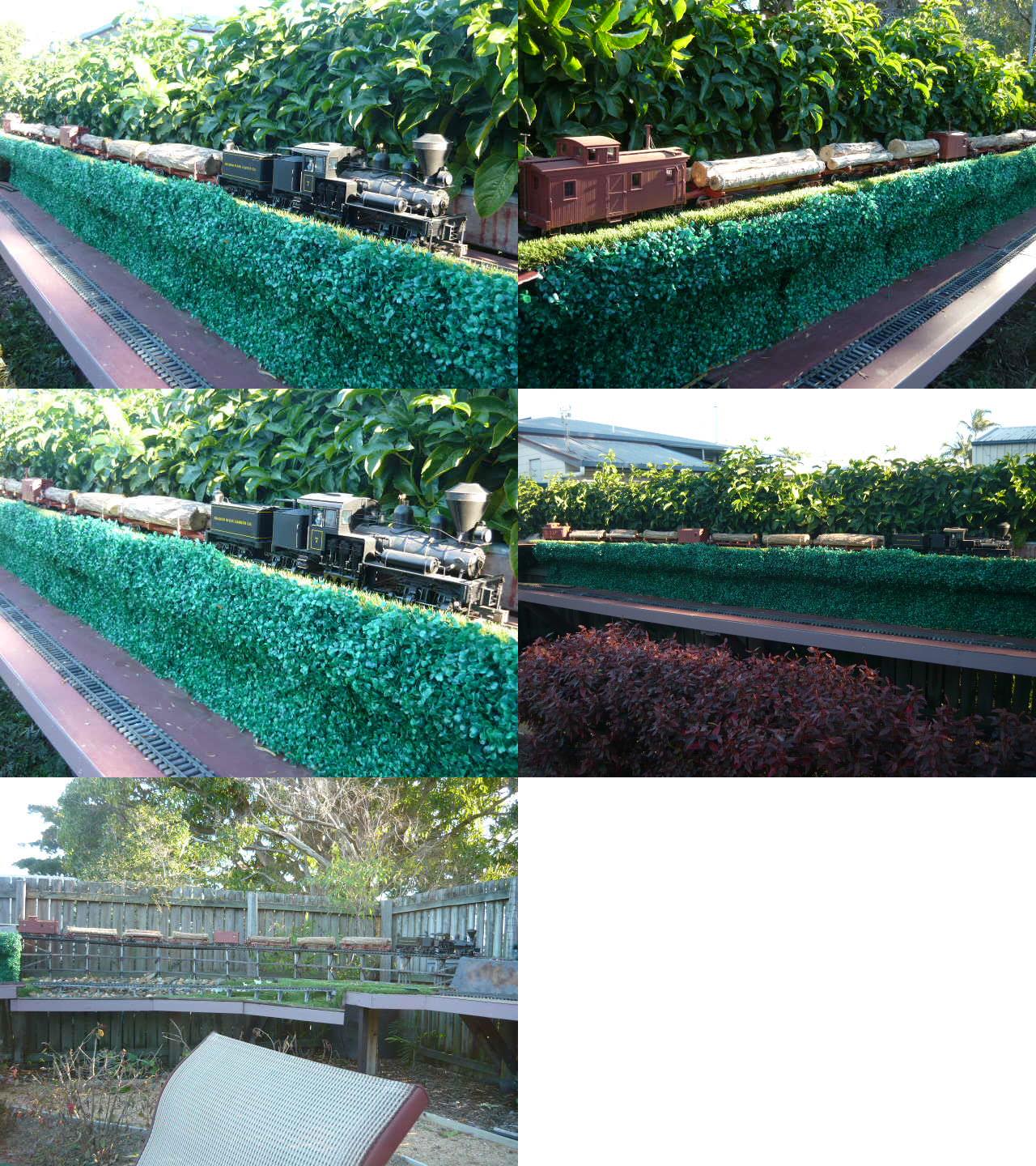

Pictures of yesterday afternoons trundle.
This train is my most favoured a 3 Truck shay pulling loaded log cars, a work and end caboose.

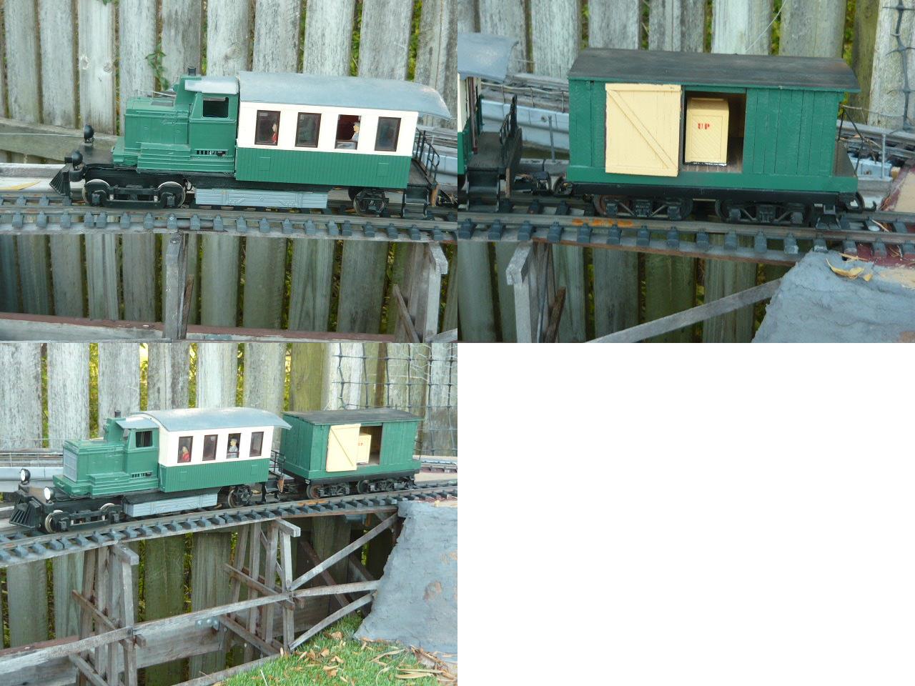

My latest addition to the loco roster.
A railmotor bashed together from an LGB coach, a toy train diesel and wagon, an Aristocraft motor block and "Rogers front end" and lots of styrene.
Motor control is a Syren 10A robotics motor controller (https://www.dimensionengineering.com/products/syren10), sound a MyLocoSound card, a 2.4GHz receiver with 10 NiMH cell to give a nominal 12V battery (in grey box).
The wagon is an Aristocraft tender chassis with a wooden body built on it.
All in all this is made out of bits from the parts bin.

An attractive little model. The first photo threw me initially, I didn't spot it was two photos and couldn't figure out why the van was 1.5 times bigger and why there was a balcony marshalled between the carriage and the van. Then the mists cleared and it all made sense.

Rik,ge_rik wrote: Mon Aug 02, 2021 7:36 am An attractive little model. The first photo threw me initially, I didn't spot it was two photos and couldn't figure out why the van was 1.5 times bigger and why there was a balcony marshalled between the carriage and the van. Then the mists cleared and it all made sense.
Does the ESC regenerative feature actually work on a small model like this do you think? I do like the idea but I'd have thought it would require something with a bit more momentum - or would it be inertia ( he says, dusting off his rusty. A Level physics knowledge)....
PS my spell check prefers "degenerative ......."![]()
The photo is merge of 3 pictures (to keep the count down)
I have no idea whether the regenerative feature works or not.
I only have one of these ESCs, I originally bought it to power my 3 truck Shay (3 motors) but took it out and replace it with a Pololu Simple motor controller which I am pleased with as they also have a Lipo undervoltage cutoff feature. I was moving toward standarising my ESCs with Pololu but now have 2 Mitroniks Viper loco 10 EScs, so much for standardising.
