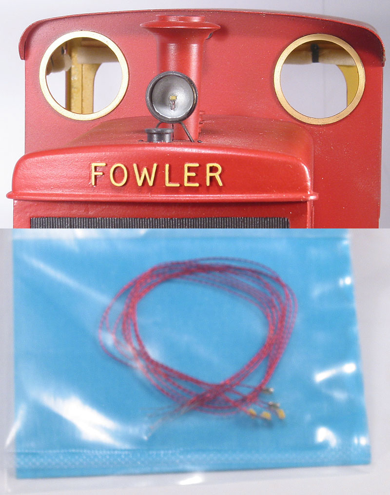

This is the arrangement that I used on my old Motor Mule when I converted it to r/c control. I don't make a habit of running at night, but the headlight reminds me to turn the power off when putting it away. At night it will light up a couple of metres of track, even though the 'reflector' is just silver paint. With a polished aluminium reflector it would probably throw an even longer beam.
The LED is a warm white 0.8mm SMD package. The leads on these are magnet wire, for use in HO models, but basically they are invisible under a coat of paint in large scale. These came from a local supplier here in Oz, but I've no idea if they are still available.
If you look carefully at the loco headlight you can just see the leads running vertically down into the motor cover, simulating the conduit on a real loco. The holes for the leads are 1mm dia. and the leads support the SMD LED at about the focus point of the 'reflector' in the headlight. A small drop of canopy glue keeps them there.
