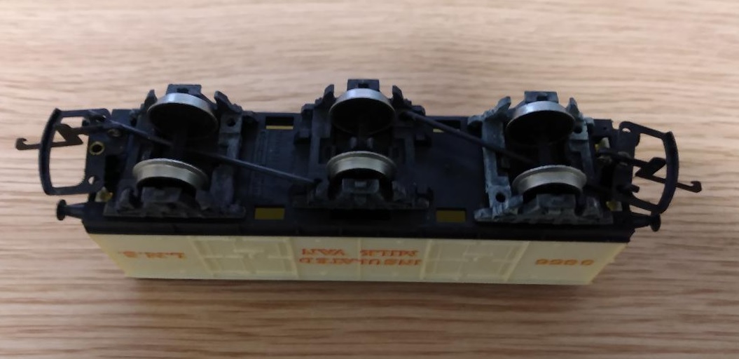

Incidentally, for those interested in such things, here's how Hornby solved the "six wheels and tight corners" issue back in the 80s:
It's quite ingenious, the centre truck floats freely within the guides (there's quite a lot of vertical play) and is attached to the couplings, which are themselves pivoted so that they also follow the curve.

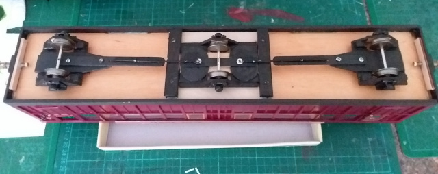

Hi All.
This is my home built NWNG railway Cleminson carriage. My difficulty was also trying to keep the centre truck on the track. I initially made it with a flexible coupling of rigid arms connecting the centre truck to the end trucks similar to the system below as used by DLT. On RM Web(His photo). This however did not allow enough flexibility for the lines I run it on. The problem was, as said, on reverse curves where a parallel siding left the main line for instance. When the first truck was turning onto the curve of the turnout the middle and rear truck were still on the strait track, but because of the front truck turning it was forcing the middle truck sideways which made it leave the rails. I then had to redesign my model with a more flexible system as shown below. I used a length of thin plastic coated steel wire to connect the centre truck to each end truck. It is screwed to the centre truck and passes through a hoop about half way along the end truck arm giving about 4cm of unsupported wire either side of the centre truck. This allows one end truck to turn while, due to the flexibility of the wire, the centre truck can still be on strait track. In the extreme case, while one end truck is on the siding and the other end truck is on the parallel main line, the centre truck can be going round the curve of the turnout.
I also allowed plenty of vertical movement in the centre truck guides to allow for the length of the carriage on uneven track.
David.

That looks ingenious, David.
I'm still fiddling with my system. I've now given the centre truck a lot more downward movement to cope with the deepest dip on my trackwork which also happens to coincide with a curve and a point. I'm finding the outside wheel now sometimes lifts up off the track. I've piled more lead on to the truck but that's not cured it. The next job is to get the PW gang to sort out the track!
All good fun. I'm going to stick with it!

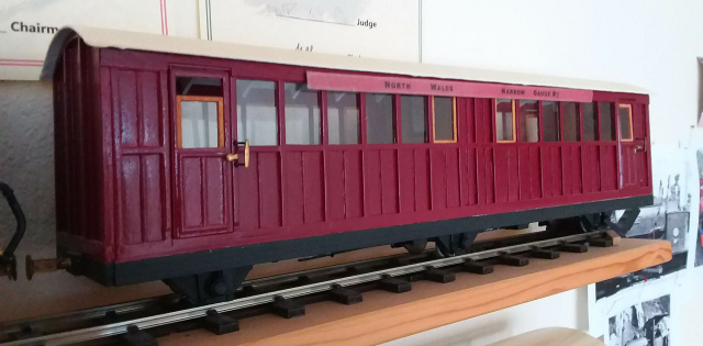

Well, it's taken a while but my second Southwold Cleminson coach has just entered service. This seems to have taken longer than the first to construct, maybe because I've been tweaking its design in the light of experience with the first. I think I've got the 6-wheel chassis sorted out but I've not yet had a chance to run both coaches together in a full session - fingers crossed!
Coach number three is about to be printed. It'll take a while as there are quite a few large bits to be done....
