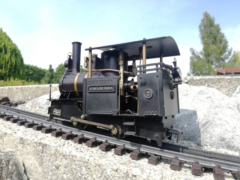

The builder of the Z1-Z3 models was the first to build a Z13 and used an LGB Plastic gear, and a cylinder unit from Regner a two-cylinder oscillating
Because I just mentioned a two-cylinder Ozi from the Lumberjack:
https://gbheinz.hpage.com/schraegerfriedl.html
So there are some things to be concerned about with cogwheel locomotives, also that a longer track on a (model) mountain quickly ends at a height that can only be reached with a ladder.
