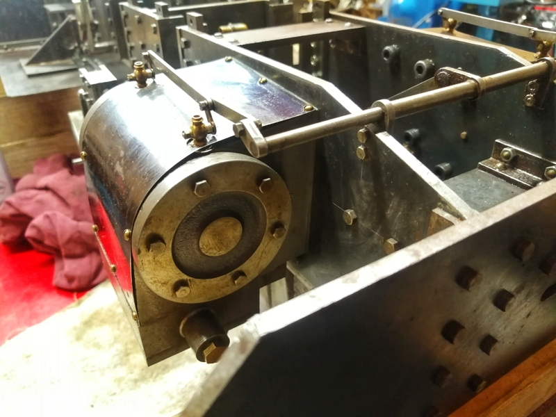

I agree. The covers are interchangeable with both cylinders (I know this because each cover + cylinder is stamped with the numbers one and two for identification and when I received the loco the covers were on opposite cylinders and bolted upside down). Either that or the original builder was very diligent (the chassis has been made with care as the loco can run just under 10 PSI on my rolling road).GTB wrote: Tue May 12, 2020 1:24 pm The valve chest covers on your loco must be high quality castings. Some grey iron castings I've encountered have have a hard skin that can take the edge off a HSS cutter very quickly when taking a light cut.
My engineering friend did mention this, however, I assumed as the seller had confirmed the part was sized incorrectly that it was wrong as I did message them explaining what I was trying to achieve.GTB wrote: Tue May 12, 2020 1:24 pm That probably was a 4BA counterbore. The pilot of a counterbore is designed to fit the clearance hole for a given fastener, not a threaded one. That's why it seemed to be oversize. That's how it works with metric ones, so I assume BA ones were the same.
I was very concerned about damaging the covers so this is why I turned it by hand. I only thought to do this as previously I had tapped the holes turning the chuck by hand, experience paid off here!GTB wrote: Tue May 12, 2020 1:24 pm I think you dodged a bullet by deciding to turn the cutter by hand.

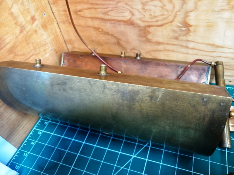

Re: 5" gauge 0-6-0 Sweet Pea

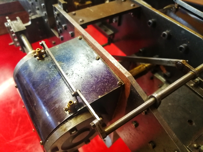

Air test of the modified steam chest covers, no leaks on air!

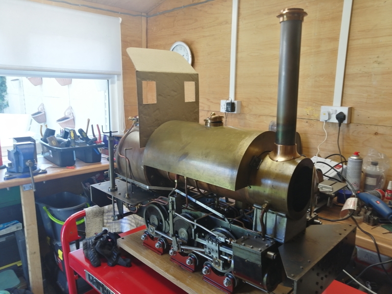

These were some open cab ideas I had (purely chosen as they would be easier to make) before I decided I wanted a Kerr Stuart Wren style closed cab which I think will suit the loco given the size of the new chimney:
Reshaping the raised section still didn't look right to me (this part was intended for the whistle to be mounted to it):
This design was based on the 5" gauge 'Titch' cab but again it just didn't look right to me:
To go with the intended Wren style cab I have also decided I want a square saddle tank (this will have the benefit of storing more water than the current saddle tank):

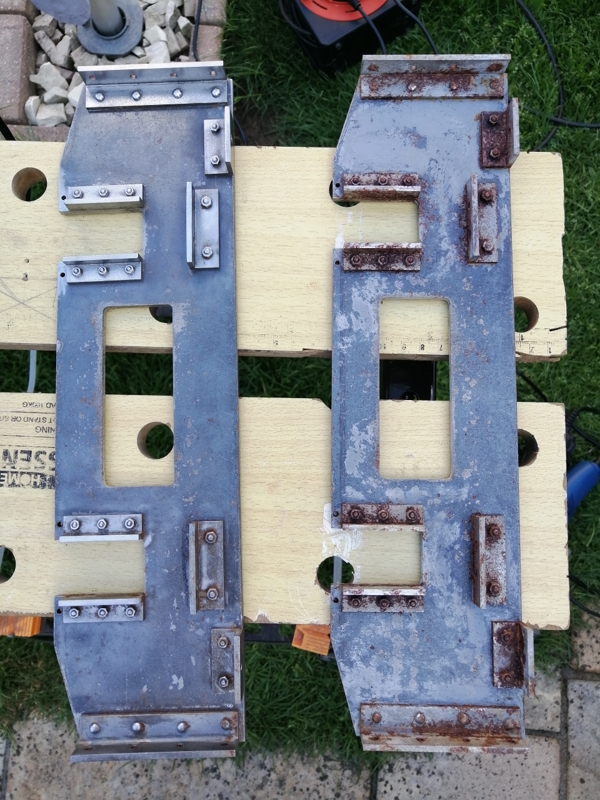

Cleaning the surface rust covered tender chassis for painting using steel wire and flap wheel attachments in my die grinder:
Assembled and painted (I had to replace some of the steel bolts as they had snapped when being removed due to rust):
Practicing preparing and painting the tender chassis has taught me that despite leaving the paint to harden off for over a week it is easily scuffed so I will not use acrylic based paint on the loco as it is not durable enough.

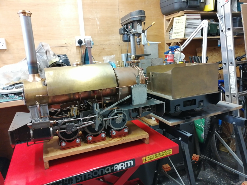

I don't plan to use the tender but here is what it looks like when paired with the loco:

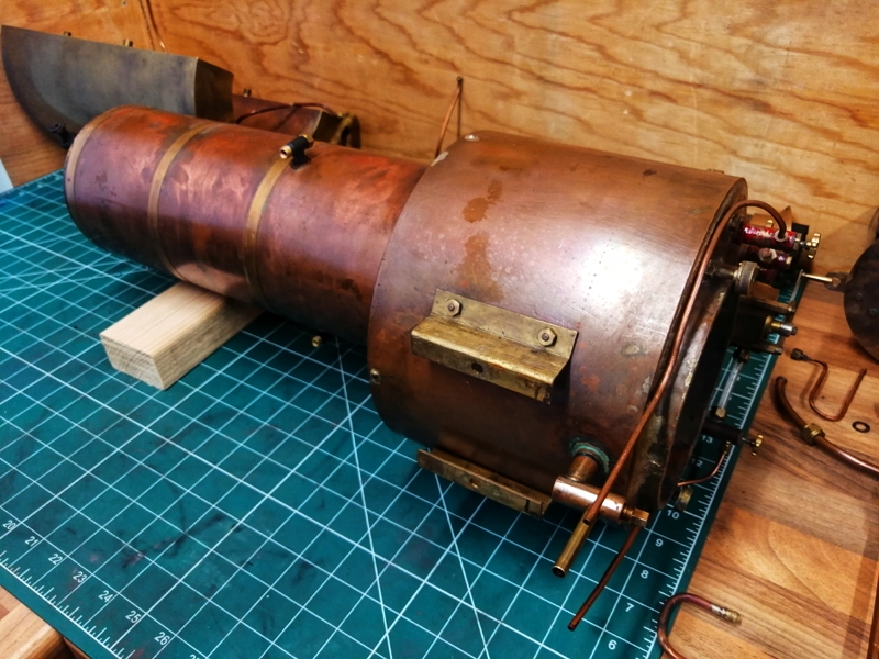

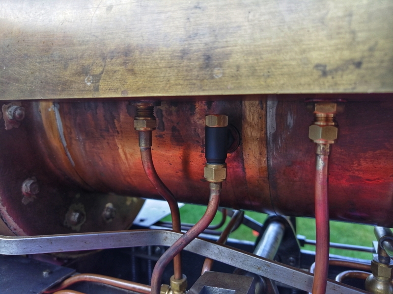

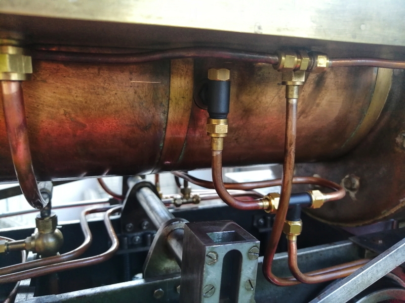

I fitted new commercial clack valves to the boiler back in August after one of them kept sticking open (after the last failed steaming I discovered that the ball valve in one of them had been sucked into the boiler). When I took apart the other valve I discovered the builder had fitted nitrile balls rather than stainless steel. There are various debates over recommended types of balls used in valves, however, I decided I wanted stainless steel.
Here are the new valves fitted:
I tested them soon after and had the engine in steam for a hour in the garden with the axle pump and injector taking turns filling the boiler with water (they use separate clack valves so this gave each one a proper test to prove they would be reliable).

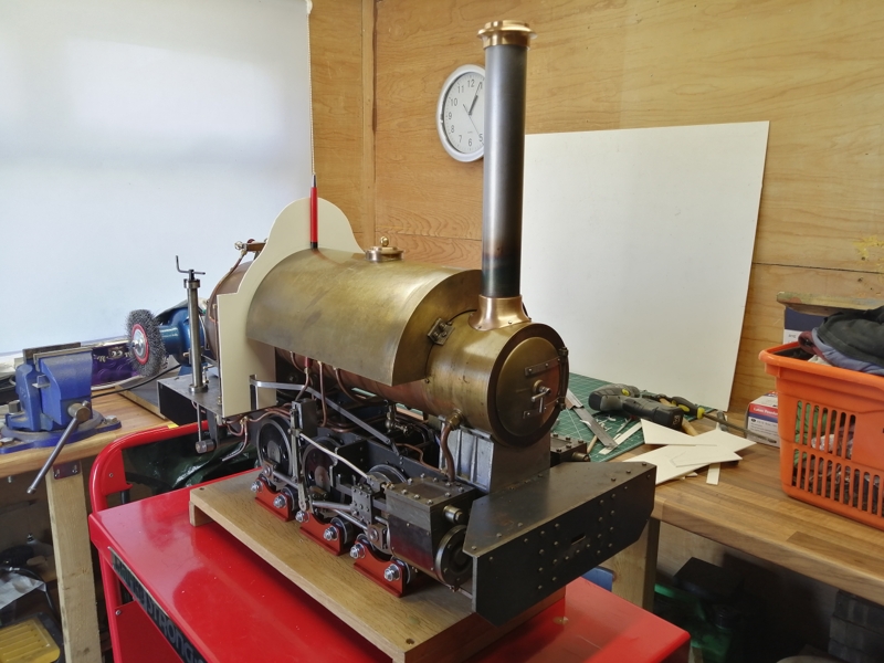

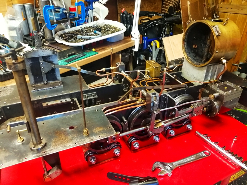

Painting is not something I enjoy and I admit I have been putting this off, however, with Nomis posting about his 7 1/4" gauge Wren 'Jynn' build and how he went about painting her it gave me a push to try hand painting my engine instead of using rattle cans (I like the idea of having to do little prep work and painting inside a warm workshop).

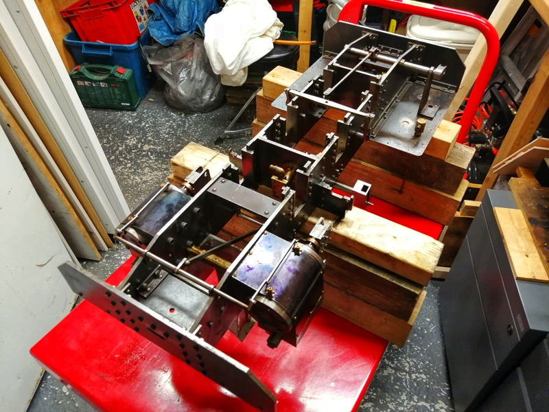

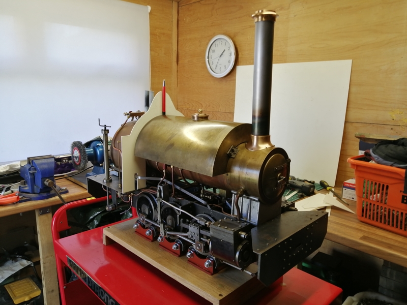

So to begin, I had to disconnect all the various pipe work and remove the saddle tank and boiler:
Which left me with this:
A view of the majority of the pipework (that horrible bend to the left side of the picture on the water pipe for the hand pump/axle pump was my first attempt before I bought some fire bricks and learnt to anneal pipes properly, I am going to redo before putting the loco back together):
Smokebox removed and deciding what needs to be taken apart next (notice the orange stuff around the cylinders):
Closer inspection revealed it was gasket sealant, however, the cylinders are already fitted with thick gaskets to reduce heat loss into the chassis so I guess the use of sealant was just a belt and braces approach:

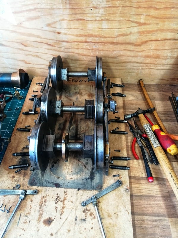

Scraping it off was not getting me anywhere and I didn't want to remove the cylinders so I read that paint stripper works well if left on for a while and sure enough it faked off very easily, result!

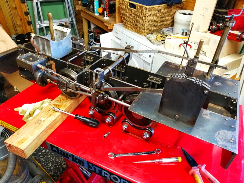

I managed to remove all the wheels and motion complete which was another result (notice I have written 'FRONT' on the piece of wood, I just need to remember that I removed this with the chassis upside down!)
And here we are ready for cleaning and painting:
I was able to do all the man handling of the chassis on my own as without the boiler it is just about manageable (the hydraulic lifting table earning its keep here!)

Interesting that the nitrile ball got sucked in towards the boiler...
I have tried to get into the habit of opening all steam valves slightly after blowing down - mostly to stop them from jamming as the cool - but it also stops a vacuum forming in the boiler.

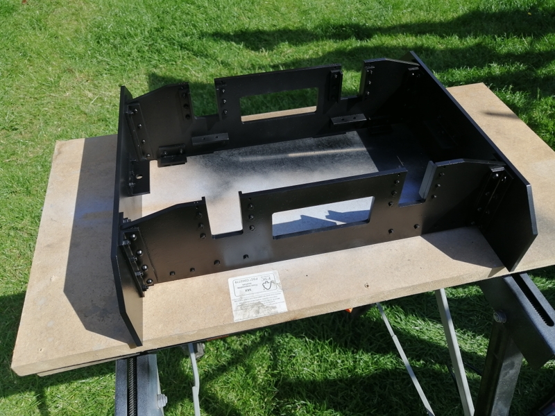

I have followed the same ritual since owning the loco and leave all valves open when not in use.Nomis wrote: Thu Oct 01, 2020 11:30 am I have tried to get into the habit of opening all steam valves slightly after blowing down - mostly to stop them from jamming as the cool - but it also stops a vacuum forming in the boiler.
Degreasing wise, I am going to use Isopropanol (because I have some) but given it's highly flammable I am waiting for a day one weekend when it is not raining so I can take the chassis outside to clean. I have a cleaning gun for my air compressor so I might give that a go or just use a cloth and then air clean the chassis afterwards.
My issue now is what colours to choose. There is a huge choice of RAL colours on offer. As I want the loco to have a used look I was thinking RAL9004 signal black for the frames and RAL3020 buffer beam red for the buffer beams? (satin paint):
