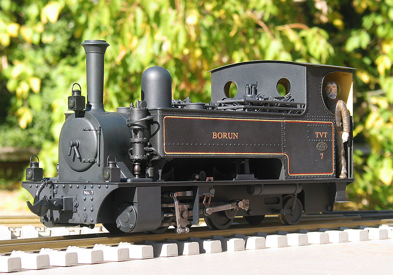

A couple of weeks ago I decided it was time to do something about it and a new boiler was built with the bush for the dome in the right place.
Fabricating the bits for a gas fired boiler and silver brazing it together only takes a couple of days and the first photo shows the new boiler getting it's hydraulic test. As is often the case, a joint of a test fitting leaked, but the boiler shell itself was leak free. A new fibre washer and the boiler passed the test by holding pressure for the required time.
While the loco was in pieces for the new boiler to be fitted, the opportunity was taken to sort out a couple of other issues that were also bugging me and then the new parts went through the paint shop before final assembly.
The next couple of photos show the final result sitting in the afternoon sun on the track a couple of days ago.

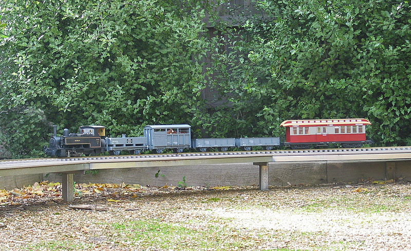

The branch line mixed finally left on it's run behind the timber co's. Hunslet, seen here heading north and running very late.

By the time I'd made up an adaptor to fit the Accucraft safety valve to a Roundhouse size threaded bush, it was too late to try again, so the test run was postponed to the next morning. Predictably the sun was out as I set out the train and started to steam the loco, but by the time the pressure had built up the sun had disappeared. The next photo shows the branchline mixed running north in the gloom of a Melbourne autumn. The new safety valve worked well and the new boiler steamed well, you have to win one now and again........

Looks great Graeme! one thing that particularly caught my eye is that air compressor, it looks superb, did you build it yourself or is it an off the shelf item?
Posts: 1721
Re: TVT - Borun the Pelican, take 2.
Post by GTB » Fri May 15, 2020 3:58 pm
Tropic Blunder wrote: Fri May 15, 2020 8:44 am one thing that particularly caught my eye is that air compressor, it looks superb, did you build it yourself or is it an off the shelf item?
I scratch build my air pumps, along with loco lamps and jacks, as I couldn't find a suitable commercial part. The model is based on the small Westinghouse Aust. C class pump, which was an 8" type fitted to the NA class before preservation. These days the NAs are fitted with larger 10" D class pumps from BG locos.
