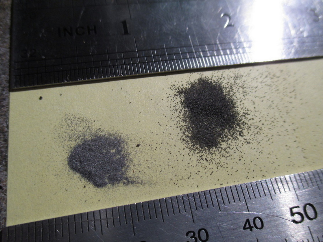

Anyways, the iron powder arrived today. On the left is the old powder, new to right. Far too coarse for me, unfortunately. Resembles very fine sand.
After a hit with the vinegar. Used too much vinegar, causing the fine stuff to clump a bit.
I really need more of the old dusty consistency, as it allows one to "streak" the iron and blend it with the surrounding area, as if using weathering powders. I'll hang onto this new stuff, it should be fine for representing those reallycrusty, "slabs of rust dropping off" things. I just ordered another, different packet from a supplier in Pommyland, and will report back here again when it eventually arrives..

I'm a bit late, but the second packet of iron powder, from the other supplier, arrived last week. It's the same dusty consistency as my old dwindling packet as seen at top left of my last reply.
Here'sthe stuff. They also sell it in 500g and 1kg packets.
