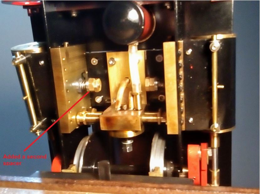

On the previous run when starting on the grade a large steam leak was found at the port faces, so I stiffened-up the trunnion springs using spacers, and this appears to have done the trick.
