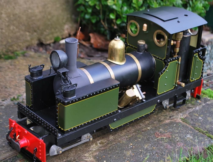

In answer to your question have you a copy of Peter Angus's book? He devotes a whole section to the Avonside Heisler, about 14 pages. The latter ones used the Stour Valley Steam 'boxer' motor. Sadly, the original SVS motors are now unavailable, however Tony Green Models are making the same motor which I have been using recently in my models.
Having been a huge fan of Peter Angus models for many years (we own a Double Fairlie shown in the book) about 20 years or so ago I also decided to build an oscillator Heisler which can be seen operating here - https://www.youtube.com/watch?v=6vVq-2OtqD4 (Hope the link works)
Originally it started life as a battery loco (due to my limited steam knowledge at the time) but I built a new chassis with boiler and motors and converted it to steam by transferring the bodywork over. It appeared in Gardenrail number 88 if you can obtain a copy. I'm sure I still have the original drawings here somewhere.
I kept the model for about 15 years having named it after my father, however after a facelift I decided to sell it and it now resides in France. My main interest switched to Garratt's and I ended up selling many of my models to finance the new locomotives.
If I can be of further assistance please let me know.
Malcolm

Hi Malcolm, and welcome to the forum.
Wow! what a beauty that Heisler is, and running like a Swiss watch too. I'm also a fan of those particular Heislers, both two and four cylinder ones.

Hi Malcolm and thanks for posting!
I don't have a copy of the Peter Angus book, I had no idea that it even existed (quite a new hobby for me) and happy to say it's now on order.
Thank you for the link to your stunning engine in action, I had seen pictures of it but hadn't seen the video and I'm now hunting for a copy to read the Gardenrail article.
I would really appreciate your help Malcolm, any drawings on these engines, and info on your own would be great. I have so many questions! Also, cracking line you have there!

Hi Tom,
Hope your back is getting better. I sympathise as my mother suffered back problems on and off for many years. At times it was very debilitating.
I'm glad you have ordered the Peter Angus book. It's full of information both full size and 16mm model form and the section on Avonside Heislers is very detailed and may provide all of the information you need to make one. I regard it as a 'bible' and a must for anyone wishing to build their own models.
I would suggest you go the route (as he did) of fitting a steam motor in the middle of the chassis and driving the bogies by means of cardan shafts and crossed helical gears. Suitable motors can be obtained from Tony Green Steam Models. (Speak to Eain Green) You need the 'boxer' motor which is shorter than the 'long' motor. Sounds obvious I know but this ensures the drive shafts are as near to the centre of the loco as possible. This could all be hidden beneath the chassis and dummy cylinders mounted above possibly made from 22mm domestic copper tubing, brass end caps and rivets.
Alternatively, you may choose the route I did of using 'wagglers'. (Mamod type cylinders) I'll try to upload one of the drawings I sent to Gardenrail. Basically, it consists of a 1/8" thick plate cut to shape which is soldered between the chassis side frames. The cylinders are mounted at 45 degrees each side. (90 to each other) The plate contains all of the drillings necessary to mount the cylinders and the gearbox. The gearbox is made up of a rectangular plate (shown dotted) which has 3 drillings for the gears (2 off 30 tooth 64DP and 1 off 60 tooth 64DP) and 3 holes for spacers. I drilled mine accurately on a milling machine. My original was plumbed up to go forward only as I lacked the knowledge at the time to fit reverse. However, by using a rotary valve mounted in the cab it is possible to arrange forward / reverse as I have since achieved in another model.
I originally used a standard Roundhouse boiler (Billy or Katie), smokebox, burner and gas tank. The gears were 64DP spur gears obtainable from any gear manufacturer. The crossed helical gears are supplied by HPC. Wheels, cranks, connecting rods etc are Essel Engineering. Universal couplings - Originally I made my own from KS brass tubing but I now use Meccano metal ones. Cylinders RWM steam who also supply the rotary valve. Peter Angus's book explains how to make the cardan shafts and how to make the bogies.
I've tried to upload the drawing but it's too big! I'll have to ask my son to do it as I'm a bit of a 'numpty' when it comes to computer technology. Give me a hacksaw, a hammer or a spanner any day!
I'm still looking for the remainder of the drawings, I think I had a spare copy of Gardenrail number 88! I'll also try to upload a couple of pictures. I'll gladly supply any information or help I can as and when you decide how you wish to progress.
Oh, by the way, I have no connections with any of the above manufacturers just a satisfied customer...

Details of said locomotive: Cross sectional drawing of steam motorMMorg wrote: Sat Nov 16, 2019 8:07 pm Hi Tom,
The locomotive as originally built After Berry Hill Works repaint
