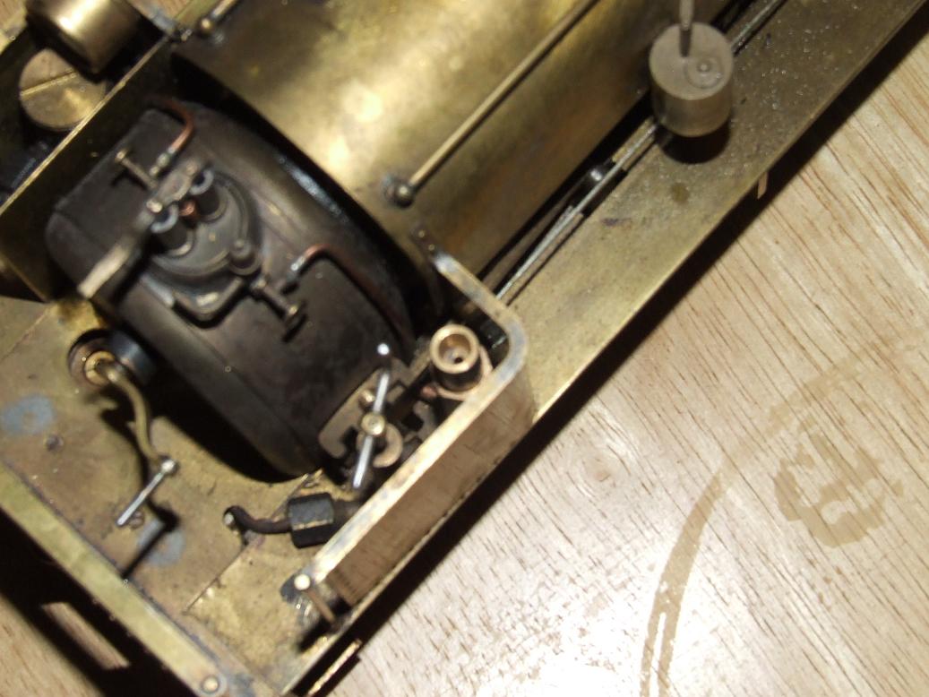

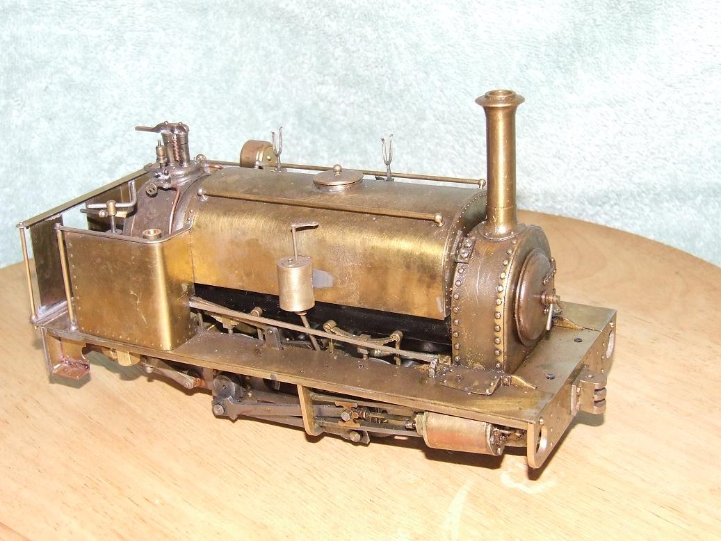

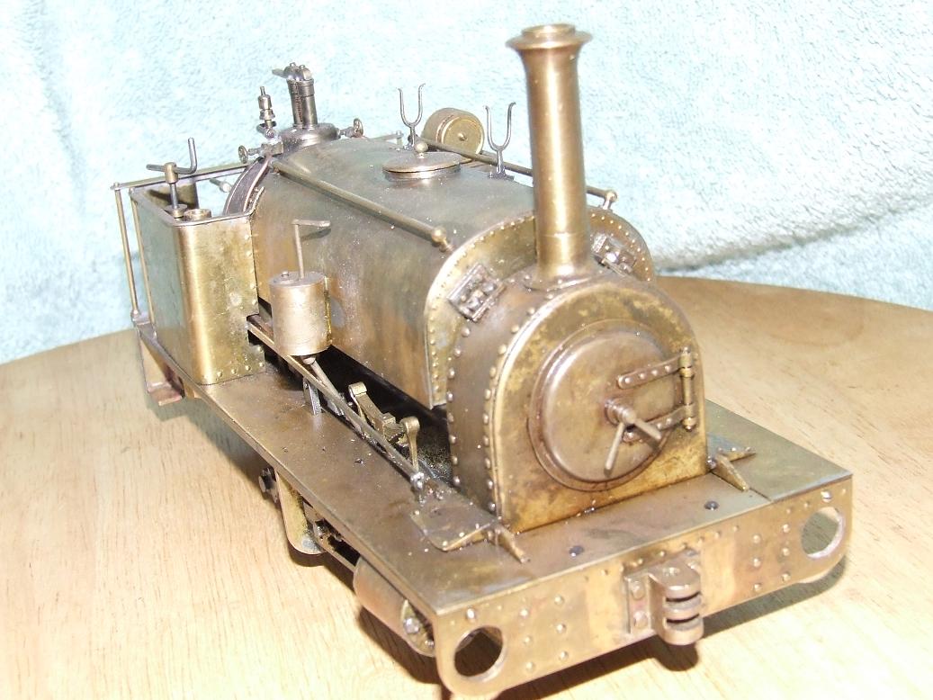

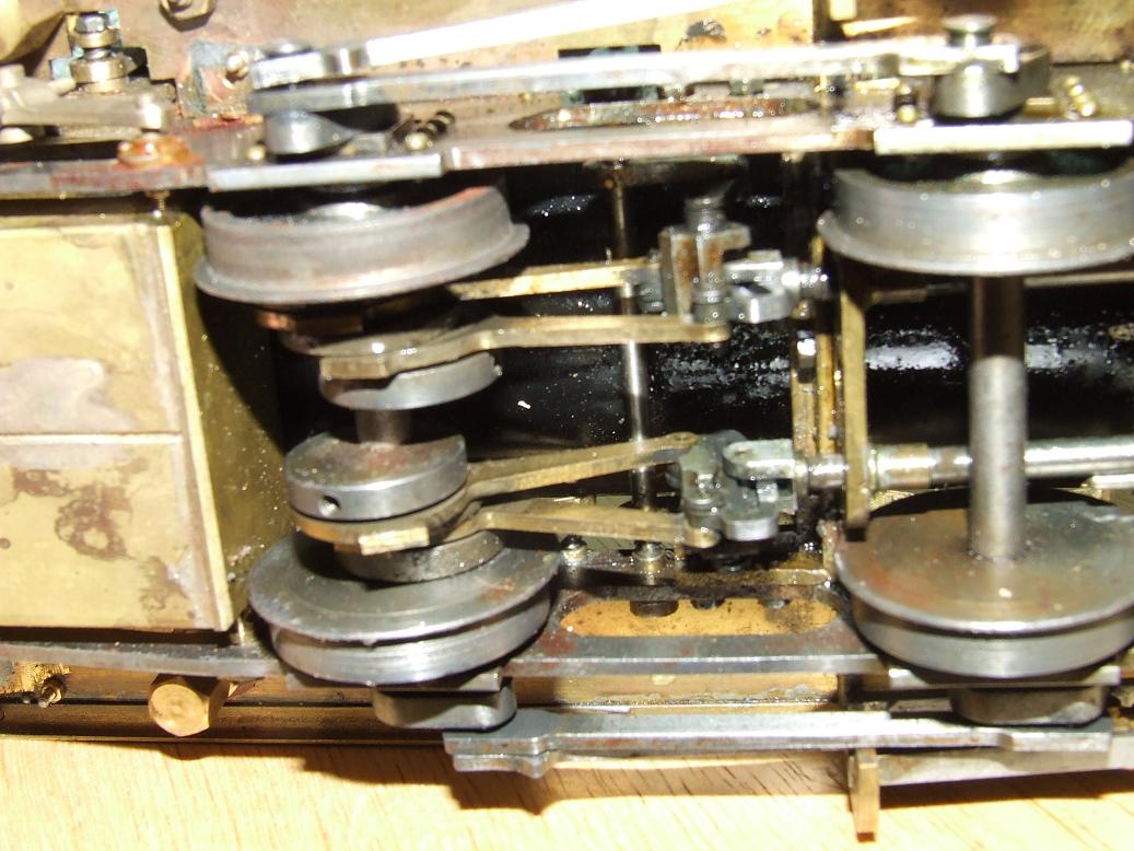

Hi, I was interested to see the article about the Hunslets I built years ago. I had forgotten all about sending anything to Garden Rail. Nearly 30 years on I am still building Hunslets, but not normally with full inside valve gear. About 3 years ago I discovered some castings I had kept and combined these with a new set of laser cut parts to build a cabless Hunslet Alice class for myself. The batches that I build use laser cut frames/rods/ buffer beams/ etc. A problem of doing this commercially is when your sub-contractor goes into liquidation. So for a third time the receiver did not return my laser cutting files to me. THis time although I had the files I could no longer open them! So the " myself project" had to wait until I had redrawn them all from stratch. What a waste of time!
The photo shows the loco in a early period with the sandpots disconnected. The models I make are to 16mm scale with as few compromises as possible. They look delicate but they are not. I aspire to a model that holds up beside a photo of the real thing.
This model has several improvemets on the earlier version. Most importantly is the gas tank. It is three times the volume of the original giving a duration of over 30 minutes. Also no chassis space has been lost with an enots valve. The water fill valve is now on the footplate in front of the reverser. If you look at the photos below you will see this and the way I save space with the eccentric pairs. Forward of the motion plate each valve rod carries a block though which the valve rod on a different centre passes.
All that remains to do is detail the backhead. Easy to do after being lucky enough to get to Statfold Barn. Then wash it, take it apart, ultrasonic clean everything, prime and paint it. So it should be finished in a year or two. Again a problem of making these things commercially is finding time for oneself!

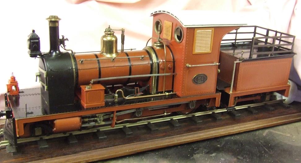

A true jewel of a model... (Photo by Kes Jones)workwright wrote: Sat Mar 16, 2019 11:39 am... Have you ever seen the work of Dave Shotter? His 16mm scale 3 1/2 ton Decauville type 1 tank was minute and beautiful in all respects - probably one one the finest models of a loco ever built, It ran for 30 minutes pulling 20 loaded skips at walking pace.

workwright
Re: "Garden Rail" 1994 Ross Harrison's 16mm Hunslet (Lilla)
Hi, thank you for your generous reply to my post. You are building for yourself, from your techniques used you are more than up to the challenge of springing. On those grounds alone I suggest you do at least use three point suspension, if not coil springing. If you do use coil springs to get the greatest chance of success place the springs partially into the axlebox. I would also suggest the use of ball races in the boxes. The springs will need experimentation. They are going to be a little over 6-8mm long and have an OD of round about 4mm. ( Make from piano wire and wind under tension round a 3mm former) They will seem stiff and probably push the box down on the hornstay. But do not panic until the loco is finished and there is water in the boiler. You won't be able to really be sure you have things right, rIght is a loco with the boxes about 1mm above the hornstay and when you push it over say a 1mm bump in the trank that box goes up without displacing the loco. You will now realise why springing is for the builder a bit tedious. The same result is much faster to achieve with an equalising beam. Either approach though is worth the effort. The model is no longer a toy, it will, given its mass glide through points and if the wheels are coned (2') not shuffle through curves. I have attached a photo of one of MY locos. THis is fully coil sprung, the bogie equalised and with prototypical sprung side control. The 4 wheel tender is equalised. It took about a year to make when I just made locos for friends and self. The one, a Beira Raiway Falcon 4-4-0 has all the non commercial gismos. A working crosshead water pump with bypass. Mechanical lubricator and silent gas fired grate with a locomotive boiler - superheaterer- DIsc regulator. The boiler also converts to solid fuel! No clock ticking on this one.

Please share more more pics of this loco and or point me in the direction where I can admire.
Marvelous.workwright wrote: Thu Mar 21, 2019 4:18 pm The one, a Beira Raiway Falcon 4-4-0 has all the non commercial gismos. A working crosshead water pump with bypass. Mechanical lubricator and silent gas fired grate with a locomotive boiler - superheaterer- DIsc regulator. The boiler also converts to solid fuel! No clock ticking on this one.beira side.jpg

workwright
Hi, thank you all again for the generous comments. I do still build things for myself from time to time. It is only with constant challenge that the old grey matter does not cool down and set like forgotten porage! Quickly as I am baking the top coat on a batch of Wren locos as I write. Springs- sitting in slot drilled pockets inside the axle box, bearing on a pad just above the hornblock. centred on the frame centre line. Side cheeks of axlebox slightly radiused to allow slight tipping.
Bagnall safety valve, the loco above started out with "working" Salter- dismal failure- leaked, could not find a cosmetic solution that worked for the valves springs. So an ordinary safety valve is hidden in its place within the dome, springs just cosmetic.
Cab safety valves. I have a set in front of me when I fire a 1/3 scale Hunslet. It always makes me jump when they pop open, steam every where and the glasses totally misted up. Most sensible locos have some form of collector for the steam. At its simplest a couple of pipes over the valves and through the roof. Bagnall I think tended to shroud the valves it a nice to look at (hard to make) Brass dome evolving into a brass tube through the roof. Most narrow gauge locos I have seen (apart from Alice Class Hunslets) end up with a pipe or pipes dropped over. You need to go and find a similar loco to photograph. That is the only way if drawings do not have the answer. Where to go? My opinion is the best collection and inspiration is to be found at Statfold Barn on an open day.
