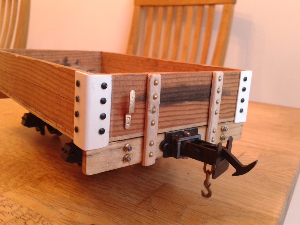

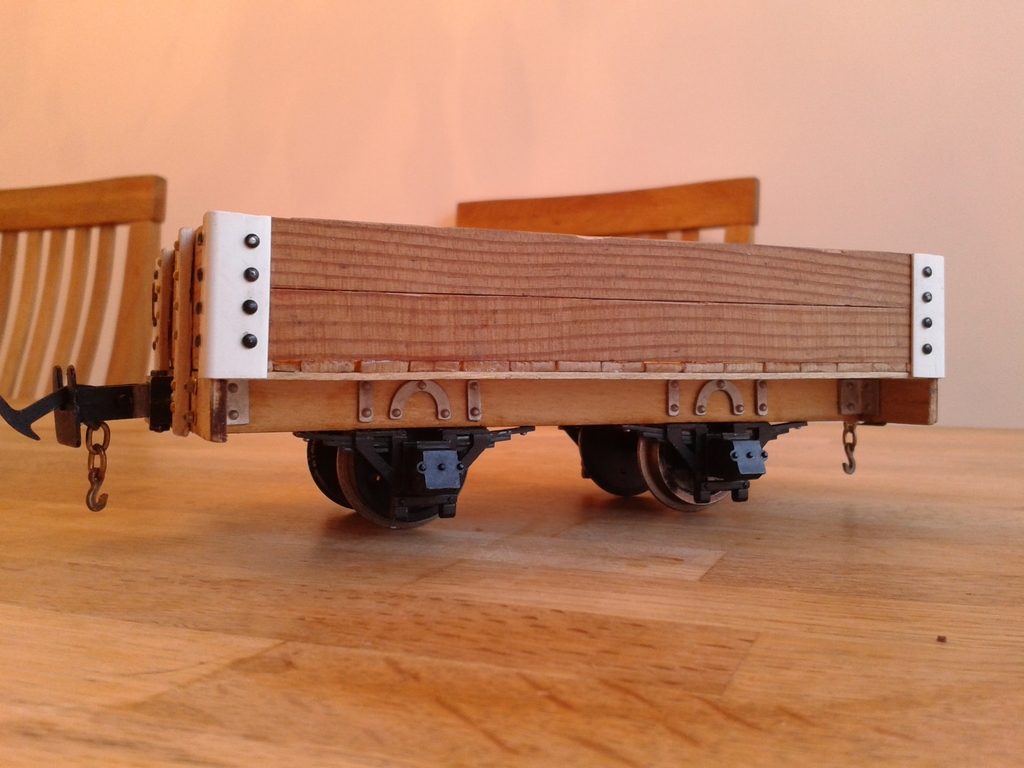

I think I am about done with this wagon. I wanted to fit a hand brake, however, the axle boxes stick out too far and catch the arm on the brake lever:
Colour wise, going to go for all black weathered look and add PW markings as it looks good carrying track ballast.
I will be using Plastikard more on my future projects, great stuff!

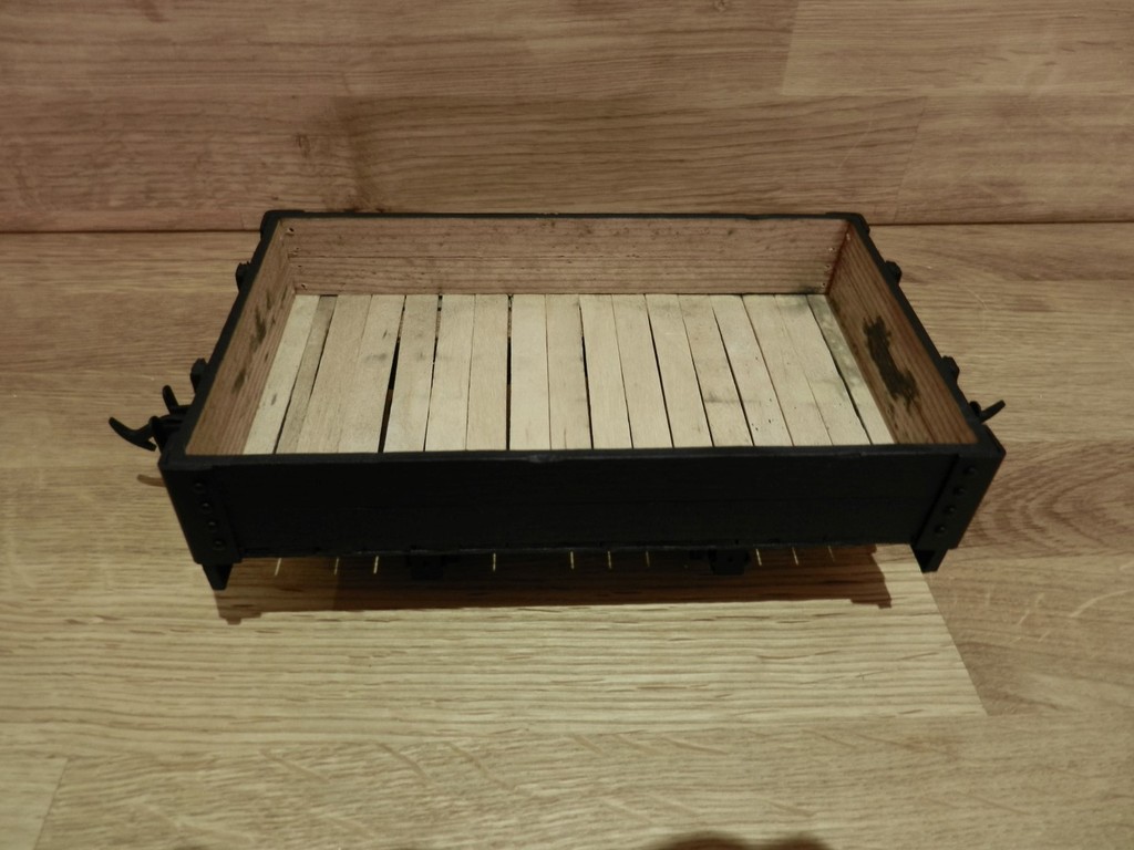

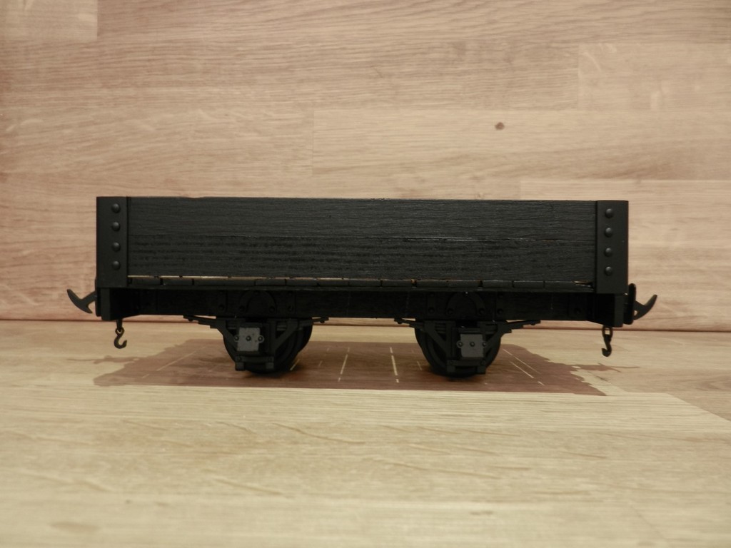

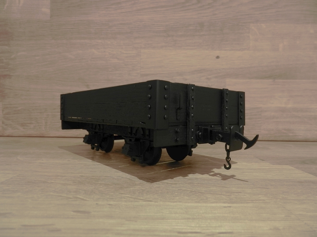

Post by tom_tom_go » Sun Mar 15, 2015 10:34 am
Back in black:
The interior needs weathering, however, it is all coming together now it has some colour :)
