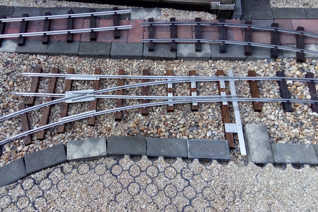

Post by idlemarvel » Fri Aug 23, 2019 7:00 pm
I took advantage of today's nice weather to install my point. It wasn't too bad a job. I cut out the portion of track corresponding to where I wanted the points to go, squared off the ends with a file, drilled a couple of holes in each end rail to take the fish plate bolts (the points came pre-drilled), scraped the ballast off to "bottom of sleeper" depth, bolted it in place and levelled it off. Picture below:
I have tested it running on the main line, fast and slow, forward and reverse, and it seems to be fine, no hint of derailments! The removed curve piece is shown top right. Tomorrow's job it to attach the sidings panel (top left). I will put a slight down slope away from the point so that any rolling stock left in the siding will tend to hit the buffers rather than roll onto the main line.
I have a plan for a point lever but I think I will start another thread for that.

Re: The Circle Line
Post by DonW » Sat Aug 24, 2019 12:02 am
Nice job there Dave. Looks like a perfect fit.
Don
Re: The Circle Line
Post by FWLR » Sat Aug 24, 2019 6:39 am
Neat job Dave, very professional.

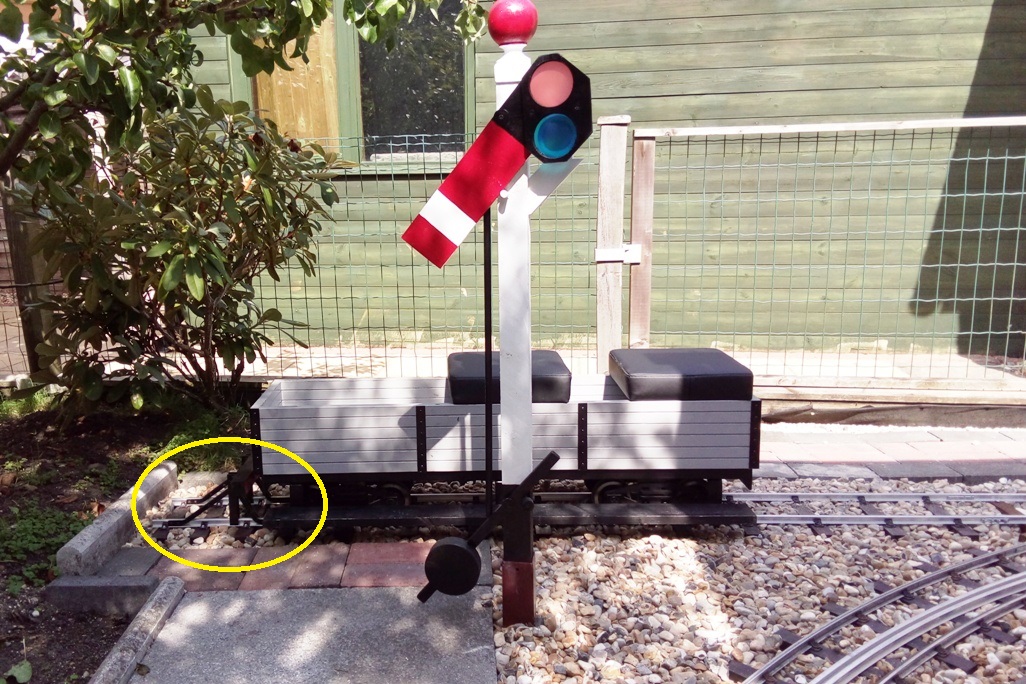

Post by idlemarvel » Sat Aug 24, 2019 1:53 pm
Thanks for the comments Don and Rod, much appreciated.
I have installed the sidings track panel and it now looks like this, just big enough to fit a bogie wagon / driving truck.
As I said yesterday I have put a gentle slope on the siding so the truck rolls gently into the buffers (circled yellow).
The buffer stop is a kit from PNP. It is more 1:12 scale so a bit small for my 1:6 railway, but it does the job. It comes with a small section of track which is attached to the siding but the fish plates are not bolted in place, so if there is a crash into the buffers it won't disrupt the points (hopefully).
