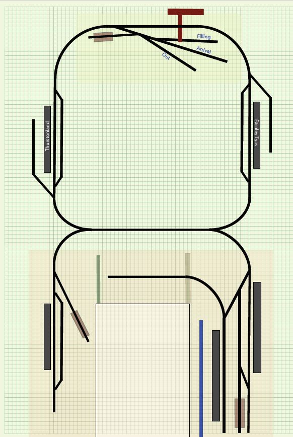

Hi - I use PowerPoint - drawing lines and shapes and adding text and colour - I use it a lot at work so I guess I'm able to get lots of practice - the example below is what I have in mind for my new line once I can sell my house and by a new one - it shows a garage at the bottom with two stations inside which are joined by track outside on the garden with various other stations and a quarry
The first two 'Y' points out in the garden are pivotal to the design as they allow access to both end stations but also create a loop for continual running - so it can cope with lovely sunny days outside, rainy days when I can play inside and send trains through the garden between the two indoor stations and also bring all teh stock in at the end of the day for security etc
The line also includes a branch to my workbench inside my garage - the lines 'works' - cool eh?
The blue line is a standard guage connect with the transhipment platform in between - one question......does anyone make track at 16:1 at a scale standard gauge?
