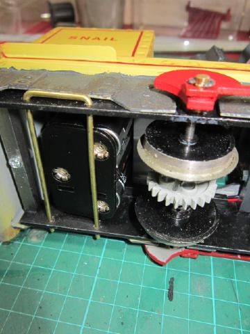

Post by Peter Butler » Fri Mar 21, 2014 5:41 pm

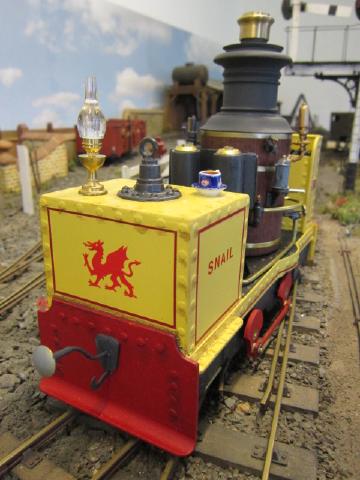

Another build comes to a close.......
'Snail' has its finishing touches and accessories to give it the Emett feel.... Coffee pot on its stand, coffee stained cup and saucer on top of the water tank. The oil lamp serves as headlight.

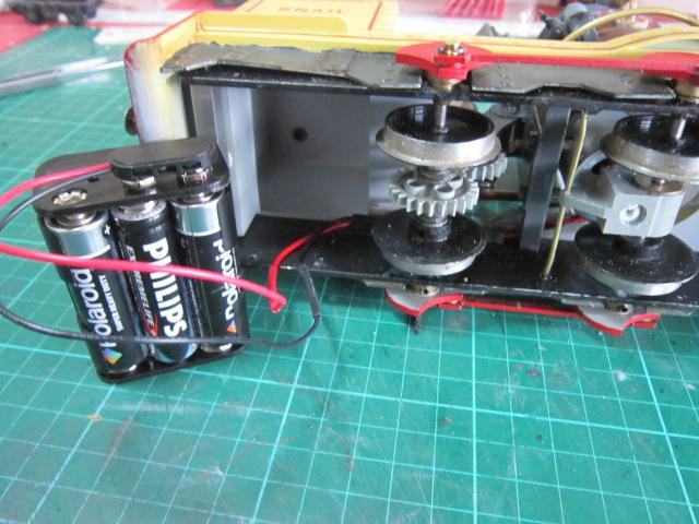

Power is by a battery pack inside the tank with a manual speed controller operated by twisting the brass chimney top.
Two switches are fitted to the side of the boiler to operate the forward and reverse and the on/off supply.
The driver has just popped out somewhere so isn't on the photographs.... you just can't get the staff!
Access to the battery box is from underneath the loco with a bent brass rod acting as retaining clip so no tools are required to change the batteries. Rechargeables are an option but would result in a loss of capacity of about 1.8v so might not be enough to work as well?
