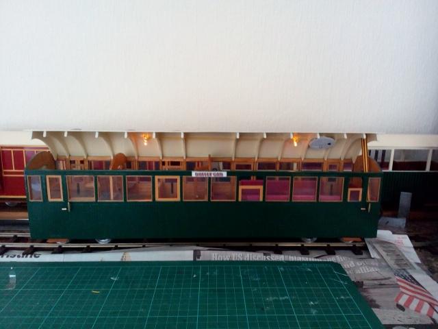

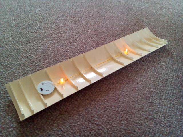

Fitted the lighting into the roof of my buffet car this pm. Used the switch/battery box( button cell type) from a little Poundland electronic tea light and two flickering orange led's from the same units. Tried to keep the wiring as neat as possible by threading through holes that I predrilled into the roof spars when I originally cut them out from 3mm ply.
This lighting setup has actually cost me less than a pound as I used bits from 2 tealights that are 3 for a pound. The wire was free as we have a virgin cabinet on the grass verge outside and there is often some quite long lengths of single strand wiring discarded on the grass after work has been done and it seems good quality.

That looks really good! I lit my Pickering but chickened out of doing so in the buffet because there's so little room to play with - well done!

Waiting until it gets dark to see how bright it looks inside. Although the actual coach originally had 3 lamps one was removed when the central partition was put in.
I will be putting 4 in the Pickering.
I like to put the battery box in the roof as I like to have the roof fully removable with no trailing wires down through the coach. It is also a pain to lift the coach off the rails just to switch the lights on from underneath.
D.

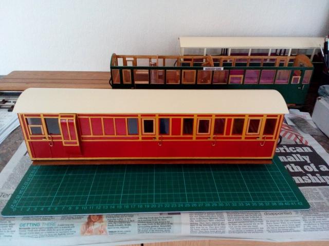

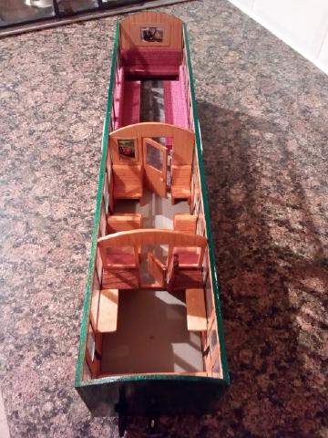

For my Pickering brake I used the 3 layer sandwich for the glazing with the door glass and window either side done as one piece, giving four pieces of glazing along each side in total. With the Buffet car each and every window pillar is only 3mm wide so I had to fit each piece of glazing separately up to a varnished glazing bar as per the 1inch to the foot rebuild at Portmadog.

Absolutely beautiful...... well done for technical skill and artistic interpretation.

As delivered from the makers my research suggests that the Pickering was aledgedly 'bright red with gold lining'.
