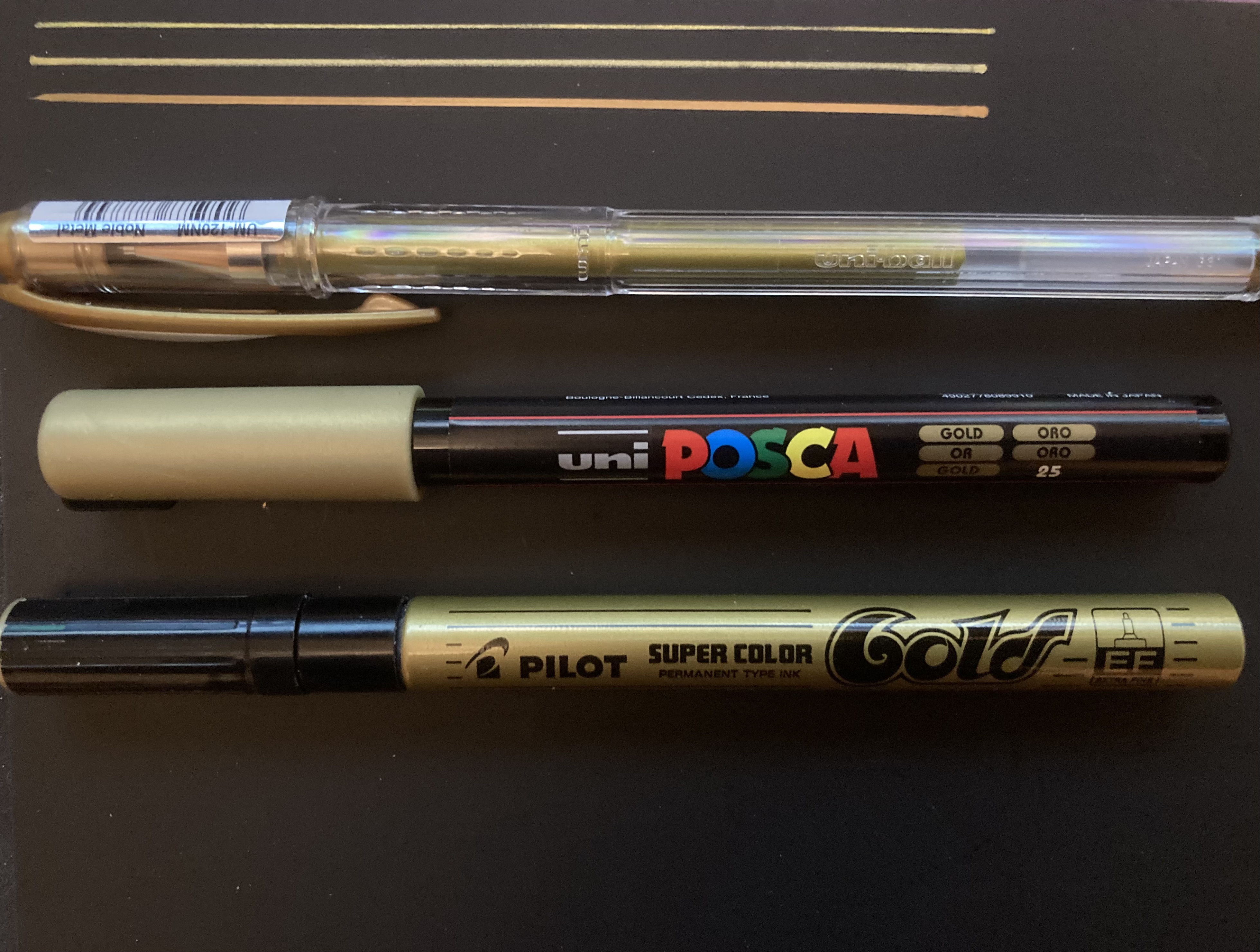

Plod has a collection of gold pens and is experimenting. Only the one dark maroon Director's Salon carriage will get the lining treatment. So far the Gundam gold fine pen one seems the best, but Plod would like a thinner one. Gumdam make a black panel line pen that is the perfect thickness and works super, but not available in gold. Sigh. No doubt due to the viscosity of gold pigments. Plod could get out his Bob Moor's line pen he has had for a few decades and learn to use it for the first time, but life is too short and he does not want that bother. Some pens say only use water based clears over them but plod smashed his samples with Tamiya and Dupli colour clears and no ill effects have been encountered.

Posts: 5721
Re: Llewellyn Carriage works contract for the POR
Post by Peter Butler » Sun Dec 08, 2024 1:32 pm
Hi Dazza, we are located in the 'Red weather warning zone', being a short distance from the West coast of Wales, and having just had our electricity supply restored following a 24 hour shut-down courtesy of Storm Darragh, I can now reply to your questions.
During my career as bespoke picture framer, when I created 'wash-line' mounts I used to mark fine gold lines with a Japanese, 'Pilot' super colour, gold lining pen. I still have one now, 25 years after retiring from the trade. It is rated 'extra fine' and has a metal tubular nib of approx.1mm outside diam. giving a 0.5mm line. However, after all this time it has congealed and decided to retire too, so will have to find its way to the bin!
Having checked on eBay they are still available (in UK) so search the title above and see whether you think it suitable.
As for the Canopy adhesive, I can only suggest the temperature is not suited to its use in the circumstances you describe as I haven't had the same issue here in our Welsh climate. Perhaps you could try working on a glass plate over an ice filled baking tray to maintain a cool surface temperature?

We have heard about Darragh, it canned some Santa trains at the FWHR.
I will delve into the ether net in search of such pens.

Durley
Posts: 181
Post by Durley » Wed Dec 11, 2024 8:41 pm
Looking good! For thinner gold lining from a pen, I suggest trying Uni-Ball Signo Gel Pens. I’ve had some success using one of these (also available in silver and white). Success is dependent on how well the roller ball can grip and therefore rotate properly on the painted surface. Matt paint worked better than a gloss finish in my tests.

Post by Durley » Wed Dec 11, 2024 9:18 pm
Quick test to show different line thicknesses from (top to bottom) Uniball Gel pen, Posca PC-1MR and Pilot Super Colour Permanent Ink pens. The Pilot pen is also sold by uni-ball as the 0.8mm permanent paint marker.
You can see where the gel pen has not produced a consistent width line due to the roller sliding rather than properly rotating. This was on unpainted black plasticard. A Matt painted surface gives more consistent results.

Post by Hydrostatic Dazza » Thu Dec 12, 2024 8:20 pm
Durley wrote: Wed Dec 11, 2024 9:18 pm Quick test to show different line thicknesses from (top to bottom) Uniball Gel pen, Posca PC-1MR and Pilot Super Colour Permanent Ink pens. The Pilot pen is also sold by uni-ball as the 0.8mm permanent paint marker.
I have the Posca and the Pilot and others.
They really do need the paper or a matt surface to drag the fluid out as the glossy surfaces proves troublesome. So far the Posca gives the thinner line but not as consistent as others. I may try out the Bob Moores lining pen with paint to firm up the decision. I think I have some more pens coming in the post to trial.
