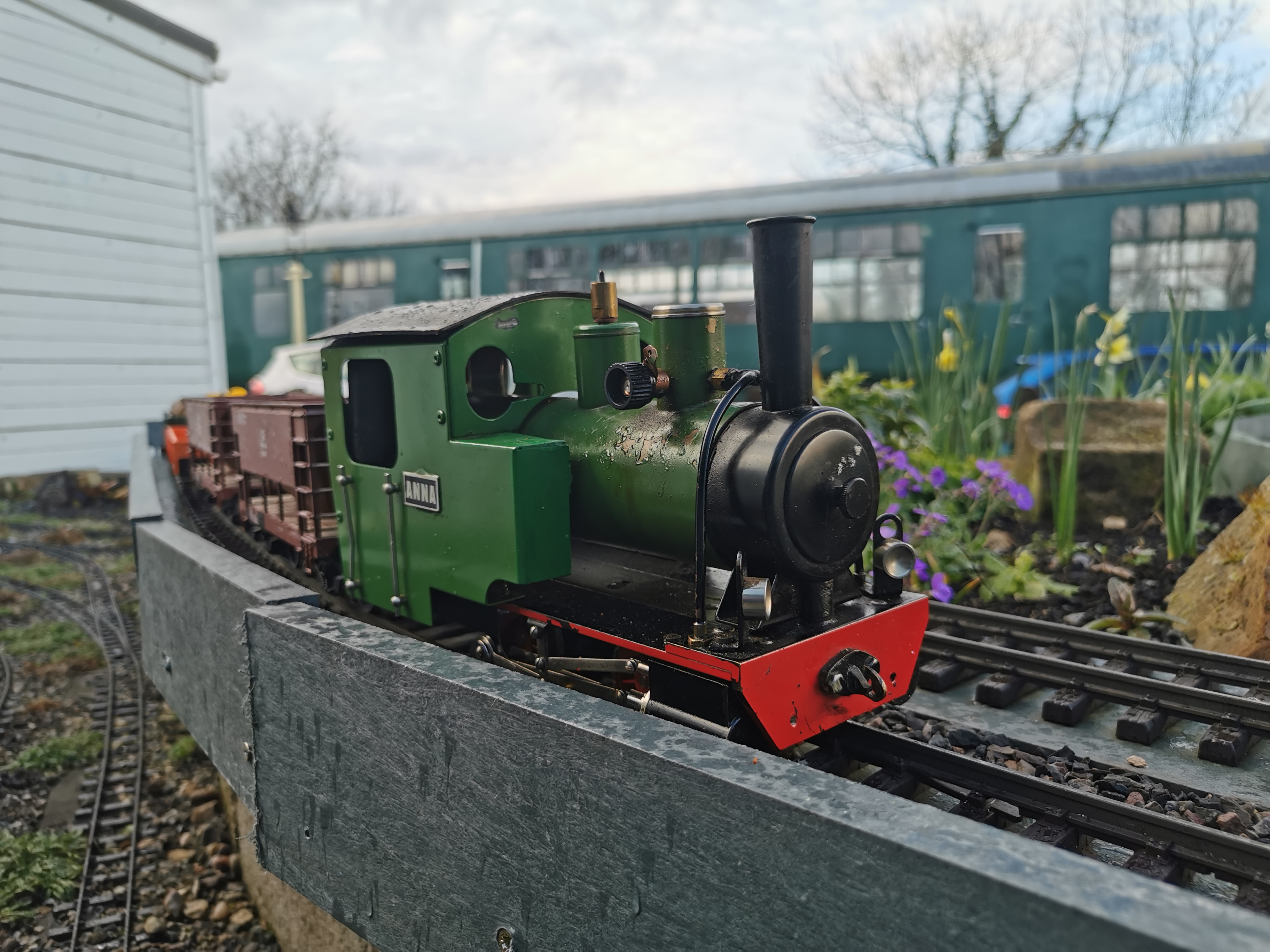

Hello All,
I appear to have bought a live-steam loco:
(Hopefully, there is a photo attached?)
It is a Beck 'Anna' fixed at 45mm gauge, which I assume is why no one else bidded?
Does anyone know the history of these loco's?
Thank you,

I'll follow progress with interest. I notice one of the front widows has been enlarged maybe to attach a servo to the throttle knob?? Will you try putting it under RC?
If so, I wonder if you can also include a device to roll the loco forward or back a few cm to reset the direction of the slip centric remotely.... :?:

So...
I have eventually got to run the 'Anna', and I am smitten!
Beck Anna at BGRA
Beck Anna at BGRA
She ran impeccably, easy to control, everyone present enjoyed seeing a 'heritage' loco run, and if I had wanted to, I think I could have sold her to a number of those present?
The pressure gauge does not work. - Can they be repaired?
It would be nice to keep her as original as possible.
It was decided to run her gently, without a pressure test, which will limit when and where she can be run.
I will ask a second opinion, at the weekend, but a 45 year old brass boiler might not like a hydraulic test?

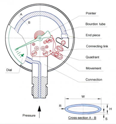

I don't have live steam experience, but if it's anything like an air compressor gauge there's a curled tube inside with a link to the needle. Sometimes the connecting link becomes disconnected or otherwise breaks, and if that is the case you might be able to get away with fixing or replacing the link. (Might need to adjust/calibrate the gauge afterward.)
