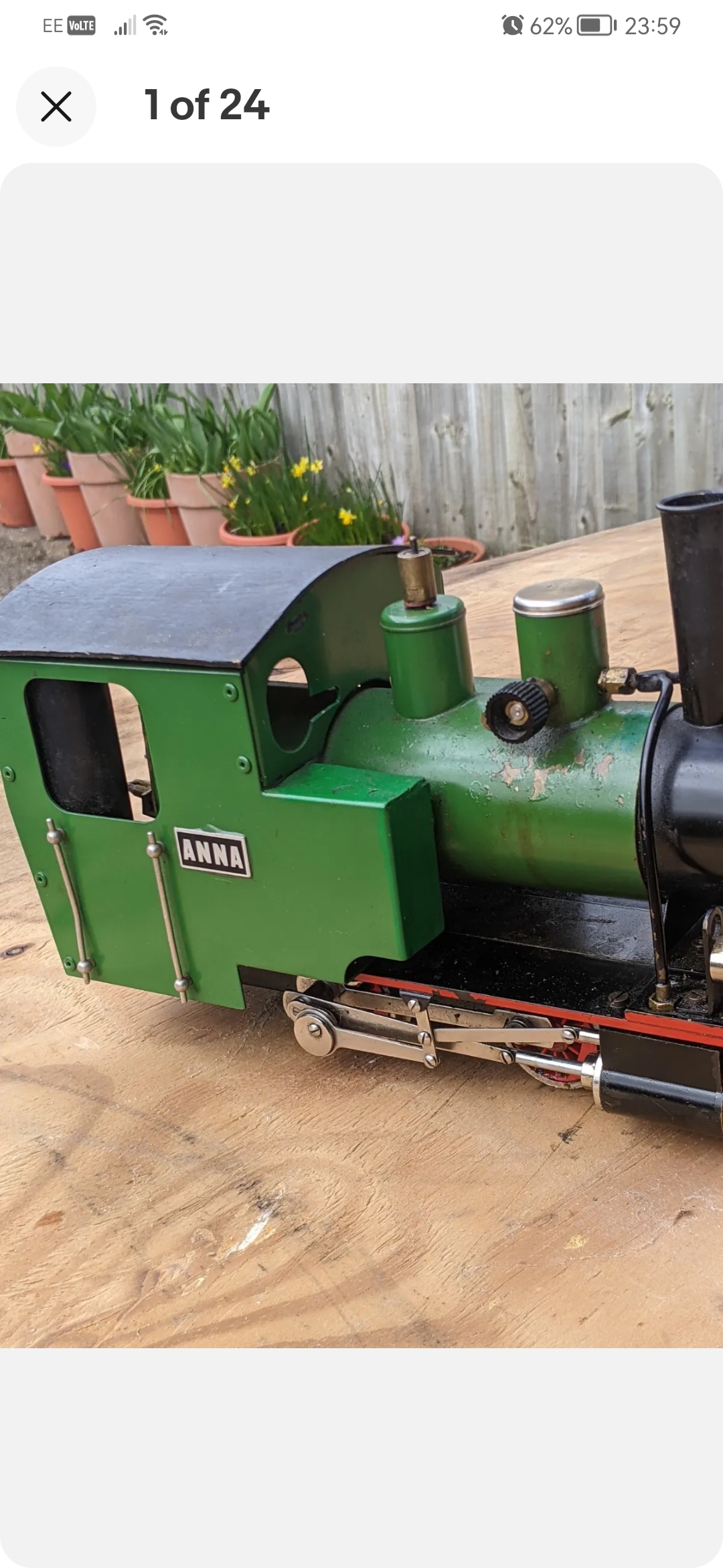

Hello All,
I appear to have bought a live-steam loco:
(Hopefully, there is a photo attached?)
It is a Beck 'Anna' fixed at 45mm gauge, which I assume is why no one else bidded?

Post by ge_rik » Wed Apr 19, 2023 7:15 am
I'll follow progress with interest. I notice one of the front widows has been enlarged maybe to attach a servo to the throttle knob?? Will you try putting it under RC?
If so, I wonder if you can also include a device to roll the loco forward or back a few cm to reset the direction of the slip centric remotely.... :?:

I did find one other site with information, and the loco there is a hybrid(?) at least in colour, and has a link from the regulator into the cab, but was not radio control. - Something like the ALSPC website? I will check, then edit this..
http://www.alspcs.com/Beck_Anna.html
Not sure if a 'stick' on a servo, would move the loco far enough (back or forth) to set the gear? :dontknow: :lol:

So did you get the old Anna going once she arrived? These old Beck have brass boilers, something to keep an eye on and drain dry when the locomotive is not in service to prevent the water from drawing the zinc out of the brass. Yes the notch is for a servo rod to go forward to a crank arm mounted in place of the knob on the throttle. These ran well, but you have to really keep the valve gear and eccentics clean and well lubricated or they will wear out fast. Neat little beasts that became the first Merlin Loco Works locomotives with more UK looking bodywork mounted to them. Good luck with the old girl. AD

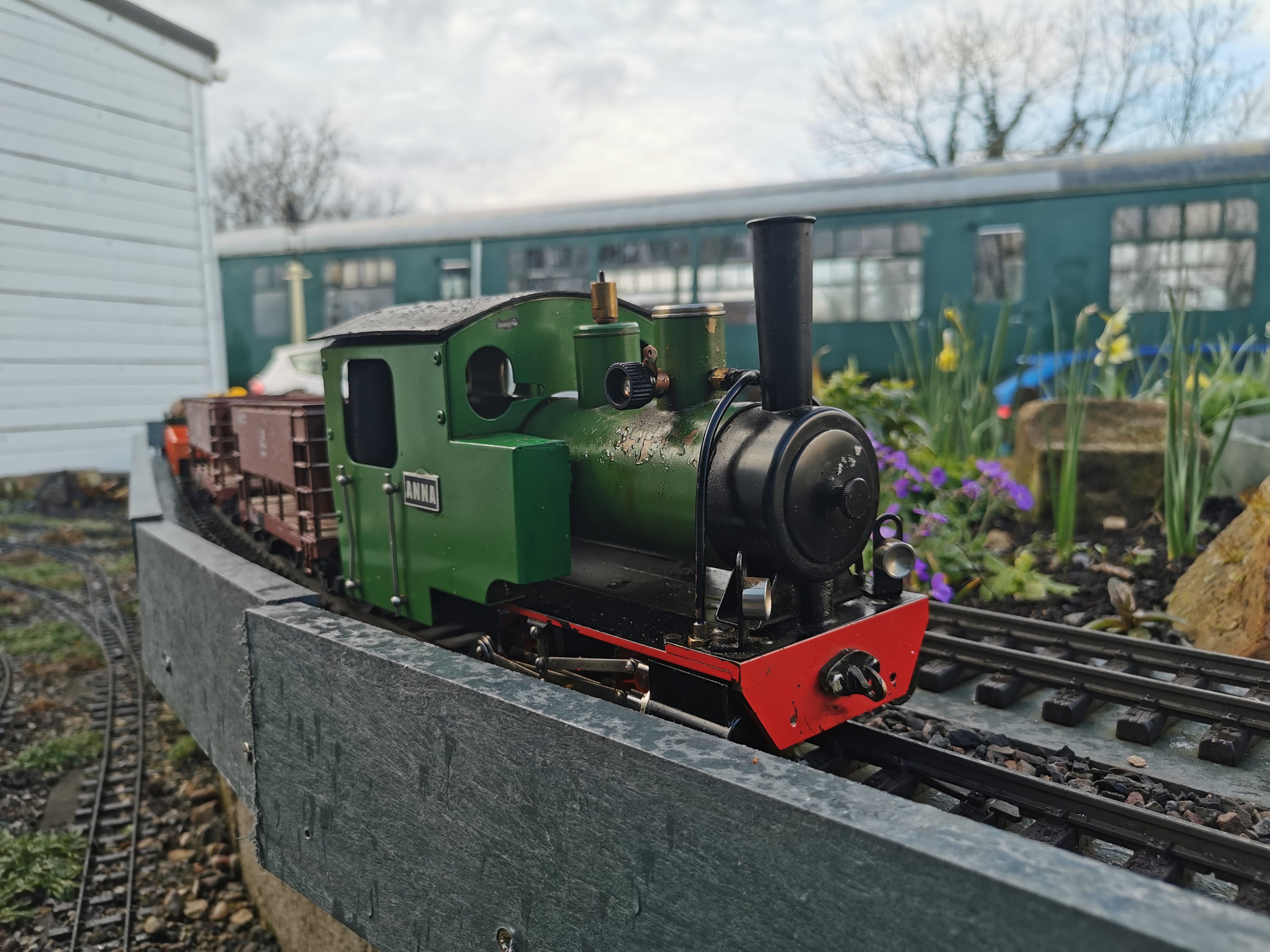

So...
I have eventually got to run the 'Anna', and I am smitten!
Beck Anna at BGRA
Beck Anna at BGRA
She ran impeccably, easy to control, everyone present enjoyed seeing a 'heritage' loco run, and if I had wanted to, I think I could have sold her to a number of those present?
The pressure gauge does not work. - Can they be repaired?
It would be nice to keep her as original as possible.
It was decided to run her gently, without a pressure test, which will limit when and where she can be run.
I will ask a second opinion, at the weekend, but a 45 year old brass boiler might not like a hydraulic test?

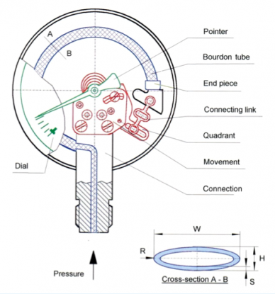

Posts: 839
Re: Ooops! - I have bought this
Post by drewzero1 » Thu Mar 28, 2024 12:47 am
I don't have live steam experience, but if it's anything like an air compressor gauge there's a curled tube inside with a link to the needle. Sometimes the connecting link becomes disconnected or otherwise breaks, and if that is the case you might be able to get away with fixing or replacing the link. (Might need to adjust/calibrate the gauge afterward.)

Phil.P wrote: Wed Mar 27, 2024 9:26 pm
So...
Well done Phil. Glad she worked out ok.
I can sympathise with wanting to keep her as original as poss, but IMO having a working and accurate pressure gauge is more important that keeping the original fitting 'just because', especially given the old brass boiler. You don't want to inadvertantly over-pressurise that!
