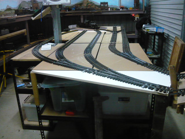

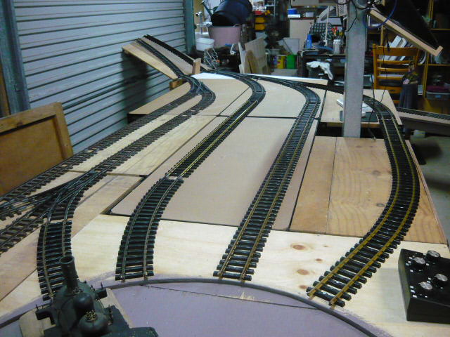

I used racking to build part of my layout, it is sturdy but light weight.

The steel is powder coated straight out of the box, it is workshop racking.Wet Woking Neil wrote: ↑Thu May 14, 2026 12:31 amI like that idea, and will look into it. Have you put any form of cover or protection on it?
The timber will get a coat of paint and as it is under cover it will be OK.
If I was doing this on a verandah/porch I would paint the timber with exterior paint.

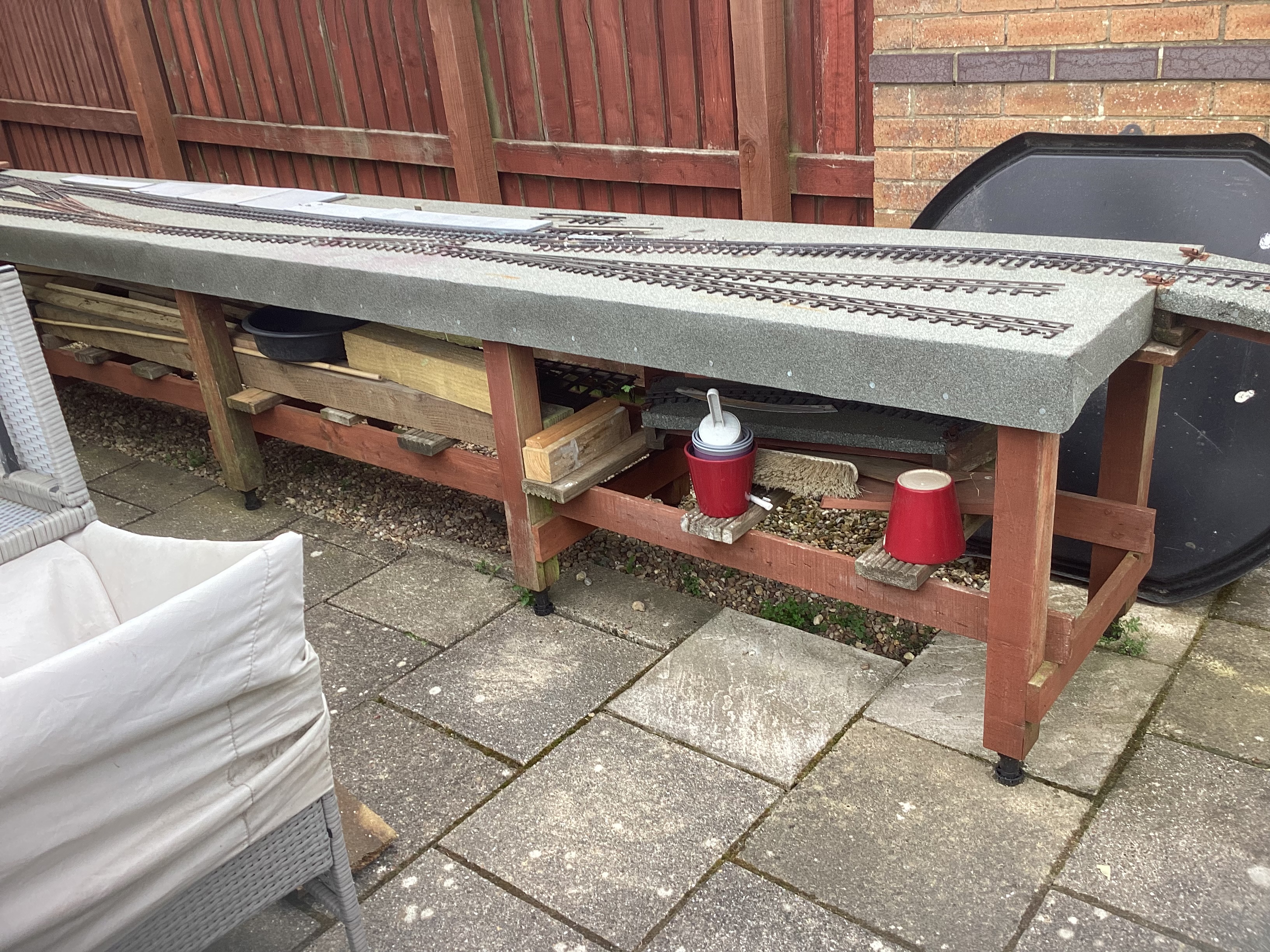

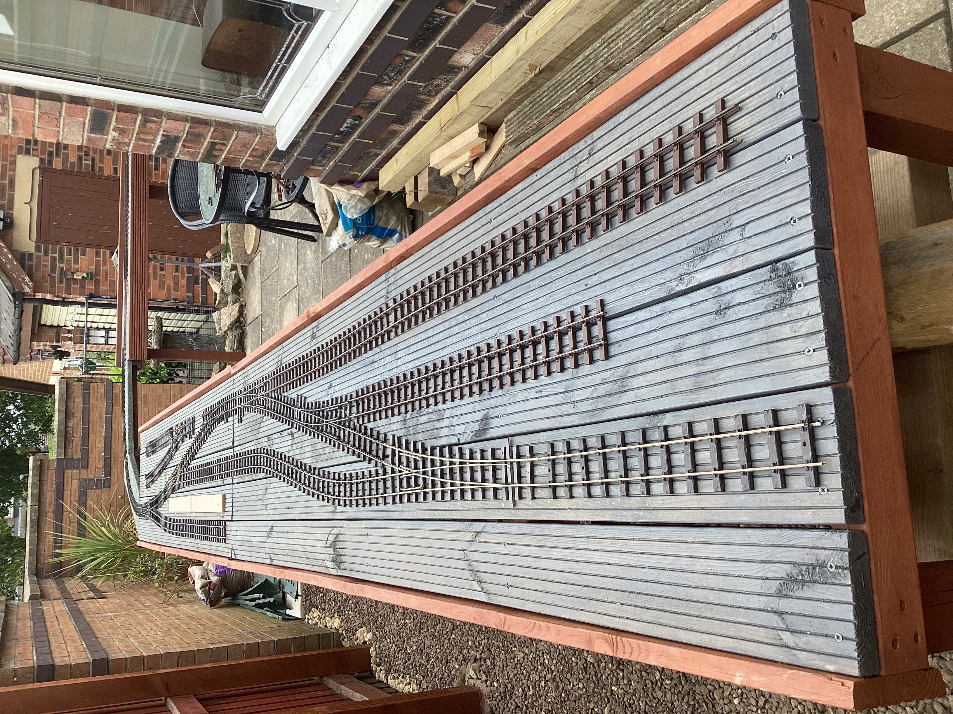

Hi, I’ve just noticed your post about raising a garden railway to waist height, which is what I had to do when I downsized with a small garden and a large patio around the conservatory. My railway stands 32 inches high and is built from recycled timber posts, pallets and new decking boards for the baseboards. From the attached pictures you will see the posts sit on kitchen cabinet legs to help protect the posts from rotting and also for levelling the baseboards. I should add that I built this 5 years ago.
Ok, I was fortunate in having to replace some fence posts which had the rotten bottoms removed and the remainder was cut in half to provide 2 posts. Also, my daughter & son in law had a new bathroom suite delivered on a very large pallet that once broken down provided some decent length boards to space the legs lengthwise apart with smaller pallets providing timber for the width. I was therefore able to build 3 baseboards each approximately 8 foot long and 2 foot wide.
The layout is end to end with the boards on the patio being joined by a smaller width baseboard supported on 4 legs that are buried into a flower bed.
Just something else for you to consider but it may not be everyone’s cup of tea but having a garden railway at waist height, I find is a blessing.
Good luck with yours.
Ray

Clever idea to use the kitchen cabinet legs - not only for adjustment, but also to discourage the dreaded rot ....

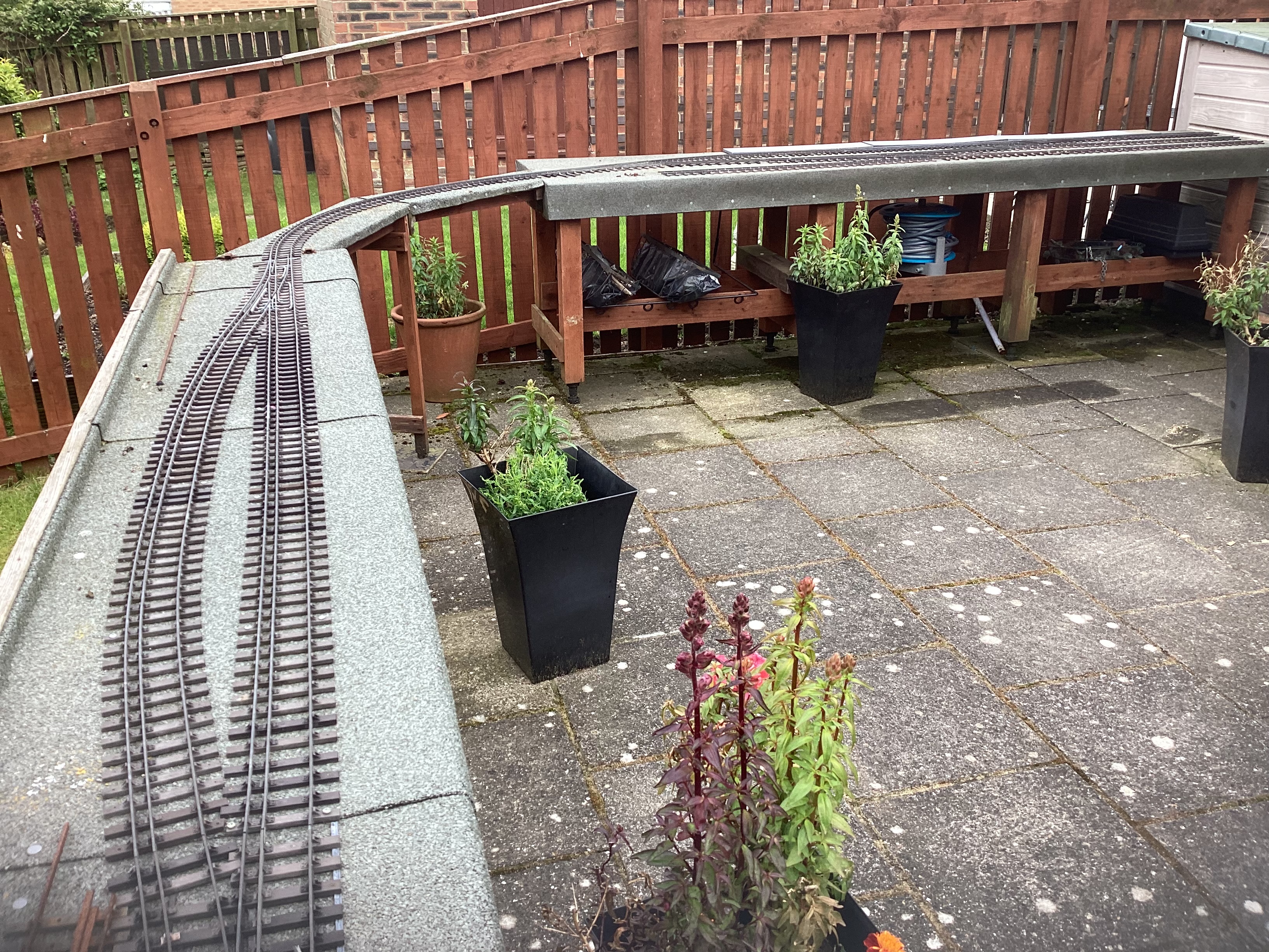

Hi, Yes you’re right I have covered the boards in roofing felt but it was originally as built (see attached picture). I found that some of the decking boards were twisted and I hoped that screwing them down with a bit weathering they might lay flat over time. No chance so out came the black & decker and I planned down the worst areas and covered it all in roofing felt.
The boards are fairly level and the majority of the rain literally runs off but it does pool in places but it’s amazing how soon the pooling soon dissipates much to my amazement. However, it might have been a different story if I had ballasted the track but I never intended to go down that road.

Generally thinking wood (or alternative) with some form of drainage holes/slotes, small sides to use gravel ballast. If i don't use gravel then roofing felt sounds a good idea. Not made my mind up as to how raise it, initally on patio but if expand may be onto soil. Seen some good ideas on here ranging from the racking to tables or wood legs think 4" x 4" should be strong enough and looking for old pallets for cross planks.Selhurst wrote: ↑Sun May 24, 2026 11:52 am Hi, Yes you’re right I have covered the boards in roofing felt but it was originally as built (see attached picture). I found that some of the decking boards. No chance so out came the black & decker and I planned down the worst areas and covered it all in roofing felt.
- Posts: 5950
Re: Ways to raise track to waist height on a patio
If you do use wood, do not put drainage holes through it, I absolutely guarantee that it will rot from those holes.
