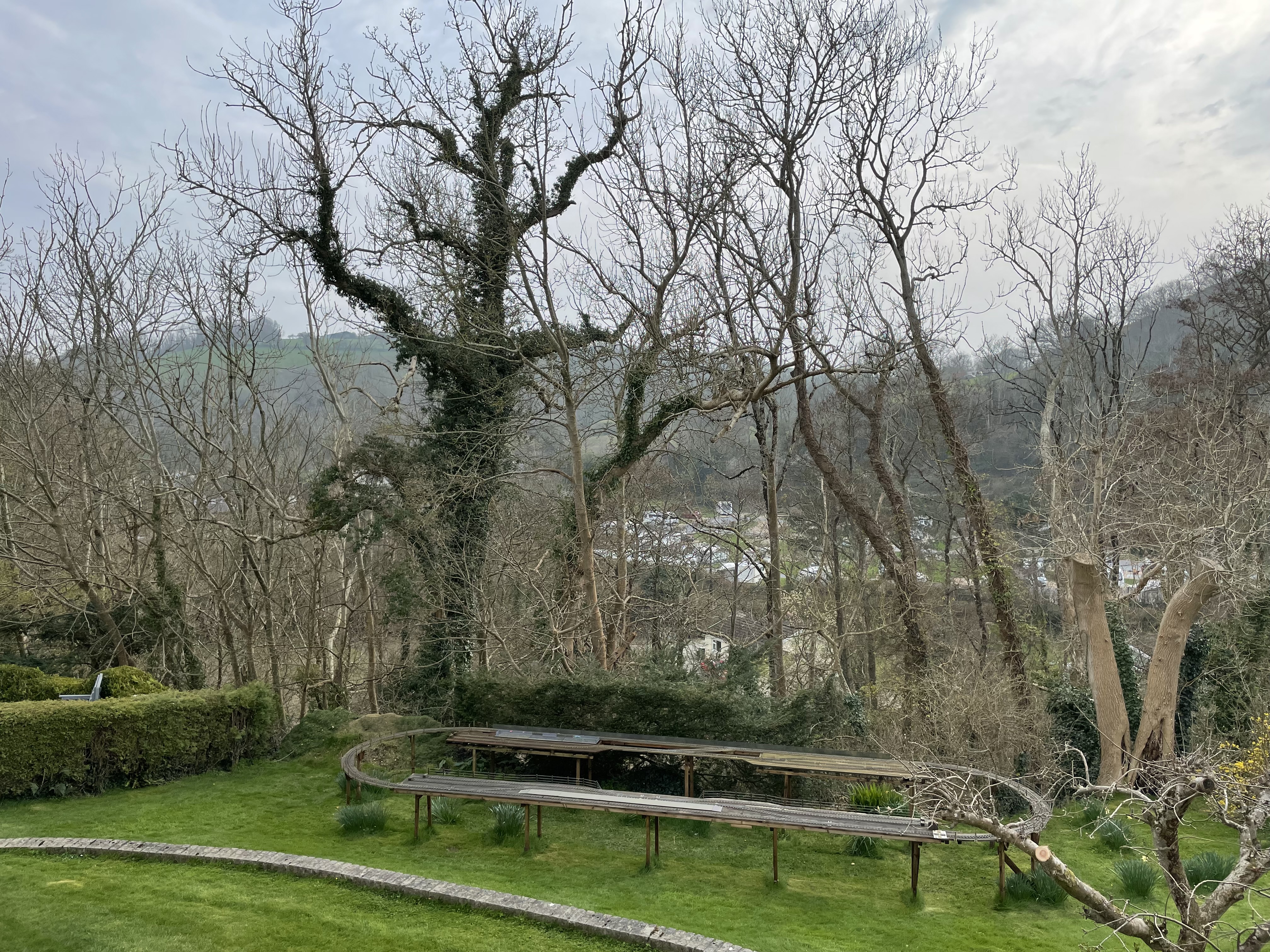

This is what my garden used to look like:-

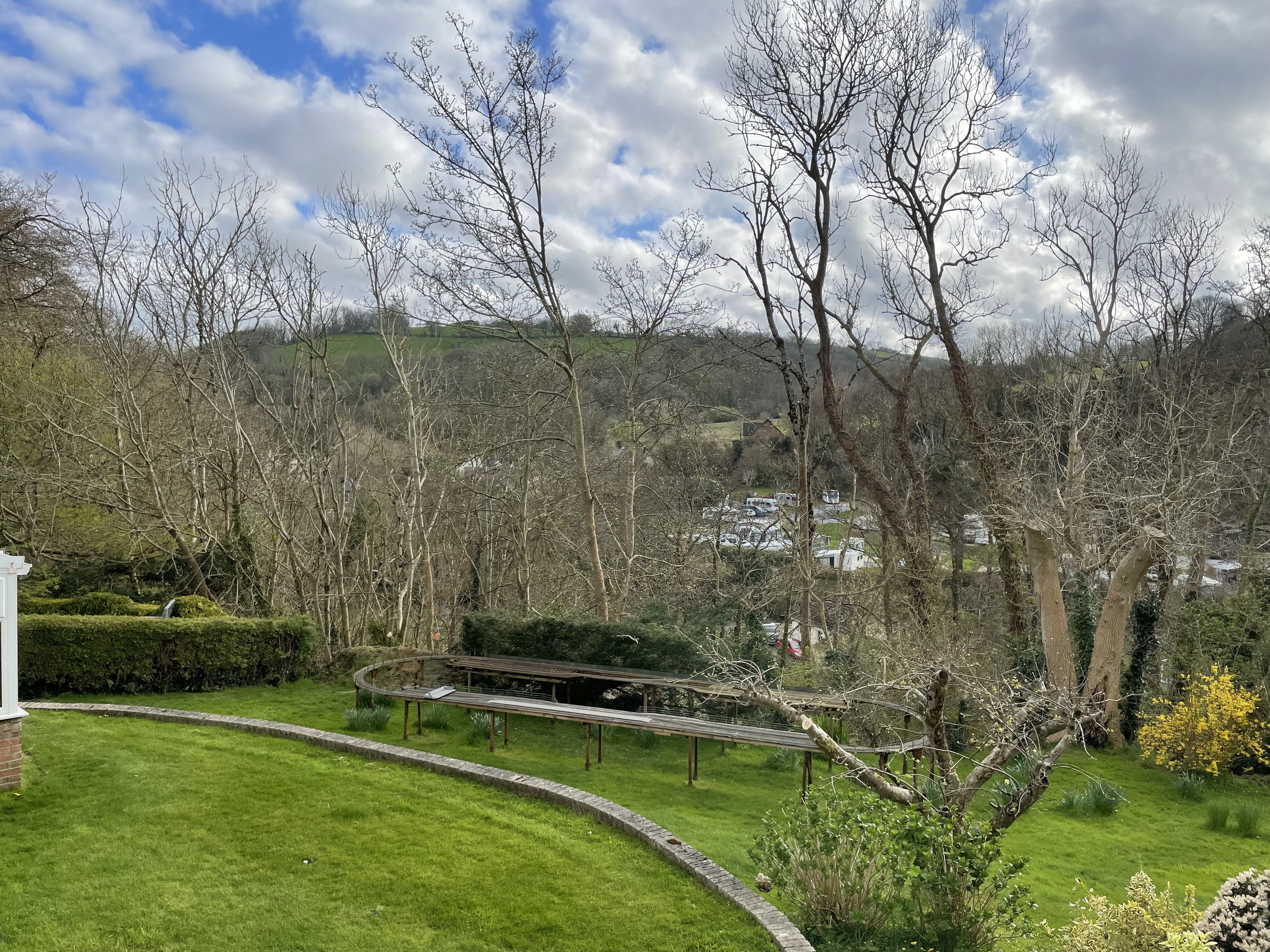

Then much to my relief a couple of weeks ago two ash trees in my neighbours property immediately below mt garden were felled and it looked like:-
The only disadvantage to the railway is that the recently named station 'Tan yr Onnen' is no longer threated by the 'Onnen' and so it is not 'Tan' it. Never mind plenty of stations are named after things that are no longer there.
For non Welsh speakers 'Tan yr Onnen' means Beneath the Ash.
