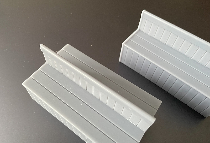

Anyway, I'm probably the only one who never previously knew about this, but whilst fiddling about with the printer setup, I came across something in Chitubox 2.3 that I had vaguely noticed previously but had no idea what it was so had left it alone. The setting is called "Bottom Tolerance Compensation" but basically it works as built in Elephants Foot removal! So instead of either having to mess about with chamfers on the bottom of the model, or filing it off after printing, the slicer effectively does it for you. It took me quite a while to get the right settings (and there is probably still room for tweaking), and of course they may be different for different printers and different resins, but having got it, I simply saved it in a new profile for future reference. ( I believe that Lychee slicer has a similar setting).
This is the test bench seat, the one on the right was printed on end with no attempt to lose the Elephants Foot, which shows as the bulging rim all round the end, and the one on the left is exactly the same but with the corrections applied. It isn't perfect, it still shows as a small scar, but it's much much better. Both use the same drawing and the same stl, just different slicer settings, and both took 1hr10mins to print.
This video describes the various Chitubox settings, but for me the two critical ones are to set Transition Layers to zero and set Bottom Tolerance Compensation to a=0 and b=-0.250mm (NOTE, that is b = MINUS 0.250!), all the other settings figures I left at default.
https://docs.chitubox.com/en-US/chitubo ... parameters
Also, as a bonus, this seems to have corrected some shrinkage in the z direction. The drawing is exactly 80mm, but with no corrections it printed at about 79mm with an Elephants Foot. With these new settings, exactly the same drawing printed at about 79.75mm with no EF.

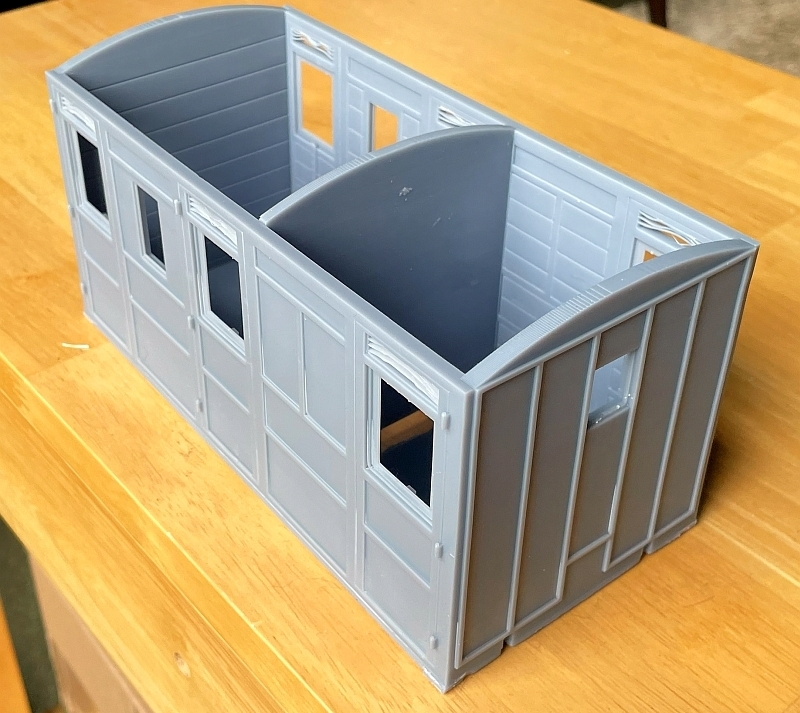

Now I have just done a print of a complete 4-wh coach body in one go. It took just 1.5 hours to produce this:
As you can see, there is still a slight ridge around the bottom of the body, so it looks as though I do need to tweak these settings, but either way it's a million miles better than with no adjustment.
