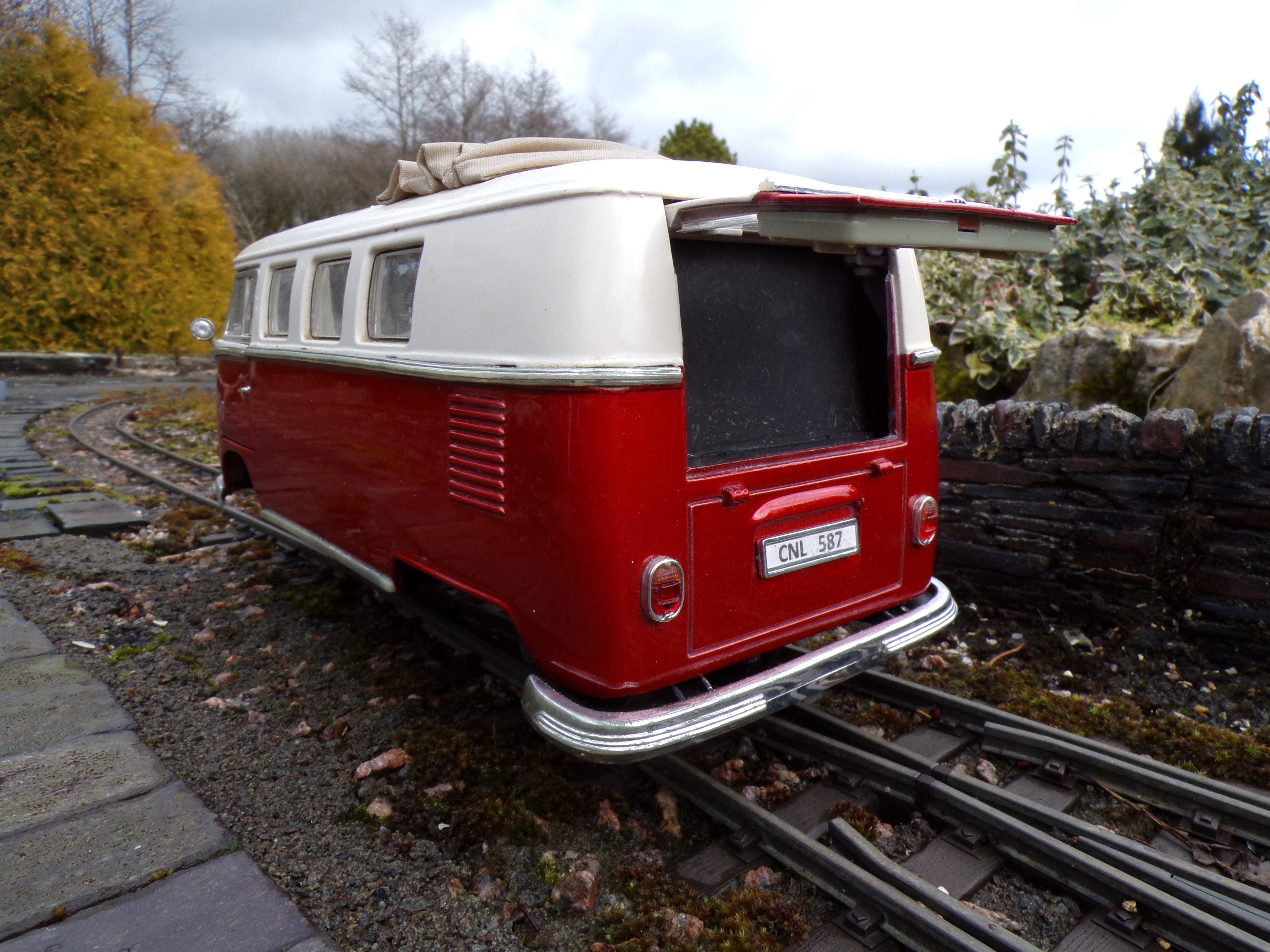

The VW bus is finished and runs well under test on my indoor layout. Pictures show it outdoors but the railway isn't tidy enough to even attempt a circuit. All of the RC control gear is in the rear of the model and well hidden. A black painted plasticard screen conceals everything from view through the window....
The on/off switch and charge socket are set under the floor, so out of sight.

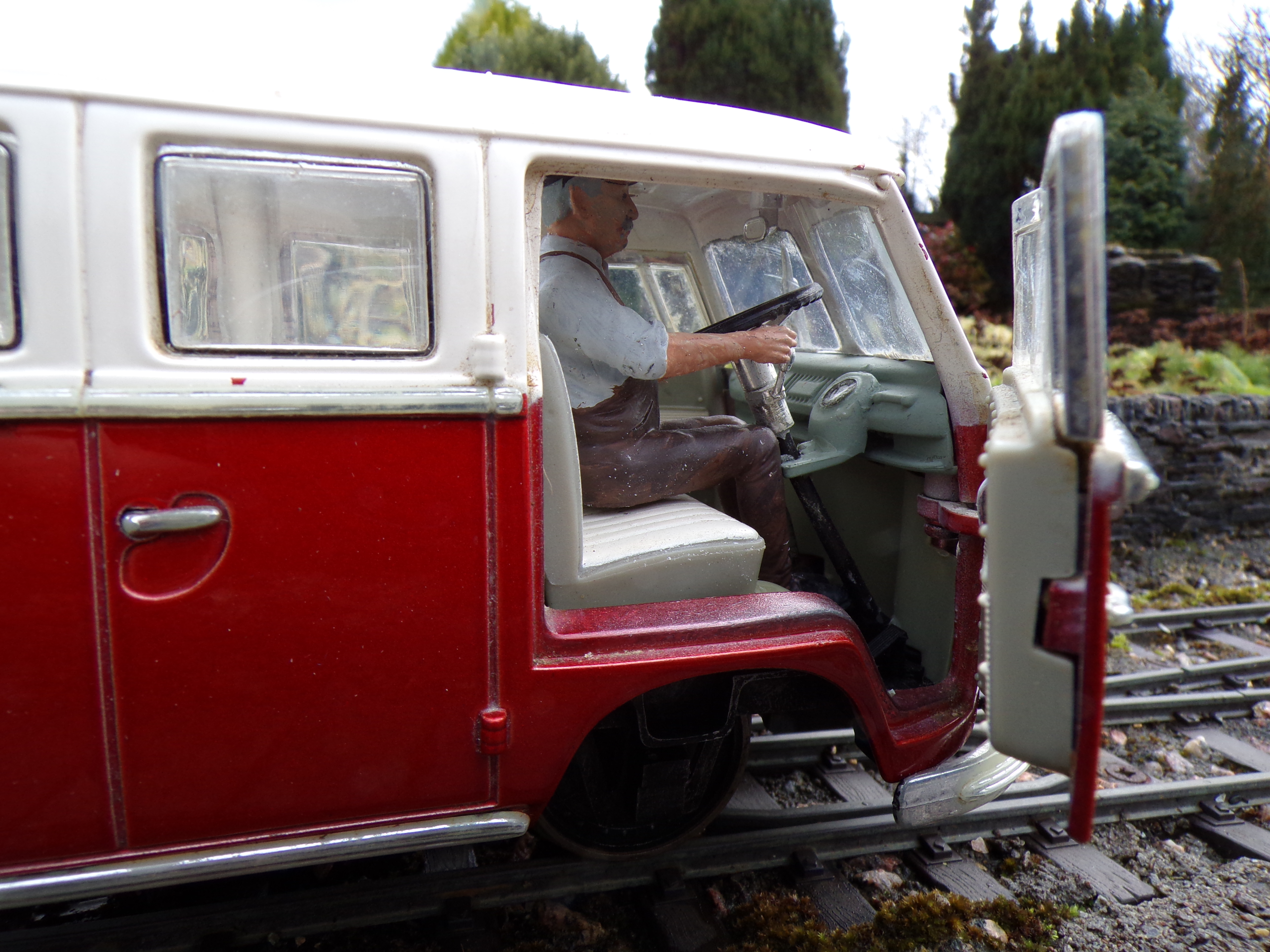

A few years ago I stripped out all of the left hand drive controls and altered it to RHD, however, as it was still a road vehicle at the time I didn't bother to install a driver figure in a stationary vehicle. Now it can be used on rails it must have a driver....
And the finished article....

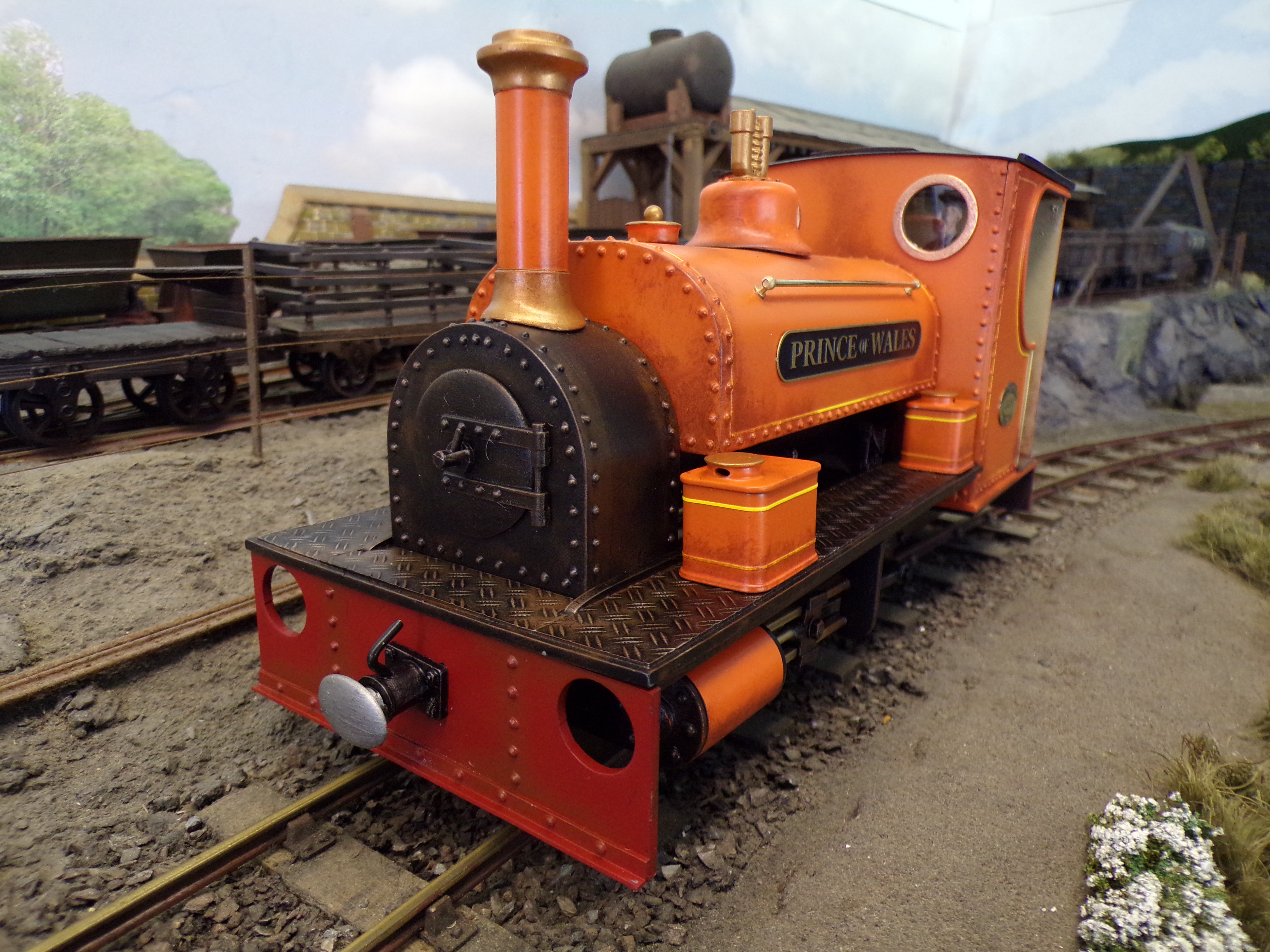

My last post on this thread was dated 4th March, and in the meantime I have added another loco to my stable and another digit to my advancing years.... 75 now!.... Where does the time go?
My latest build has been the Boot Lane Works, 'Varsity', inspired by the Hunslet, Mills Class, 'Vaenol' of 1895 vintage. Later, renamed 'Jerry M', it was joined by a second of the class at Dinorwic Quarry, built 1898 and named 'Cackler'.
This has been another well designed 3D printed and laser cut 2mm acrylic kit, up to the high standard Boot Lane can be proud of. Like all kits of similar material, it responds well to additional care and preparation during the build. I strongly advise reading the instructions fully before attempting assembly and paint items before construction.
The kit is provided with a 3-6v motor with printed gearbox. However, an MFA 385 5 pole motor (6-15v) can be sourced and an alternative worm and gearbox are included to fit. That was my choice and it works!

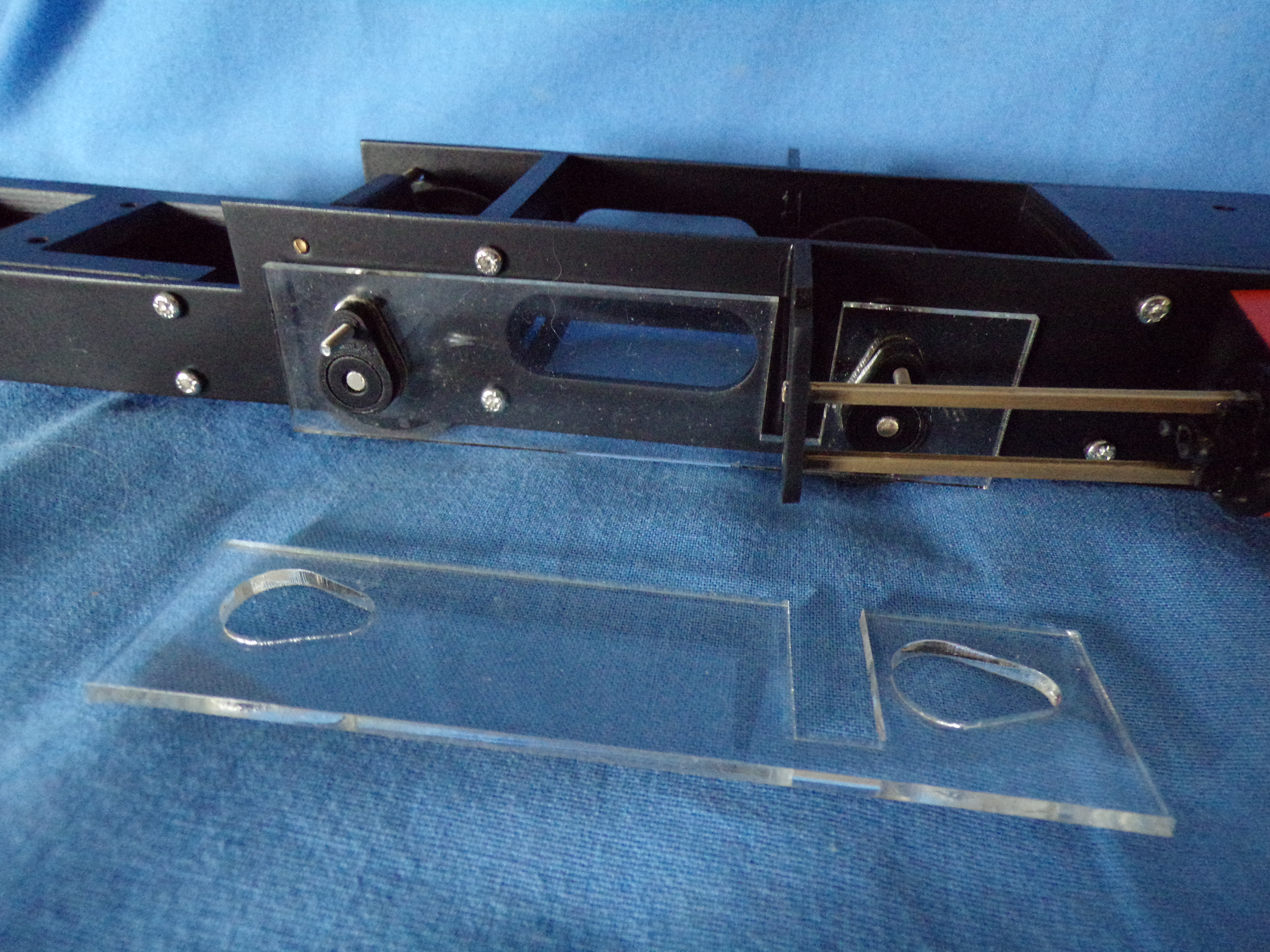

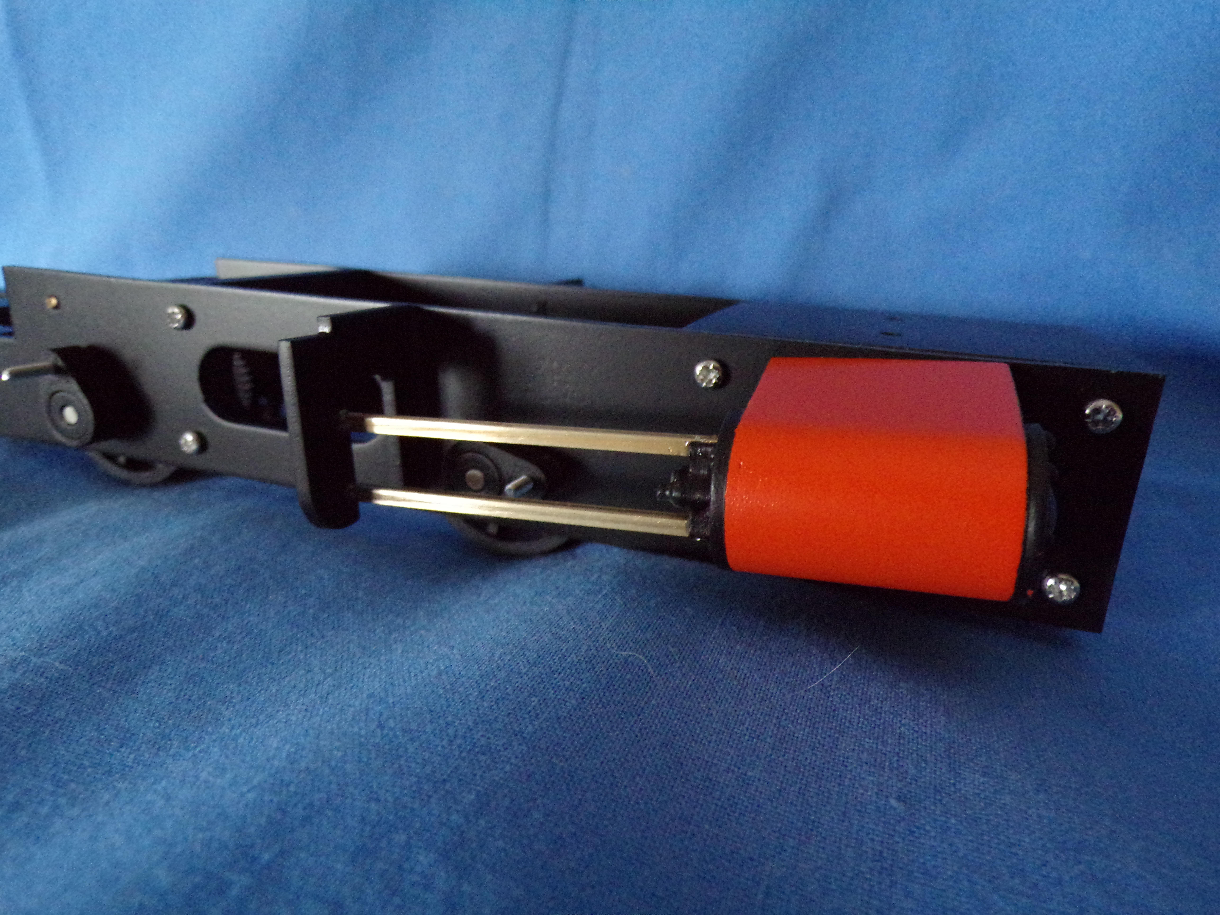

It is an outside frame kit so the chassis can be partly assembled with the substantial spacers before painting. The cylinders can also be pre-painted so that everything goes together and forms a smooth running chassis with everything in perfect alignment.
To make life easier an 'idiot proof' quartering jig is provided, and it is brilliant!...
By 'it' I should say them, because the templates holds the cranks on one side while the other locates the cranks on the other at perfect 90 degrees.... you cannot go wrong!
Cab detailing is provided but can be further improved with the addition of gauges and pipework, some of which I have fitted, although it is difficult to see clearly with a driver figure in there too....

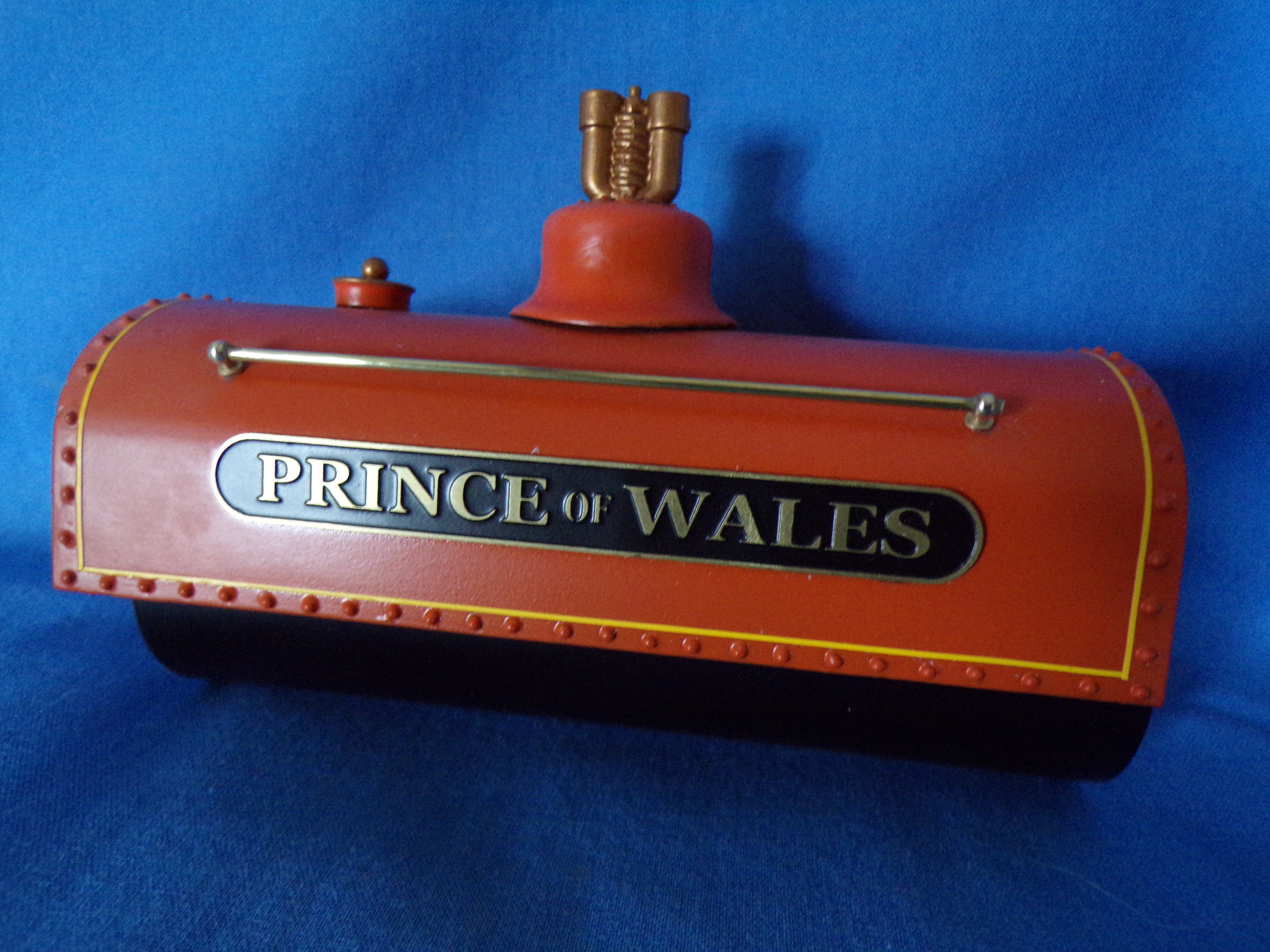

As previously mentioned, painting, lining and naming was done to individual sections of the loco which makes a far better job. Each unit then bolts to the next making access for maintenance far easier too. For this loco I used 'Trimline', which is self adhesive vinyl on a roll. I have a sheet of similar lines which my friend, Kay, cut for me, so far only in one colour, but I am going to ask for a number of different colours for future use.
Once applied and lacquered it stays put.
Here are the sand boxes prepared as above....
The smokebox and chimney. The darts have been replaced with white-metal ones as the resin ones supplied are vulnerable....
And the saddle tank, complete with appropriate name....
