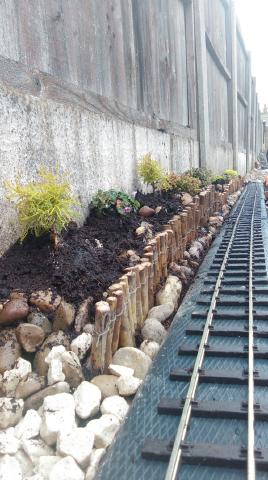

Post by Joe » Sun Apr 12, 2015 9:33 pm
Heres a pic of the first track laid on my currently un named garden railway, the track is nailed onto wooden planks which float on large ballast. The wood is covered in damp proof material and also nailed onto the wood. Large nails go through the wood and into the ballast for stability. At the moment ive done about 4 meters but the whole line will stretch for at least 24! I let the track over hang the wooden planks at each end as ballast will support it anyway but t allows me to change the direction of the next wood plank. I am currently awaiting a Y point to go at the end nearest the camera so i can have a island terminus station.

Post by Dr. Bond of the DVLR » Sun Apr 12, 2015 10:20 pm
Great start - the fence and scenics should look really good once the plants take hold. Are you going to put a run around loop at each end?

Post by Joe » Sun Apr 12, 2015 10:33 pm
Yeah its just a case of watering and getting the right scale ballast to go on top-any suggestions?. In answer to your question i will have a 2 track platform at the end nearest the camera (sadly I wont have room for a run round) but at the far end i will have a loop which connects to a double track station with run round loop, sidings and goods loop so it will be good to get started with that but i need to finish the straight section along the fence first.

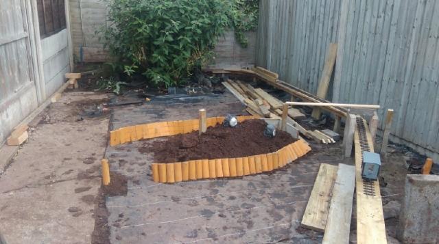

Time for an update.......to start with the line now has 3 steamers (2 working) and 1 diesel as well as about 10 wagons (but no coaches at the mo!) also me and a friend are starting the rather ambitious plan of incorporating the Ddault loop and station area.
Here is the view at the moment with the pile of earth starting to form the embankment for the spiral-the station area (where the wagon is) wont be at ground level though so earth will be built up to that to. At the back behind the buddlea there is a tunnel to prevent branches overhanging onto the track. It is my intention to design the layout so a train can continuously run around the loop at the lower level and then choose to go of down either side of the garden (one spur has already been completed and the other which is up the spiral is just being constructed). You can also see where the bridge is going to go and i have postcreated slabs upright for the bridge sides
