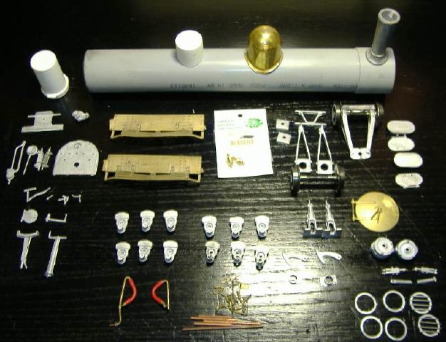

Sorry I meant the driving wheels. Here are some pic's of the bits. Max.
Here are the Bachmann Annie chassis. At the back is what we start with and at the front is what we end up with. the objective to get the shortest power unit possible. There is still a bit of jiggery pokery to do with the connecting rod and reverser to do to make it work. Note the connecting rod now goes to the rear driver not the centre.
All the other bits (ex' battery and R/C stuff) mostly GRS white metal and brass stuff. Also a bit of waste pipe and cut down pots from my glucometer test strips. Perfect for sand pots and steam dome locator. Not sure if I'm going to use those counterweights with the wheels enclosed by dummy frames.
