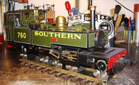

With care GRS kits, locos and rolling stock, will build up fine. But I have to say that all could do with a serious update and clarification on their instructions. They have a wealth of detailing parts available too if you want to semi-scratch build something more personalized. Working on a Manning Wardel Mallet using their bits.
Here's one I made earlier. Lining by Lightlines.
Manning Wardle Mallet
Have to admit after my Exe stripped 3 primary gears in succession, in what appeared to be a bullet proof gearbox with a total of about only 22 hours running, GRS agreed at no cost to replace it with a brand new Slaters "helical gear" type, at no cost. Max.
