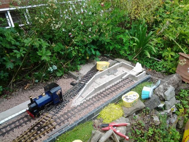

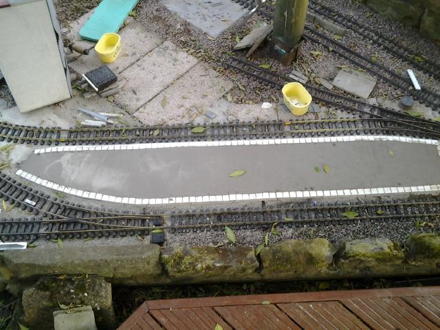

Post by bazzer42 » Sun Jul 27, 2014 9:50 pm

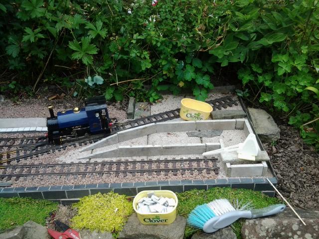

I know this is back to front but I have promised myself to start a thread on the development of the Vale of Fairway Light Railway. These are the works from the last 24 hours, the building of the platform at the harbour terminal. I have used slices of concrete tile as the platform wall and infilled with concrete. The white tiles are mosaic tiles for swimming pools. The fuchsia is and will be a pain but I'm grateful to have been allowed to extend.
The later pictures show a planned loading or unloading platform for goods, namely mackerel inwards and canned fish outwards.

Post by Peter Butler » Sun Jul 27, 2014 10:04 pm
That looks very neat and tidy.
Have you used Gripfill before and if so does it survive wet and freezing conditions?
Post by bazzer42 » Sun Jul 27, 2014 10:10 pm
[quote="Peter Butler:102964"]That looks very neat and tidy.
Have you used Gripfill before and if so does it survive wet and freezing conditions?[/qurote]
Peter, I have used it on some of the piers that will appear in later photos and these have survived since last summer, so far! It is blooming horrible stuff to get off of your hands which gives me hope. It sticks like the proverbial to a blanket.  Do you get freezing conditions in West Wales? :D
PS it was a burger to shift the first set of platform uprights after 24 hours when I realised Lady Anne wouldn't take the curve around the edge of my first platform build :oops:

Post by Peter Butler » Sun Jul 27, 2014 10:29 pm
I have tried various ways to stick materials together and still experimenting. My first thought was to use hot glue sticks to bond slate blocks for buffer stops. To some degree it works but the slate needs to be sealed to prevent delamination. Perhaps Gripfill will also serve this purpose?
As for frost conditions.... in Wales?????....well, occasionally. I will give your method a try and we can compare notes as you obviously have much warmer weather than we do, across the water!

Post by steamie1 » Sun Jul 27, 2014 10:57 pm
Swimming pool tile adhesive by Dunlop (Dust bag not premixed) Lasts years
Posts: 5717
Post by Peter Butler » Sun Jul 27, 2014 11:03 pm
steamie1:102971 wrote:Swimming pool tile adhesive by Dunlop (Dust bag not premixed) Lasts years
Good shout!!!!!
I bet that would be good for ballast too. Have you tried it?
Posts: 6057
Post by philipy » Mon Jul 28, 2014 8:11 am
bazzer, I really like the cut slate walls, especially the coping stones.
Peter, when I did my tunnel mouths I used waterproof tile cement, that I originally bought for laying slate floor tiles. I guess its probably similar to the swimming pool stuff but possibly available in smaller sized bags?
I used two old roofing slates as backers, cutting the shape of the tunnel mouth with a tile blade in a jigsaw, then used a tile cutter to slice bits of Cotswold stone into blocks and stuck them on to the slates using the tile cement, then grouted using waterproof grey tile grout. They have both been outside for two winters and two summers, with no detrimental effects so far.

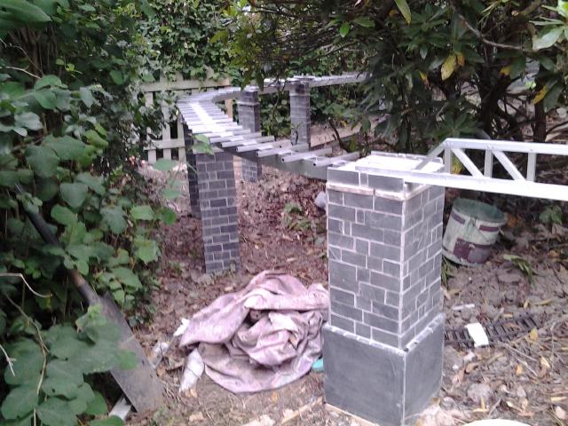

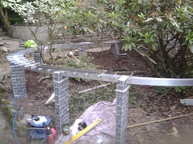

The height of drop is accentuated in the spiral as the flowerbed is raised. This means in some place the track is over 2ft above ground level. To do this I have used piers made from 3ft kerb edges stood on their ends and clad in slate. Before cladding I slit the tops of the piers with an angle grinder to take aluminium track supports. The photos show this better but I formed an aluminium girder from 2" wide strip and 45mm spacers. This was pure fluke as I had ordered 1 3/4" box but they had to substitute 45mm as it was out of stock, this now meant I could use curve templates from Jims Models to space the aluminium whilst forming curves! The spacers have half inch tube riveted to the top for track supports.  I've still to work out how I am going to add support posts but the straight elements will have truss girder sides like the approach bridges on the long bridge in the photo. I have been selling these truss bridges on ebay (shameless plug!!) for a while now.

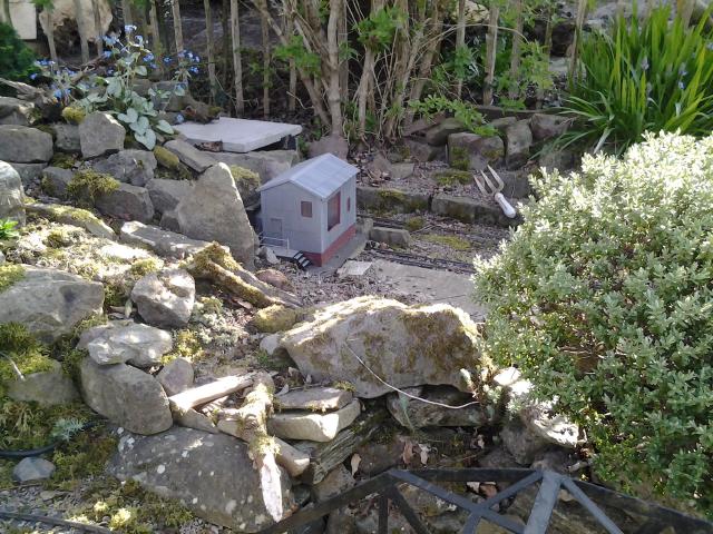

The station in the flowerbed is a harbour station with a sea of babies tears/ mind your own business.  At this stage Fairway is an island somewhere in the Bristol channel and could be Welsh or could be English. If Welsh it will probably be Gard Gerrag but we will see. The facilities here are minimal. A small unloading dock (in the process of being built), a small goods shed and a short siding serving a permanent way department i.e. a corrugated shed that has yet to be built and inspired by a drawing in a recent SMT(147). All imports and exports go through the harbour.  The sea is rich in mackerel and these are canned inland before shipping back out. There is an aquarium gravel mine on the mainland and this has rich veins of red, white and blue ore that are exported. Other than a dairy it is general merchandise that is moved by rail.

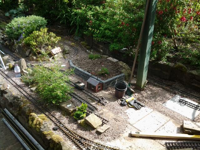

Having to lift up track to allow the harbour branch gave the opportunity to remodel the station where it branches off. Creating a new loop at 45 degrees to the old station has given me a crossover in the (insulated for playmobil days) loop. This means any train from the harbour can do two circuits before returning to the harbour. Facilities at this yet to be named station (Milbridge Junction?) are a cattle dock and a goods shed. Beyond the station there is a two foot radius curve to the quarry and three sidings for the wagons that serve it. The dairy is situated just as you leave this station. The narrow running lines behind the patio mean that any buildings will be in low relief.
Heading towards the storage shed we pass another siding that will eventually handle breakdown crane.  There is small engine shed as we enter another station requiring a name.  Luckily I have used r3 and r2 curves on the narrow straights meaning I can remodel the engine shed layout without too much trouble. That said, I would like to replace the siding on an angle to a 14" turntable. The station here has two sidings, one to a goods shed and the second to.....not sure yet. It could be a carriage siding or a bay platform. I plan to build a footbridge and have platforms either side although it must be heartbreaking to miss your train and see it reappear on the other side 30 seconds later!

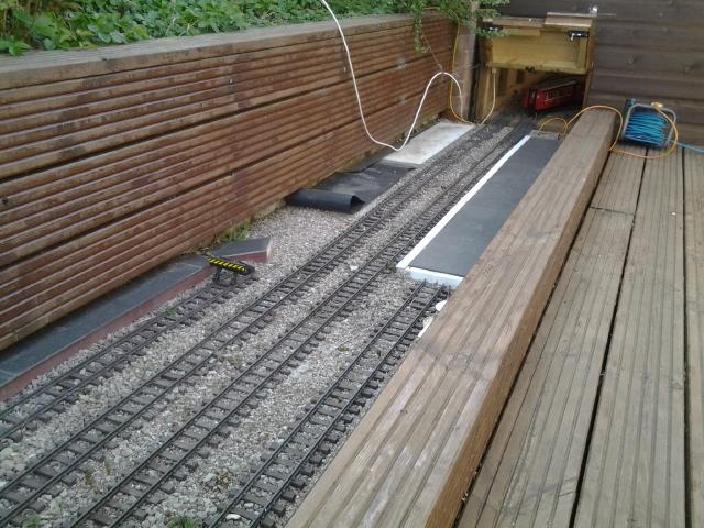

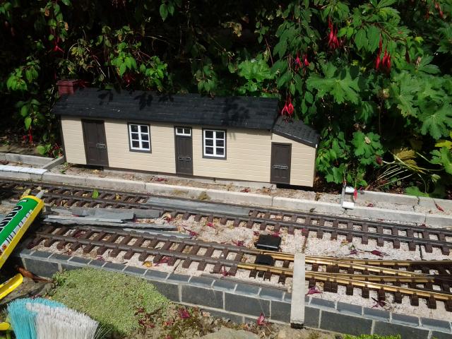

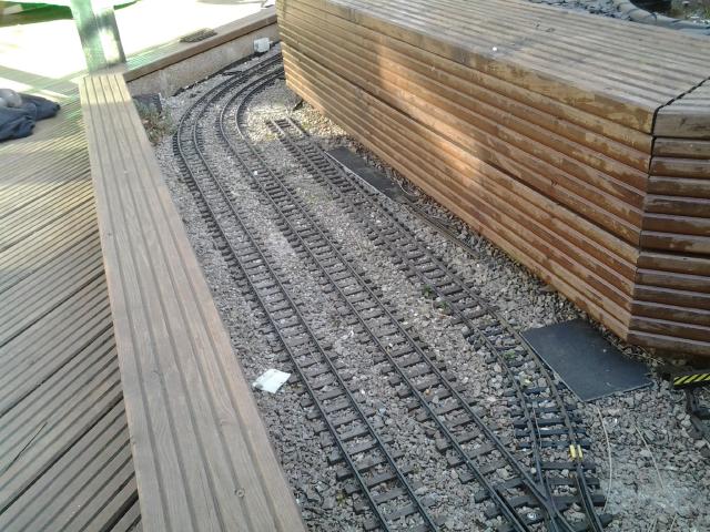

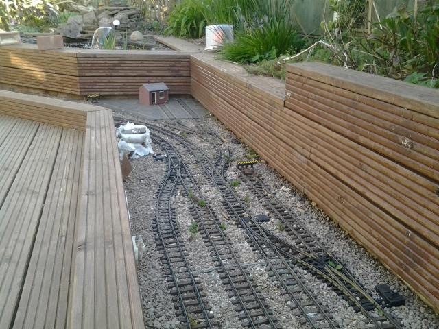

Post by bazzer42 » Thu Aug 14, 2014 10:20 pm

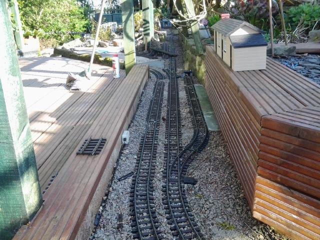

These photos show the narrow strip from the shed to where the lines diverge to make a bigger loop at the end of the garden. At this point we are entering Milbridge (?) Station.

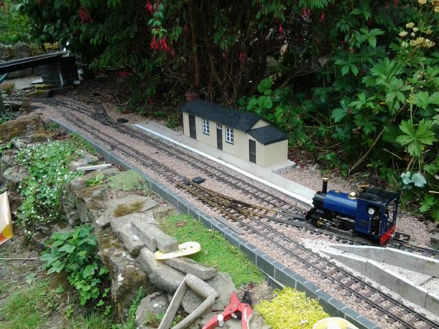

Post by bazzer42 » Thu Aug 14, 2014 10:29 pm
Here is the exit from the shed that I somehow dropped off the last posting.
A few more recent shots of Milbridge.

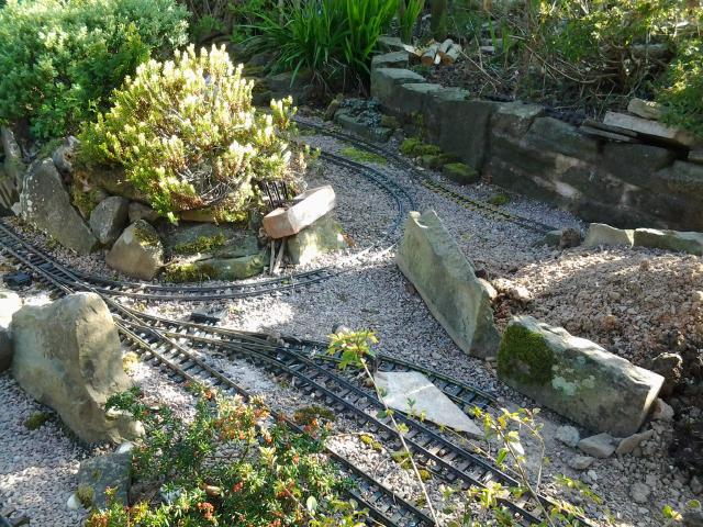

Post by bazzer42 » Thu Aug 14, 2014 10:38 pm
The return loop beyond Milbridge.

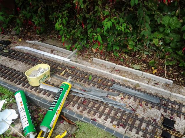

Post by jim@NAL » Thu Aug 14, 2014 10:40 pm
looking fantastic im a carpenter /builder gripfill will work and survive outside iv used it to repair broken slates /tiles on roofs it will last for years
Post by bazzer42 » Thu Aug 14, 2014 10:44 pm
jim@NAL:103328 wrote:looking fantastic im a carpenter /builder gripfill will work and survive outside iv used it to repair broken slates /tiles on roofs it will last for years
That's a relief Jim as the next set of photos show my piers with their slate clad sides all stuck with the stuff!

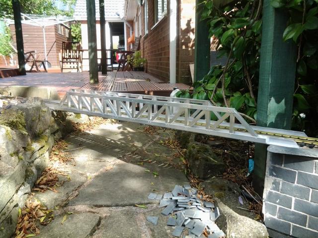

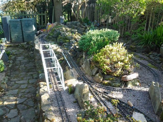

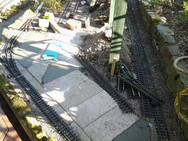

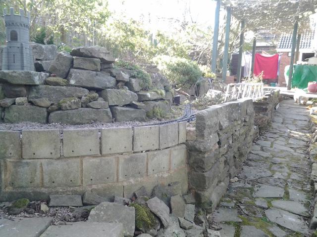

Post by bazzer42 » Sat Aug 16, 2014 11:04 am
A few pictures of path crossing and construction of the spiral descent to the harbour.
I have been pleased with the results as I have worked with a piece of string, a spirit level, large Stanley angle and a tape measure.
Post by bazzer42 » Sat Aug 16, 2014 11:11 am
Here are the pictures that arrived upside down on the last post :shock:
