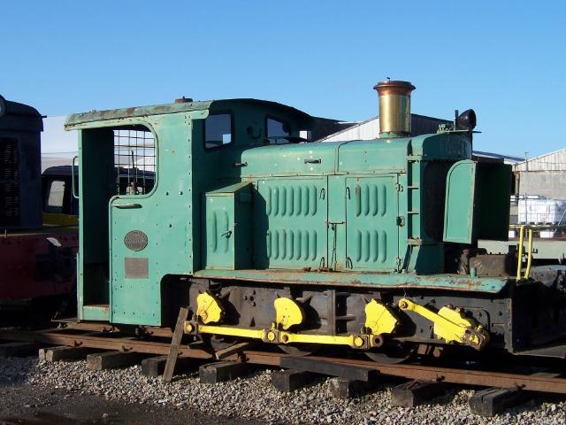

Fowler never built any diesels in 15" gauge but they did build various designs in 2' gauge....
I'm planning a 'might have been' 15" estate railway loco based on this

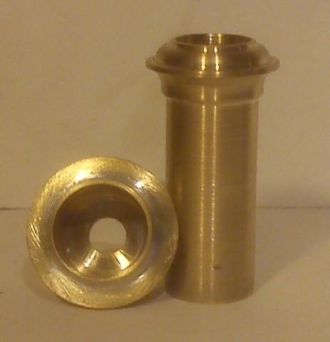

Post by jez kirkwood » Thu Mar 06, 2014 9:29 pm
Here are some pics of the chimney, they are both turned from old plumbing fittings, the stack itself is one piece and the base three pieces. As you can see the base is drilled ready for the speed control pot. The stack will have a length of brass rod soldered across the middle which locate in the slot on the shaft of the speed control pot. the flange on the base is shaped to fit the curved top of the bonnet and was attached with a large solder fillet all round which was then shaped back with a round file.

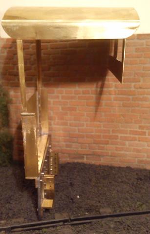

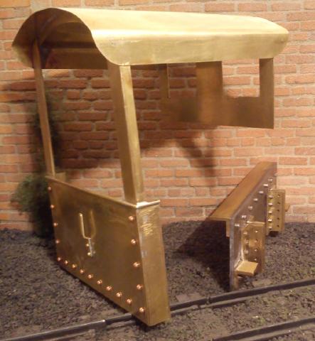

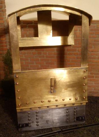

Over the last few days I've been making a start on the cab, after a lot of consideration the cab design is being based on the Fowler 'Resilient' class 2' gauge locos but with a drop footplate.... The new rear buffer beam is made from 2mm steel, the other parts are brass with solder, rivets and 12ba hex nuts and bolts holing it all together.

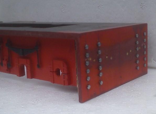

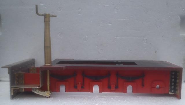

Over the last few days I have taken hacksaw to plastic and been modifying the Accucraft 'footplate/frames', should be fairly obvious from the pics..... Yesterday this all got a couple of coats of satin black, just waiting for the Talisman couplers to arrive now. Last night I picked up the etchings for the radiator unit - more of that later...

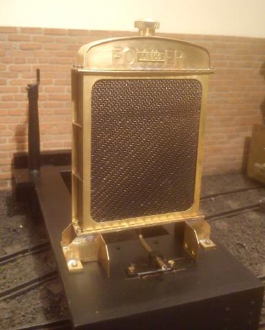

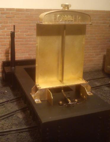

Well I spent an enjoyable few hours yesterday building up the radiator components, beautiful etches from Allen Law as usual. Tonight I finally figured out where to hide the forward/reverse switch, I turned a brass filler cap for the rad and soldered this to a length of brass rod which operates the switch. The switch will be hidden under the gearbox cover - which is next on the build list. The first pic shows the how the switch mechanism fits, the second pic shows the completed rad unit.

That radiator is a work of art, very nice etch

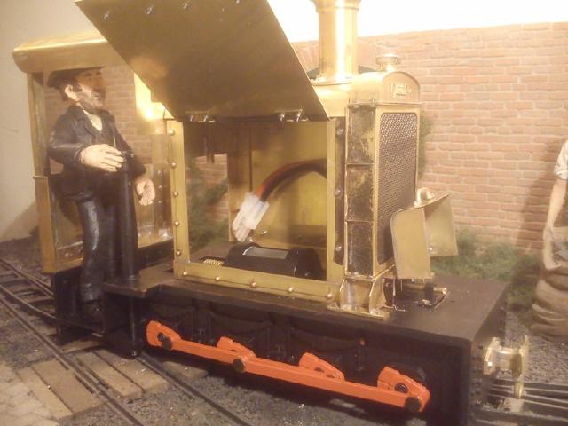

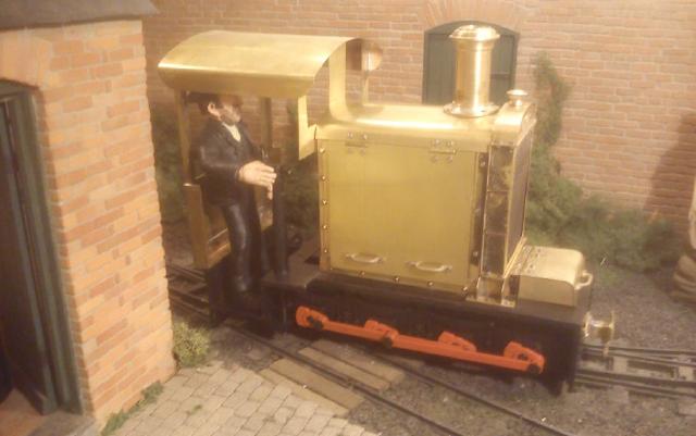

Over the last couple of days I've been doing some work on the bonnet and fitting the couplers. Next job will be to finish the cab (it's just resting there in the pics). I'm still hoping to have it running at York show over the Easter weekend - not long now........
I have also settled on a name, after much thought the loco is to be called 'Bartholomew' after the first person to ever build an internal combustion loco on 15". As is shown in the pics the bonnet sides are hinged to allow fitting/removal of the battery pack.

A quick phone vid of the loco running round the garden tonight, I still need to finish the cab interior and install the driver, fit the name and works plates and do some weathering.... But she runs, the vid shows her running at full speed on the 7.2v battery pack - taking nearly 4 mins to do a circuit of the garden. Looking forward to running on Waterfield Hall at York show this weekend..

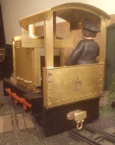

This is all I'm doing before this weekends York show (hopefully name and works plates will arrive at the show), as you can see the driver and cab controls have now been fitted. The driver is one of the Busybodies/Modelearth figures and being 7\8 scale is only 5' tall in 1;12 - this wouldn't have been a problem with an open cab but on this loco he couldn't see out of the window!! This is a prototypical problem, we have a couple of drivers at Perrygrove who struggle to drive Lydia without the aid of a chequer plate 'booster step' which sits on top of the frames! For the model I decided to cut both his legs and extend them with brass rod and milliput.
