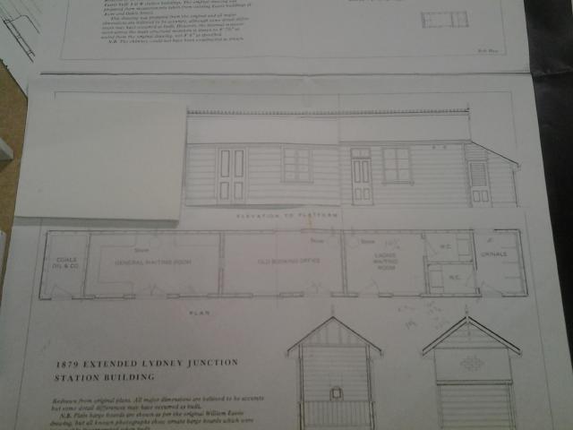

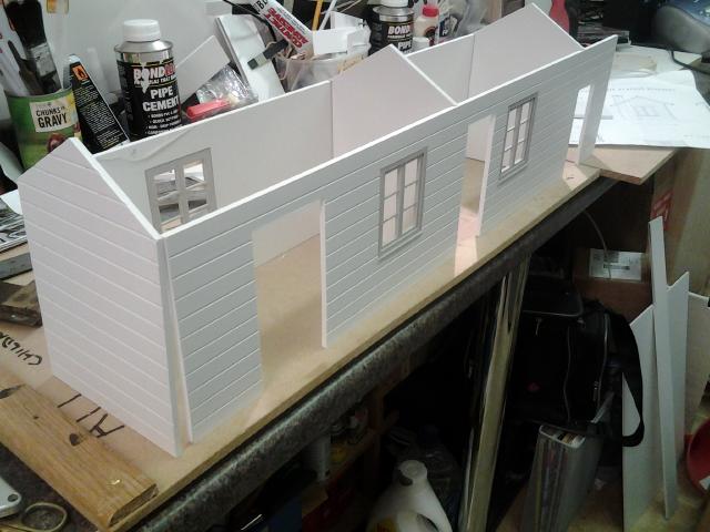

Having cast all those resin doors and windows it would be rude not to start a building. My first station based on the Eassie design for Lydney junction with an Awre station waiting room. I have truncated it to fit the artificial slates and because at nearly 3 foot long it was becoming unwieldy. Construction will follow the same manner as the goods shed. Mr cock up has already come calling as the gents has a lean to roof at one end finishing at the height of the door. I should have allowed for this smaller door when placing the toilet window at the back....the roof level cuts throgh the top pane :( Never mind a bit of filler will cover most of my bodge. There have been some lovely interiors on here but I think these may have some benches for a couple of passengers and no more.

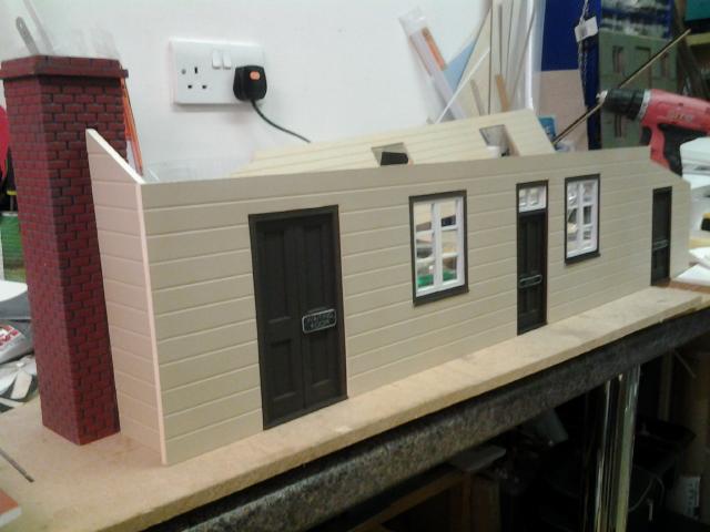

Post by bazzer42 » Sun Mar 02, 2014 8:12 pm

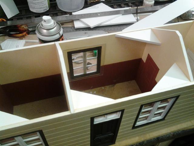

Budget time keeps modelling time to a minimum but some progress has been made. The centre window at the end has been replaced by a chimney and I have opted to scribe a loose interior. The interior should be enough to give an impression under lights at night.

Post by bazzer42 » Tue Mar 04, 2014 6:26 pm
All stuck together last night, roofing tonight but need to cut slates and interior benches first.

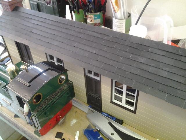

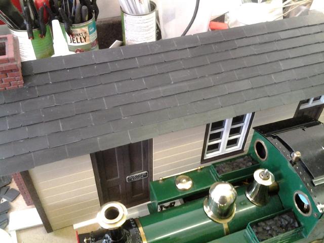

Post by bazzer42 » Sat Mar 15, 2014 9:17 am
This nicer weather eats your time but here's Arthur roof and Victoria nosing into the picture. Mild day, test new loco, go to midlands show or finish roof.....spoilt for choice. :D

Post by bazzer42 » Mon Mar 17, 2014 9:36 pm
I'm afraid I baulked at a 45 degree chimney and compromised at an end addition. Having done a Speech house Rd goods shed I think these will be a standard design on the old Vale of Fairway.
Materials - the 5mm foam board came from trent plastics on ebay, the 3mm I use for soffits and the goods shed door also came as A3 sheets from ebay but not sure who. The 5mm comes in a variety of sizes so you can choose the length you need.
For solvent I use pipe weld as used by plumbers.
For scribing the shiplap I use a 2.4mm pin punch and a good old fashioned electricians screwdriver for brick. Bricks I space at 5mm and 12mm long. The corners I work on the 5mm thickness being roughly the single brick face and press the end of the long brick to represent the mortar joint. No fillers necessary
I have used cut down plastic 12mm angle to represent the wooden corner members, hides the joints 8) .
to give weight to the buildings I use modern artificial slates for the roof base, about a pound each from Travis P. They will snap like plasticard if scored both sides but not so cleanly.....

I am just butting (if that isn't frowned upon in polite society) but I try and fool the eye by adding the vertical mortar joint at the very end of the foamboard. By squaring with a file and a good squidge of glue it doesn't look too bad from 6 feet. Admittedly I need new glasses but I'm happy. When I said no filler a cocktail stick and a hint of glue can help things.
if you can find a way of getting true 90 degree cut with a stanley knife, please let me know. I may try some of the olfa or exacto style cutters at some point.
The chimney was recessed by cutting a 5mm trench with an exacto chisel blade, cautiously!
