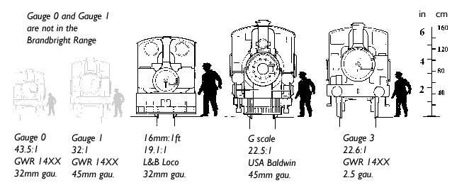

As the above replies prove there is no one definitive answer. I like this definition -

Brandbright have a section on their website although the image (below) seems to be no longer available - http://www.brandbright.co.uk/information.php?info_id=7Scale refers to the size of the model relative to the actual full-sized object being represented, while gauge is the width of the model track. Most commercially produced model track is a compromise between appearance and a trouble-free running surface.
