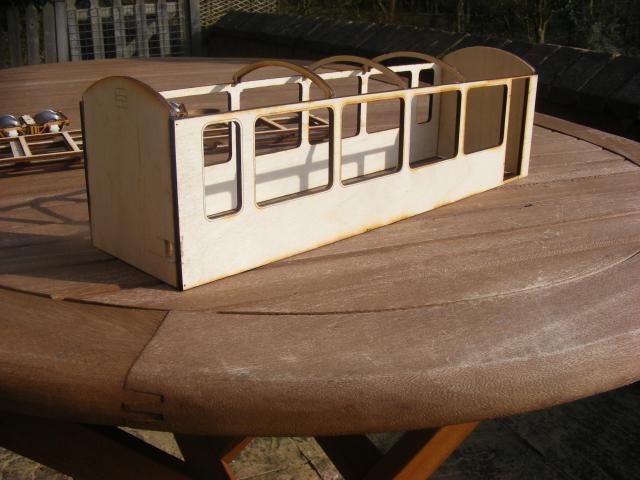

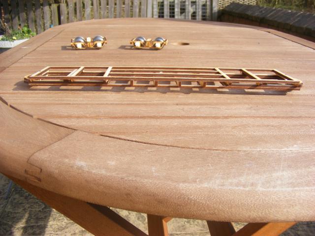

When I said "different method of construction" I was talking about how it goes together. Buy anybody elses's kit and (put VERY simply) you "put a box together", glue an underframe under the floor and fit the interior from the top before gluing the roof on.
With this, you have a more complicated and detailed underframe (with bogies) that you assemble and paint. Then you glue the floor to it and assemble the toilet compartment and seats on it. The body shell lifts off the underframe / floor, so you build the sides and ends, add the doors, take the body off the floor, build the roof out of strips of ply, paint / stain the whole (and fit lighting, if you want) and finally fit the windows, which have laser cut self adhesive frames which stick to the reference lines on the exterior, with the glazing a tight push fit from the inside.
So, it's a lot different to a normal build, but the results are very good!
Assembled underframe (bogies in the background)
Body shell
