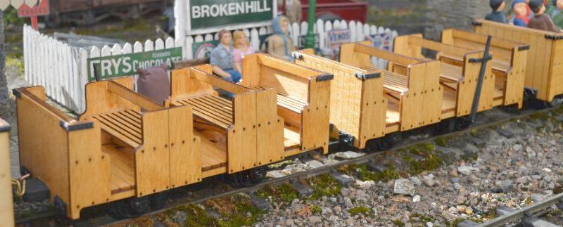

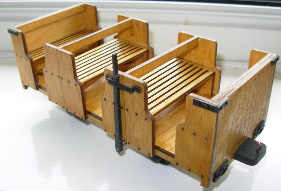

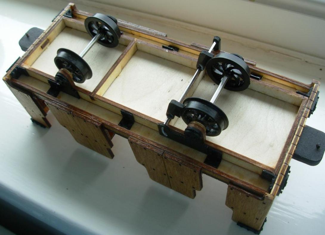

Here's some more rolling stock that I built last week after being invited to an open day .
I decided that my Penrhyn train was too short and needed a couple more of the workers
coaches to go along with the saloon coach and the brake van that I'd already made.
Made from 3mm laser cut ply with 3D printed detail and using Busted Bricks
bearings with Binnie wheels and axles.

Very nice!
LnBmad
Post by LnBmad » Thu Sep 19, 2013 6:04 pm
They look cracking mike! Have you got a shot of them behind Charles yet?
WVLR
Post by WVLR » Thu Sep 19, 2013 6:12 pm
Thanks folks, as requested, sorry about the full size R/C transmitter in the background.
Mine are the 2 in the middle sandwiched between 4 IP ones.

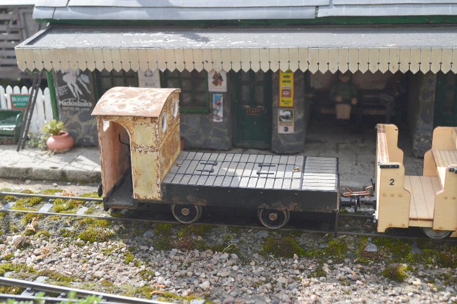

WVLR:89071 wrote:Thanks folks, as requested, sorry about the full size R/C transmitter in the background.
Love the Brakevan, wish it was modelled more mate :D
Also is that RC transmitter in the background to scale ;)
No it's 12" to the foot scale :D Blame the Bloke behind the camera :x, Me.
Thanks, I'm thinking of producing it as a kit, the problem is it's very
fiddly to make, bending plastic angle etc. I don't want to make it simpler
as then it wouldn't be Sanford.
I thought the weight was a riveter water tanks but on your model it looks like a large wooden structure, modellers licence or am I just incorrect

There was 3 versions, 2 with the water tank and the third with a low steel box filled with scrap iron
and concrete, this is the version that I modeled here, also the wheel base was extended on this version
to make it more stable, the same reason that the water ballast tank was taken off.
I may yet do a model of one of the previous versions.

Could it not be produced in ply
If it were just an ordinary piece of rolling stock then yes, but the prototype is based on a locomotive so using 3mm ply
it would look to chunky and thinner ply just wouldn't be rigid enough. The plastic worked very well,
I used 2mm for the chassis, 1.5mm for the body and 1mm for the roof, I even managed to mill the
hockey stick detail around the door from 1mm, very fiddly to do, maybe more of a commision piece than a kit.

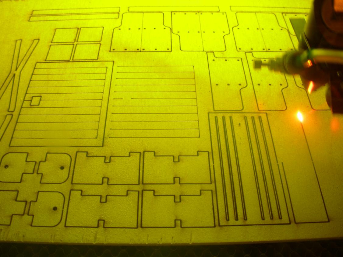

Hi, do you have a laser cutter of your own and may I ask how much it costed and what program you use?
WVLR
Post by WVLR » Fri Sep 20, 2013 9:46 pm
Yes I have my own laser cutter, the CAD program I use for it is vcarve pro from Vectric, although not specifically designed for doing this type of job it performs better and is easier to use than a lot of the more expensive cad programs, also being one of the official beta testers for it I am very experienced in using it.
