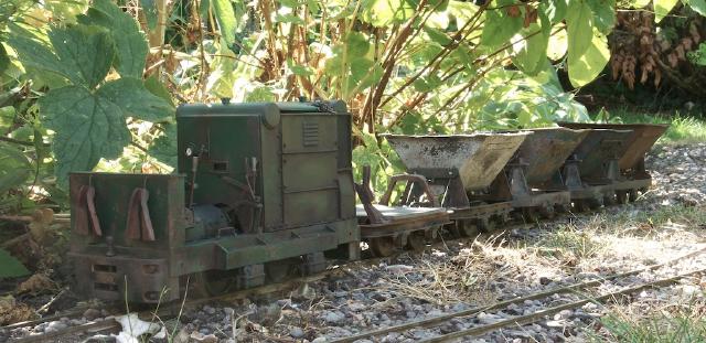

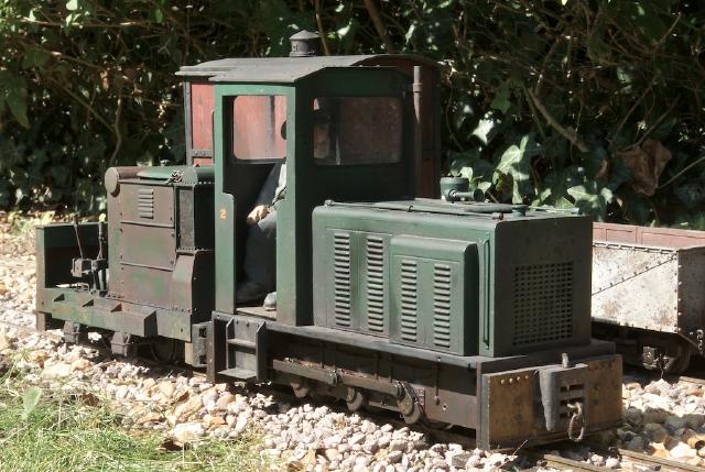

Its been a while since I posted much on here. The North Hampshire Minerals and Forestry Railway is no more, but there is a little known industrial tramway operating just north of Salisbury......
I bought an IP 7/8ths Ruston kit at the Peterborough show, and it is now more or less completed.

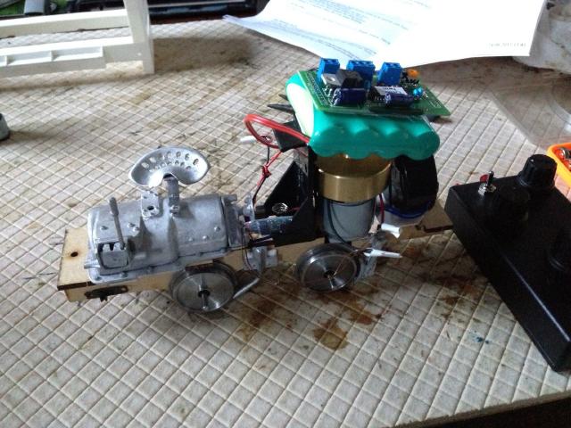

I built it for 18 inch gauge with extended side frames. The motor was replaced with a Heljan O Gauge spare from Howes Models (https://www.howesmodels.co.uk/Railways/ ... rodID=7012), the worm fitted to the motor shaft meshing perfectly with the IP gear wheel supplied with the kit. A suitable sound card was bought from Mr Acme. Radio control is from Deltang (http://www.deltang.co.uk/), a TX-22 transmitter and a tiny RX60-22W receiver and speed controller. Control is very smooth, quiet, and the loco will run very slowly. I've since put another receiver/speed controller in my Accucraft Baguley (which has been fitted with the same motor as above) and that runs really nicely too. The transmitter allows selection of up to 12 locos with a rotary switch. There hasn't been much steam haulage on the Sarum and Stratford recently.......
A few pictures:

Could we have some details on your weathering?

Thats very nice I also like these small industrial trains..
nice ogher loco in 3rd pic pulling the tippers
The weathering is the same as on the skip I did. See http://gardenrails.myfreeforum.org/about7222.html and scroll down a little for an explanation. Paint is again Just Like The Real Thing BR Southern Region green.
The other loco with the skips is my Accucraft Baguley with a replacement cab.

does ut pull a realistic load? seeing as it looks single axle drive..I know my steamplex will pull 1 open coach and a wagon like the real sized one.
astropsidings
Posts: 24
Joined: Wed Nov 28, 2012 2:17 pm
Location: Salisbury
Post by astropsidings » Thu Aug 29, 2013 10:51 am
jay1976:87431 wrote:does ut pull a realistic load? seeing as it looks single axle drive..I know my steamplex will pull 1 open coach and a wagon like the real sized one.
I made mine single axle drive although it is straightforward to drive both axles. However, as mentioned on the IP Engineering blurb about the kit, it will pull quite a significant load. The bonnet is white metal, so not light! I also filled the whitemetal gearbox with lead shot to counterbalance the bonnet, plus the couplings are also white metal castings, so there is plenty of weight on the driving wheels. I did change the motor of course.
My line is anything but level, but the Ruston slowly trundles round with much more than a prototypical load.

Post by jay1976 » Thu Aug 29, 2013 6:28 pm
Woild like to see a pic with a few tippers behind.. I have seen these kits and wasnt sure what they was made of or how heavy they are.. Mine would be 16mm(sm32)

Post by astropsidings » Thu Sep 05, 2013 1:52 pm
jay1976:87488 wrote:Woild like to see a pic with a few tippers behind.. I have seen these kits and wasnt sure what they was made of or how heavy they are.. Mine would be 16mm(sm32)
The frame and tool box is laser cut plasticard, and the rest is white metal, other than the chassis which is mdf. Mine weighs 1.5kg, but if built straight from the kit it would be a little less. Mine is built for 32mm gauge (but it is 7/8ths inch/foot scale not 16mm/foot).
Some pictures (I have a picture with some skips as well, but it won't upload at the moment):
Chain Shunting; With my Accucraft Baguley:
astropsidings
Posts: 24
Location: Salisbury
Post by astropsidings » Thu Sep 05, 2013 2:20 pm
Working now!
