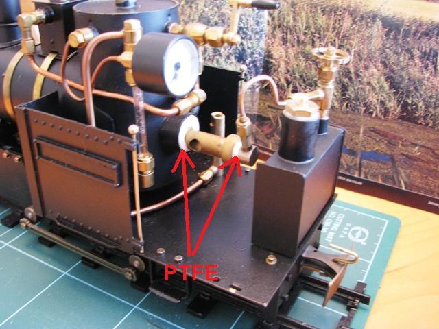

Having recently obtained a 2nd hand Lumber Jack, my first Regner locomotive, I have also been having difficulties lighting the burner.
It seems that Regner burners are more prone to having liquid gas coming from the gas tank, and looking at my other gas tanks (Cheddar Models, PPS Steam, Bix & Mamod) the only thing that is constantly different is Regner use a smaller diameter gas pipe (2mm whereas all my British gas tanks use 1/8" pipe). It also appears from surfing on-line that using a butane/propane mix in Germany is more common than butane only gas (Regner only sell the mixed gas).
My Lumber Jack does not allow for any adjustment of the air/gas ratio and the tip of blocking off one air hole whilst lighting the burner got me thinking. The gas jet was not sealed with anything into the jet holder (apparently these should be sealed with PTFE tape at the factory), the jet holder is a loose fit into the burner, and the burner is a loose fit into the boiler flue tube.
So I sealed the jet into the holder with PTFE tape, wrapped some PTFE tape around the jet holder then secured it into the burner, and similarly wrapped some PTFE tape around the burner collar where it is secured in the boiler flue tube.
This has now stopped the liquid gas fire I was getting at the front of the boiler flue/smokebox, although the burner does not always stay lit when it pops back (can take a couple of go's). Seems to light up easier with less gas in the tank (I have a ronson filler valve fitted and I now no longer completely fill the gas tank as it will outlast the boiler water capacity).

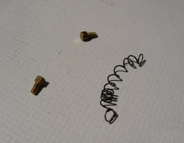

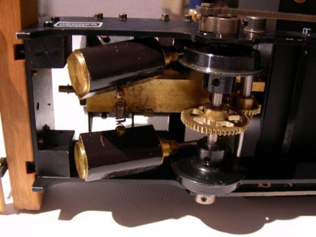

Here is the damage caused to a Lumber Jack in Germany which was having problems with that gas fire at the front of the boiler flue/smokebox.
The fire has caused the upper spring to lose it's tempering and the cylinders were no longer properly retained. This owner went through 3 springs before he sent it back to Regner for repair. They fitted a new gas jet which is sealed into the holder with PTFE tape - although that action does not appear anywhere in the instructions.
Chris Cairns.
