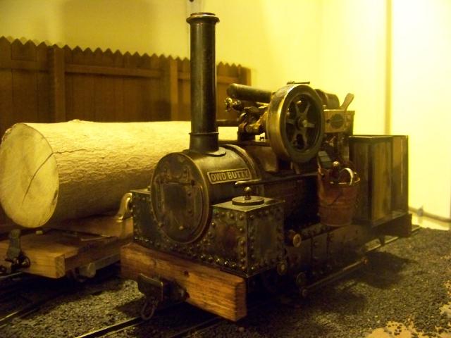

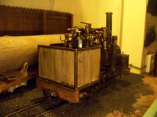

Post by jez kirkwood » Tue Aug 27, 2013 11:15 pm
Well it's been a while, but I was determined to have the loco ready to run at Llanfair this weekend. So I've finished the cab, replumbed just about everything and fitted the nameplates. The story is that the loco was built in the local workshops using the cylinder/crank/flywheel from an old Aveling & Porter portable engine - hence the plate on the cylinder block.... Anyway here's a few pics and hopefully she should be shunting Waterfield Hall at the weekend. If you're there at the show come and say hi - think we're in one of the squash courts.......

Post by TTHLRMatt » Wed Aug 28, 2013 9:30 am
Brilliant, how did you get your finish on the wooden hornblocks ect, it looks very realistic.

jez kirkwood
Post by jez kirkwood » Wed Aug 28, 2013 11:03 pm
Hi Matt
Most of the woodwork is hardwood off cuts (mostly from old furniture) cut to size on my bandsaw, then distressed with a wire brush wheel in a cordless drill which is then painted with vinegar which has had rusty nails/wirewool added to it. this looks rubbish when you brush it on but the next morning looks great! The planking on the cab is ice lolly sticks treated in the same way. The metalwork has all been treated with 'Rob & Si's blue jollop' which is availiable from Modelearth Designs and Busybodies.
Post by Andrew » Thu Aug 29, 2013 10:24 am
That looks fantastic, well done! I'm about to pinch your wood distressing technique for a project I'm working on. I've used the manky vinegar solution before, but not the wire brush, looking forward to experimenting...
