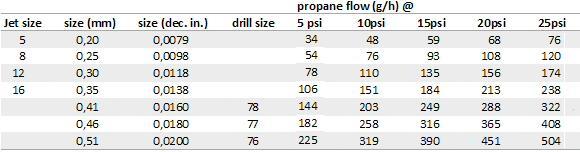

Found it - here is some test results from a ceramic gas burner.
So increasing the jet size needs a similar increase in air flow to get the right burn - the current Mamod jet holder does not allow for much movement to change the gas/air mix.
I have a couple of different jet holders so I'll experiment with my William II/Mark II burners although not sure what size of jets I have available.
Chris Cairns.
