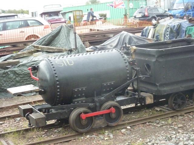

Post by DaveWatkins » Sun Sep 11, 2011 10:06 pm
Has anyone made a working model of one of these?
http://www.youtube.com/watch?v=080iwBKaEMM

tuppenced
Post by tuppenced » Sun Sep 11, 2011 10:26 pm
I've seen a 16mm scale working model driven by compressed air, but it wasn't a model of that kind of locomotive.
It was a Fireless locomotive using the boiler* as an air tank.
Naturally it didn't run for very long because quite sensibly it used low pressure (roughly what we would use for steam), yet it was great to see it going.
I've a feeling it could have been made by Stuart Baker, but don't quote me on that without checking.
David 1/2d
* Yes the pressure vessel on a Fireless locomotive IS a boiler. It is charged with hot WATER (not mere steam) under high pressure. The water boils into high pressure steam as the pressure drops. The steam is fed to big low pressure cylinders through a Regulator.

Post by Dr. Bond of the DVLR » Mon Sep 12, 2011 6:06 pm
Haven't seen a model (or that prototype) but really want one. It looks quite a small compressed air tank, how far can it run?
(to build)
DaveWatkins
Post by DaveWatkins » Mon Sep 12, 2011 6:48 pm
The driver told me that in the Earl of Durham's colliery they had to have a recharging point every 400 yards. As seen at Apedale it was hauling an air compressor about with it in the second wagon. Driving with the compressor running would of course allow it to go a long way.
It has slip eccentric valve gear so to reverse you have to get off and push the train the way you want it to go in order to reset the valves, The Earl was too mean to pay the extra for proper valve gear.
