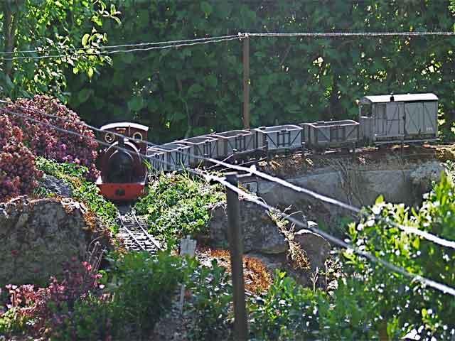

Having lost a few bits and pieces of lineside buildings etc through our over-sized dog running wild in the garden, we decided to adapt our heron scarer to go round the railway and not just the ponds. Mr F C came up with the idea of telegraph poles carrying electric 'cables'. The cables are the same electric heron scarer wires. Very simple idea, all we did was get some lengths of dowling from b&q and soaked them in creosote substitute. We left them very long so that they would be well in the ground and not knocked out easily. Before he put them in he fixed a short length of old track as a bar across the top of the pole. This was nailed in. The wires are then run at 90 degrees to each end of the bar and fixed by small cable ties. I think he put a cable tie onto the bar first so the cable is insulated from the metal. The scarer is wired up to our outdoor electrics so that it can be switched off at any time.
But, we have forgotten from time to time!! Ouch! Seems to have worked very well so far and it would be good height for cats as well even without the electric bit. It runs all around the outside of the railway.

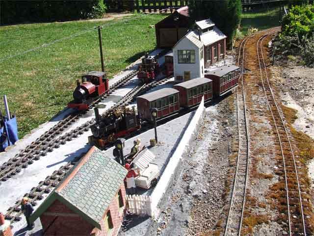

Don't panic guys it gives a low voltage pulse and makes a very satisfying little 'crack' sound when you touch it! It is quite safe but does make you jump. If you are near the transformer you can just hear a clicking sound as it pulses. The one we bought some years ago (pre MPLR) came with 40 metres of double strand wire which you can double up, and lots of plastic sticks to attach the wires to. It doesn't come with a 3 pin plug just a transformer. So we pulled it up from round the pond where it had been protecting the koi from heron and moved it to the outside edge of the railway and bought some extra length of the same wire to o all the way round.
I've managed to find a few pics....
You can just see the poles along the edge by the grass
This is runs all along and round the corner...
and along the edge of 'Chafford Gorge'
