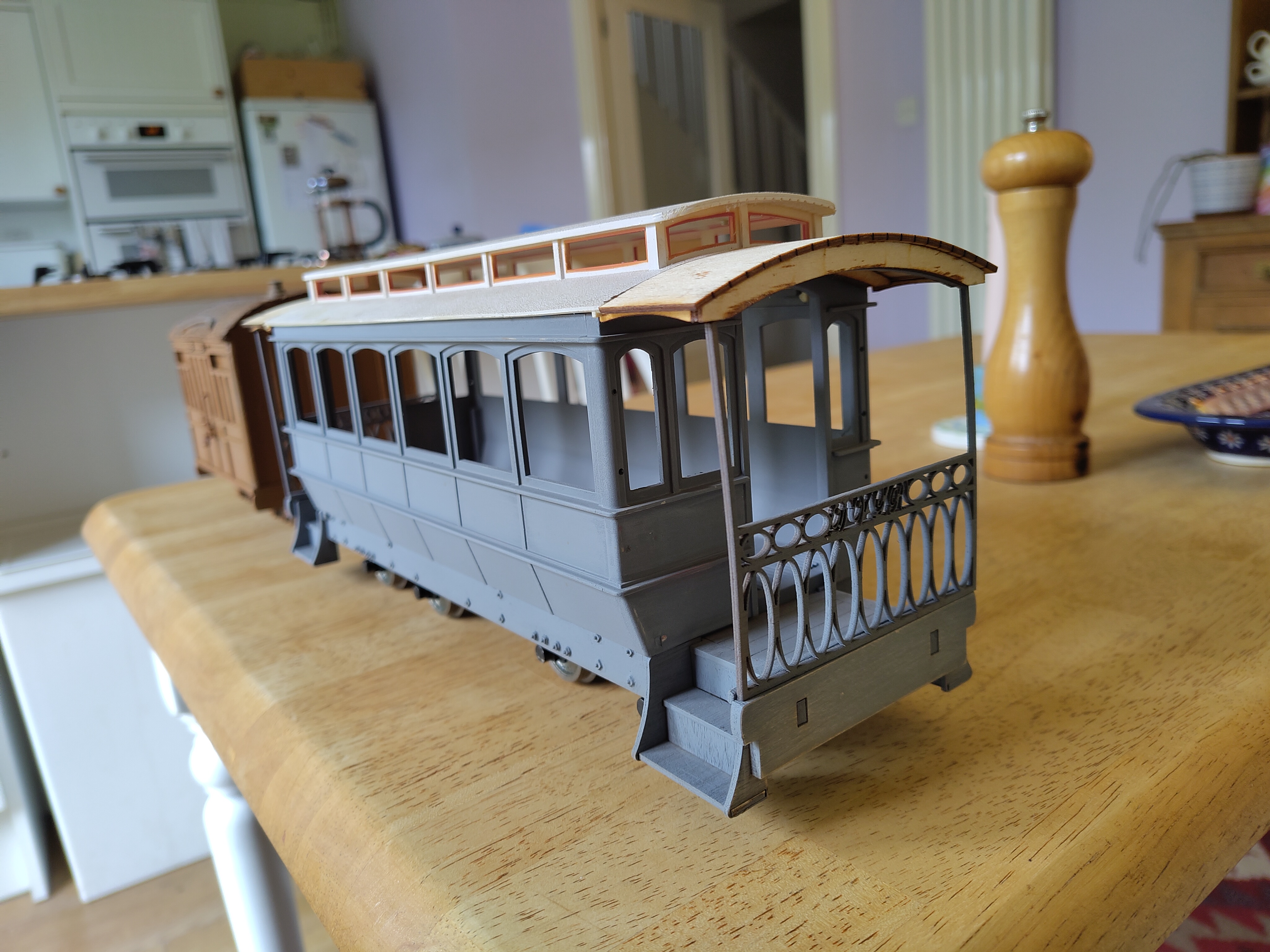

Back in April 2024 I bought a Bachman Street Car from ebay. At the time I had not seen StuartJ's post about his conversion! What I had in my head was a conversion to a typical Colonel Steven's backwater railway balcony carriage with some hints to the W and U carriages thrown in. It was also bough as another excuse to have a go at painting a carriage in Stratford Brown with lining.
The body was kept pretty much as is with some of the holes filled. The roof and balconies, however, were redesigned to give a more Wisbech and Upwell carriage feel - as usual, these were drawn up and laser cut. The balcony ends are a snug fit into the plastic moulding of the body and were epoxied on.

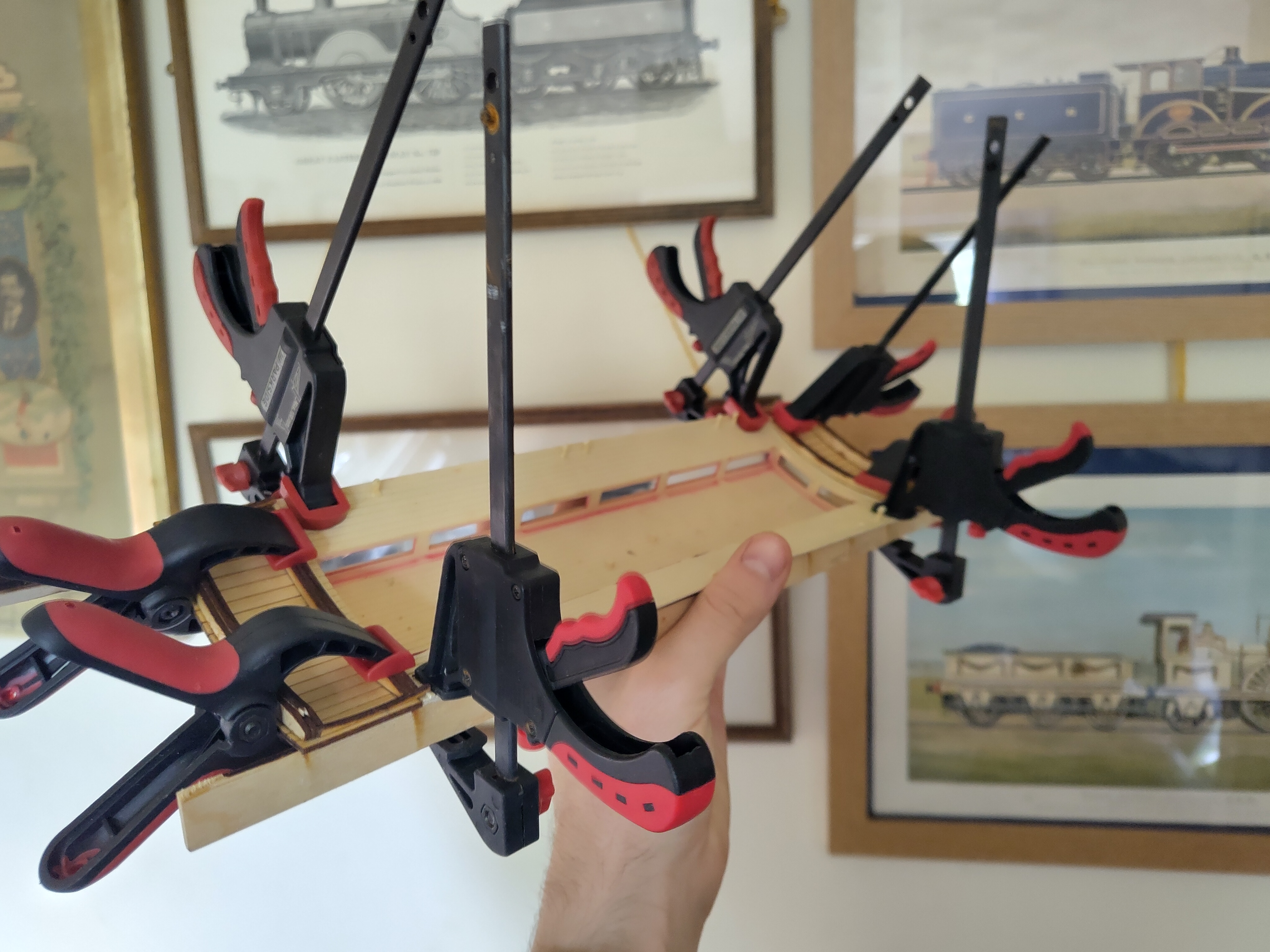

The solebars were then detailed up with Cambrian plastic nuts and bolts, with reference to the W and U carriages and the curved ends of the roof were sawn off and replaced with LASER cut ply ends which were carefully glued and clamped to the existing roof with high strength epoxy. I am reminded of a saying from a boat building friend of mine "He who dies with the most clamps wins".
Following this the carriage was primed ready for painting - the balcony railings are LASER cut from 1.5 mm mild steel using the department's fibre LASER.

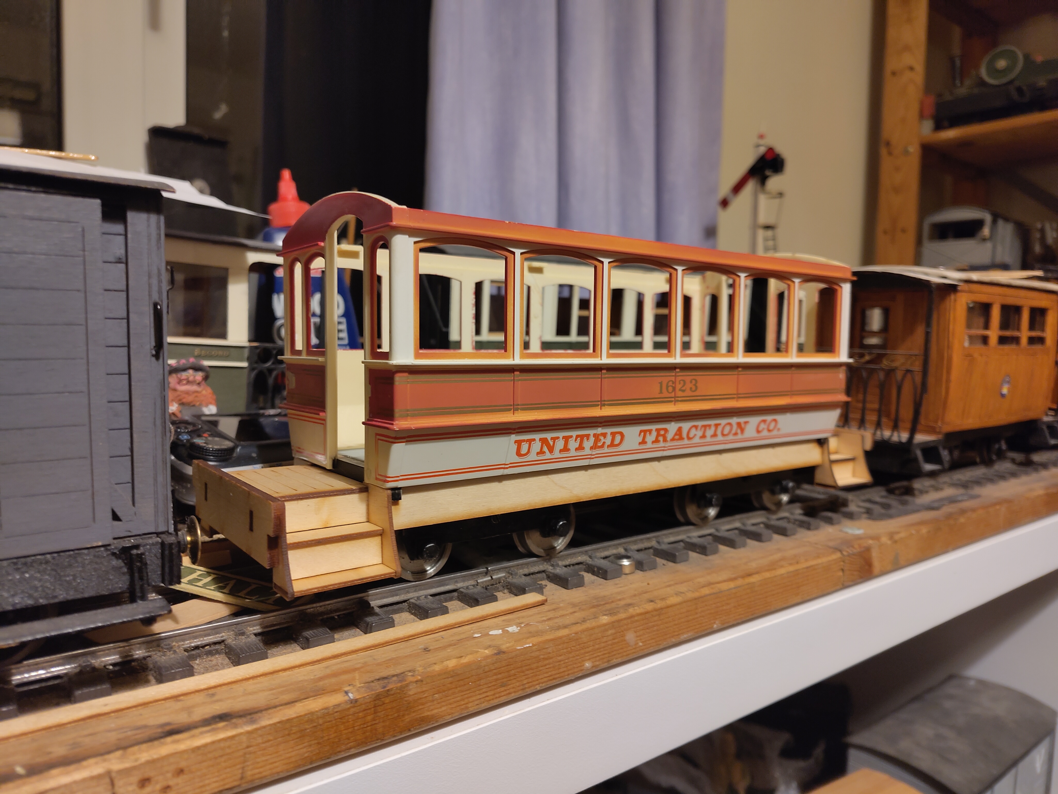

Every time I see one of those trams for sale I think about how I could convert it (being a sucker for tumblehome doesn't help). Ideally I would like two, to be able to add possibly another two or more windows. Your work has strengthened that view, an attractive and thorough job. Thanks for sharing.

That is a great idea - proportionally I think that would look very elegant. I'm sticking with this length as my limit at the moment as I don't know what constraints on space I'll have to work with when I eventually build my railway again. I think a short version, 4 windows, would look quite hansom too. Perhaps if you take two windows off one to build a long carriage, I could rescue the remains!
