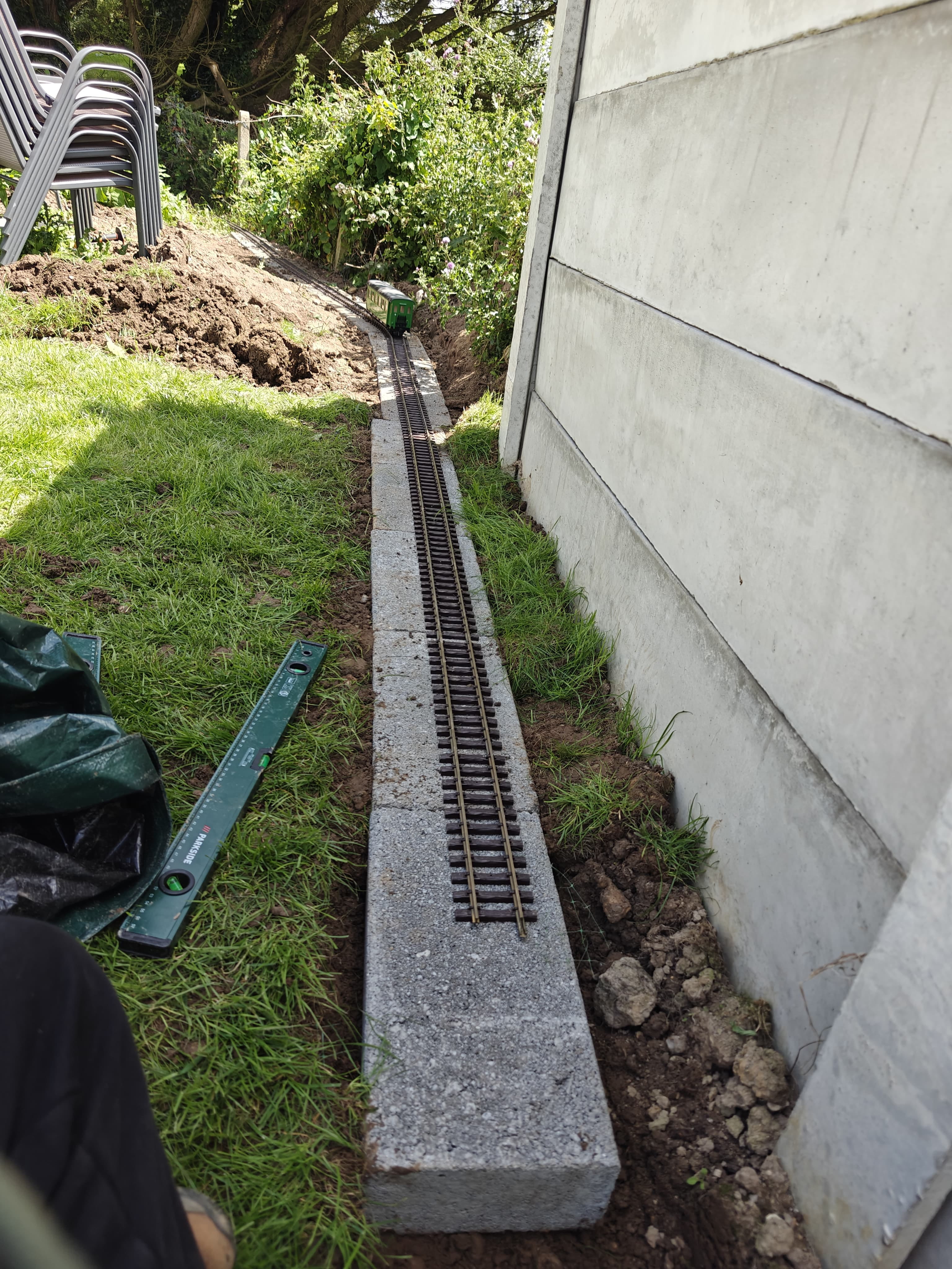

Great start! Make sure you firm up the soil beneath the blocks as you lay them to try and discourage them from settling.
nlc1072
- Posts: 40
- Joined: Mon Apr 27, 2026 2:20 pm
Re: Stawberry Valley Light Railway
Thank you ge_rik!
I have been out jumping up and down on the dirt and then the blocks to make sure they are all compacted since your mentioned that now. I added some more blocks and track.

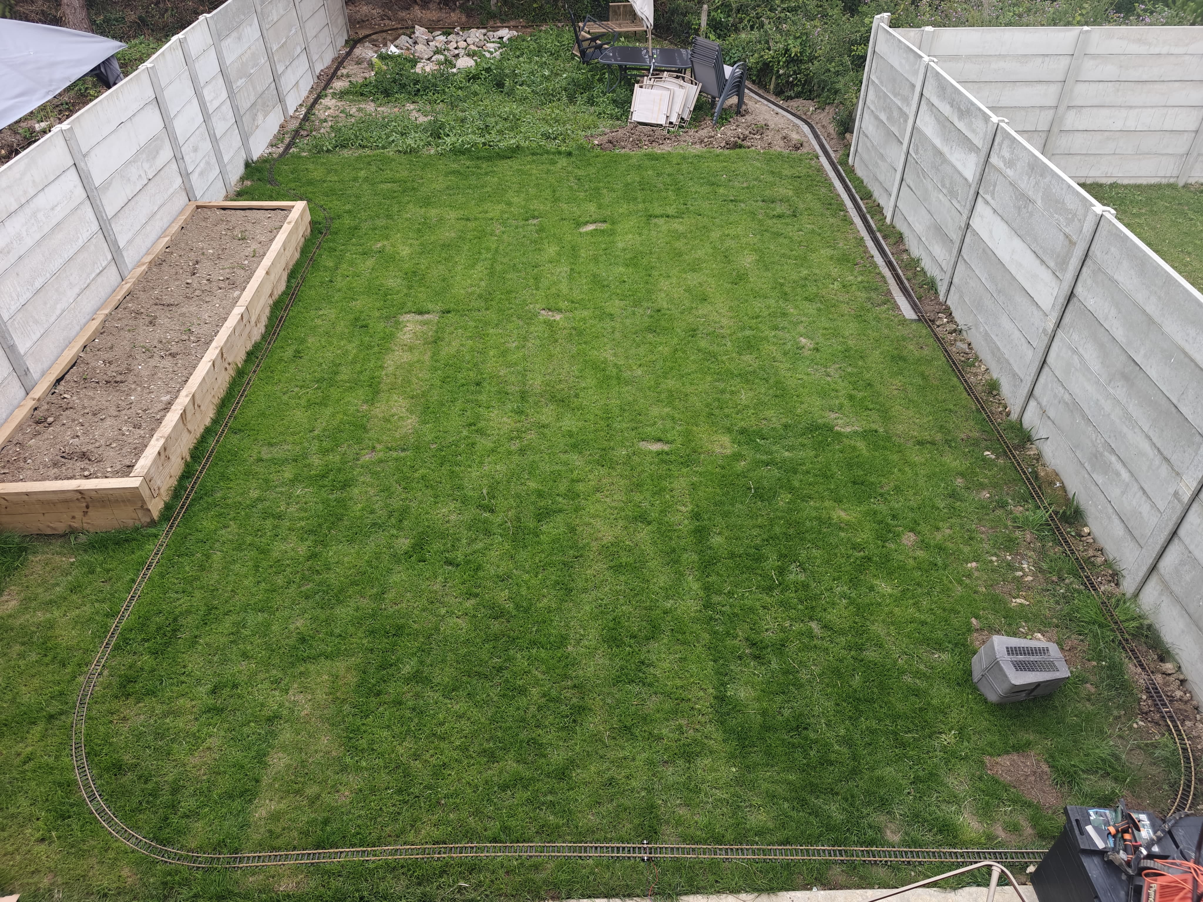

Here is also an overview of the basic track plan so far.

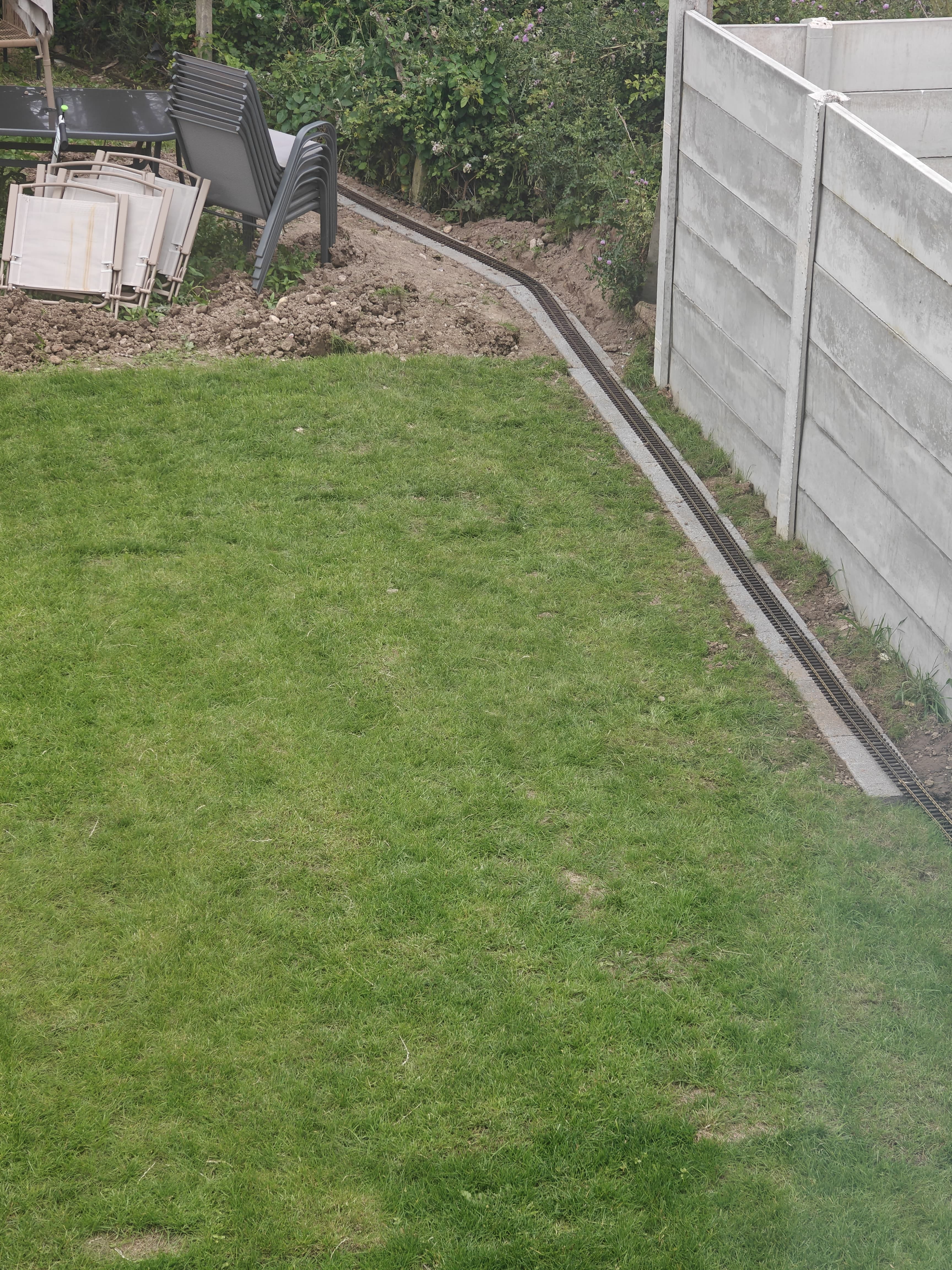

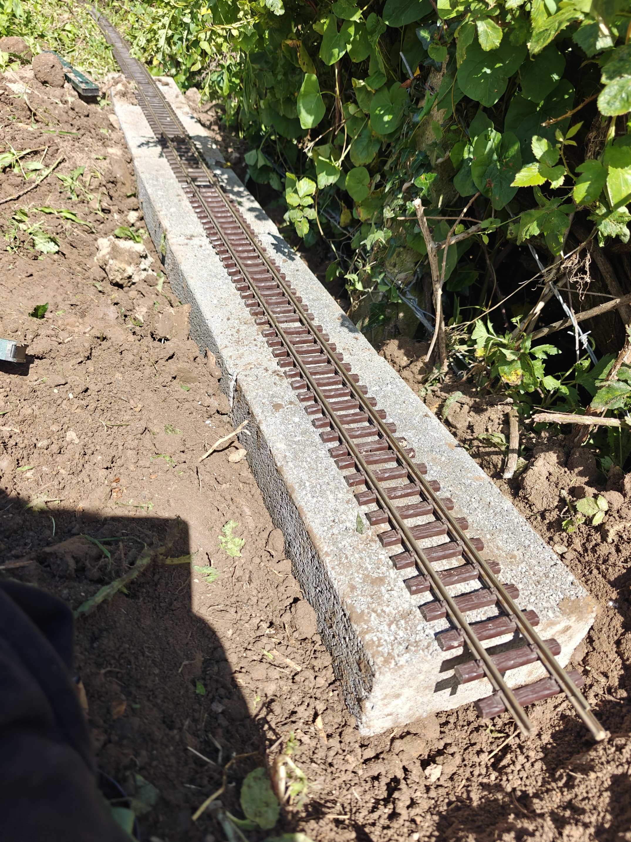

So today I bought twenty more bricks (it's the most I can fit in the boot of my saloon car!) and laid those this afternoon, taking care to lay them firmly so there will be no subsidence.
I had time to sit back and watch some trains go around! I apologise in advance of the high speeds of the trains as they had to deal with some sharp inclines on other parts of the loop I have yet to lay the track bed.
The gap in the track bed in the video is to put in a bridge which I am 3D printing as we speak a prototype in PLA to see what I like and dislike, I have to get some ASA later to print the finished product which will do better in the sun - Thanks to Trevor Thompson of this forum for the inspiration to get a proper 3D printer and see what I can do.
- Posts: 6040
It certainly seems to run smoothly. If it will take those speeds without disaster, it should look good at more realistic ones.

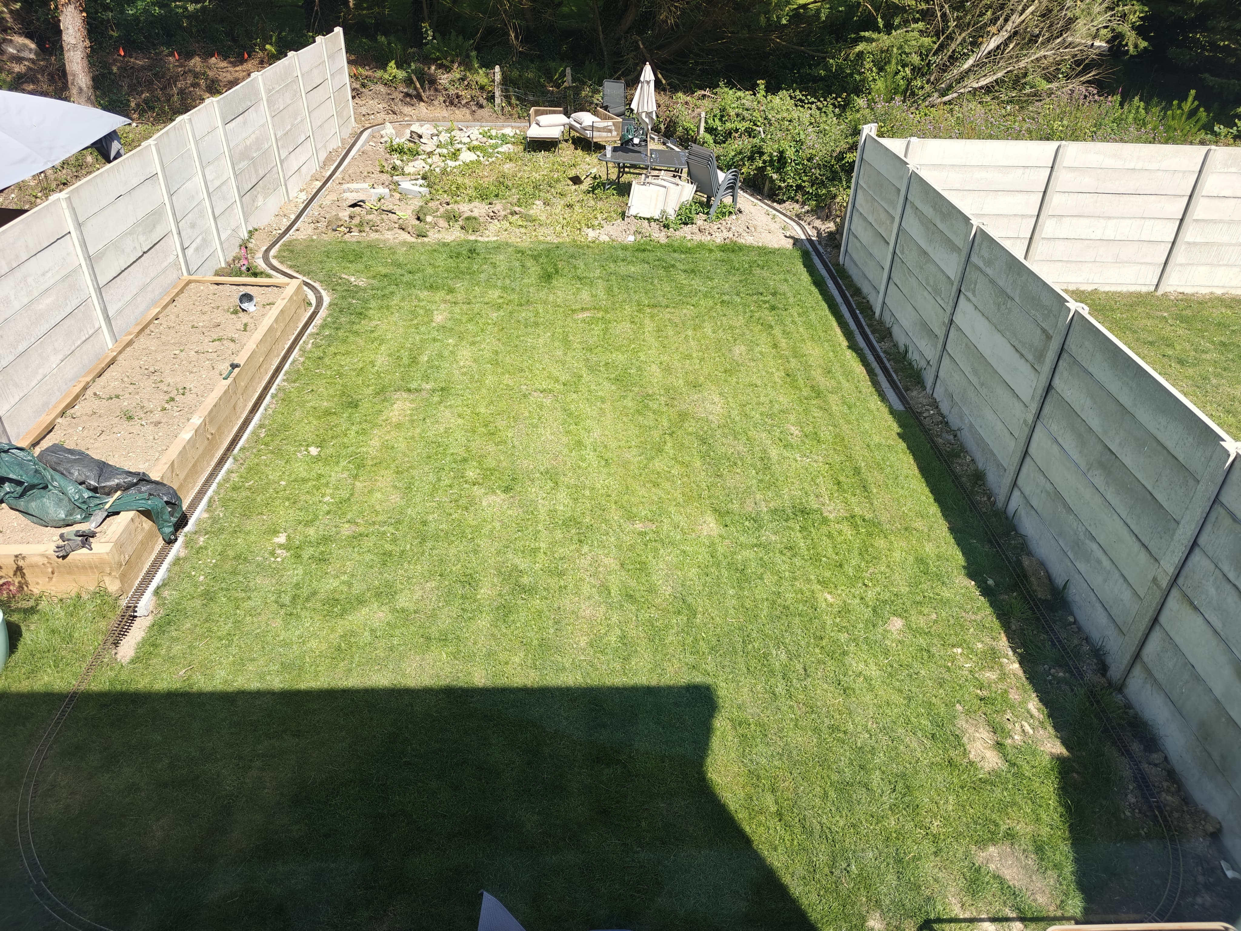

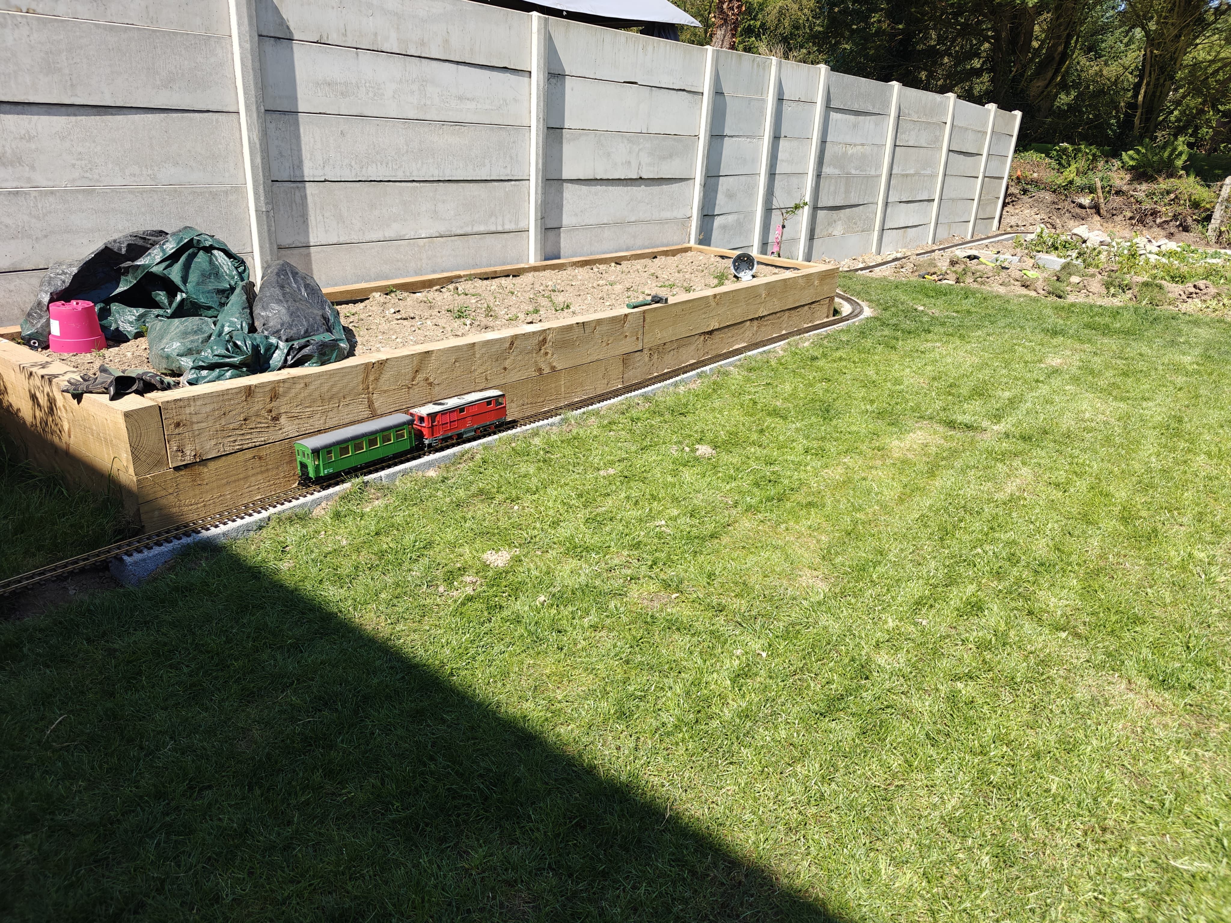

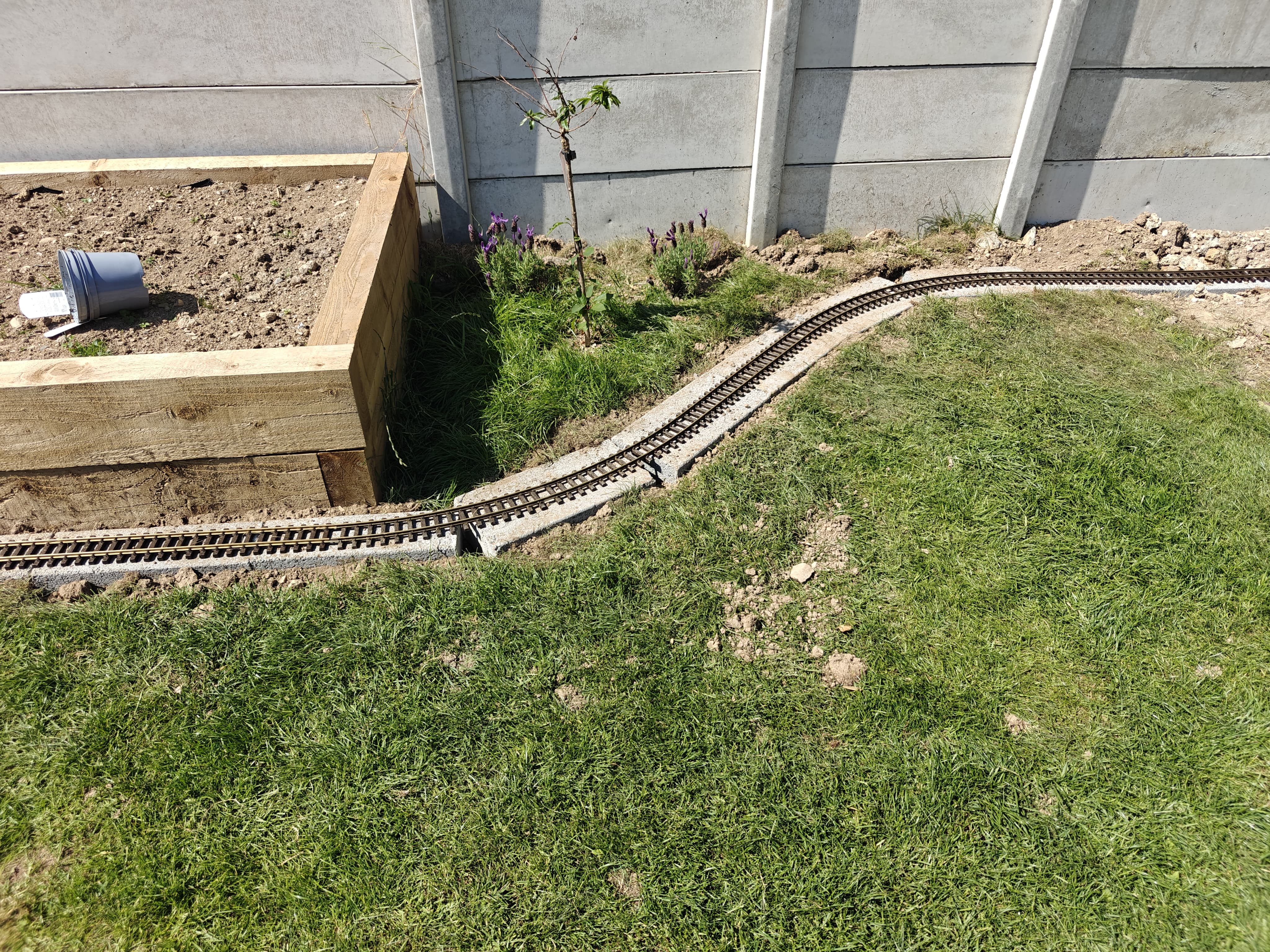

Thank you!Lonsdaler wrote: Fri Jul 10, 2026 10:10 am I'm loving your progress so far. Do you have plans to add sidings and passing loops? The biggest regret I had on my original GWLR railway was not including sufficient space for stock and areas where trains could pass. Looking forward to seeing the progress of your line.![]()
I got 40 more bricks and laid about 25 of them, mixing some narrower soap bar bricks with the larger ones.
The left over large bricks I shall use to make tunnel on the right hand side where the concrete fence finishes.
The plan for passing loops etc is to have it run through a shed near the house on the R2 corner, and immediately outside the shed have a passing loop and head shunt for a station.
The gaps on the curves in the brick I plan on filling with concrete later once I am happy with where everything is, then laying a suitable sharp edged ballast.
I have just bought a book on suitable plants for a garden railway, and I am also considering a water feature of sorts.
In other good news I have repaired the printer somewhat, new build plate and a new extruder sensor and it's printing like new again! I got it at half the price of a new one plus a free AMS2 Pro so it was still a brilliant deal. It came without the glass lid, which I have also replaced. I reckon the last owner got angry and shattered it when their poor repairs kept failing, and they really did try to repair it without replacement parts... a lot...
The old owner of the printer seems to of had it apart and screws are missing here and there, I have made do and it all holds together just fine now.
It needs a new extruder cable chain and base, but that can wait a while.
Surprised it came in the mail so fast from Germany before I go away this Sunday, so we're ahead of schedule so to speak.

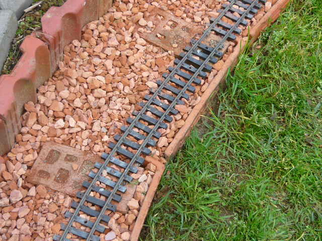

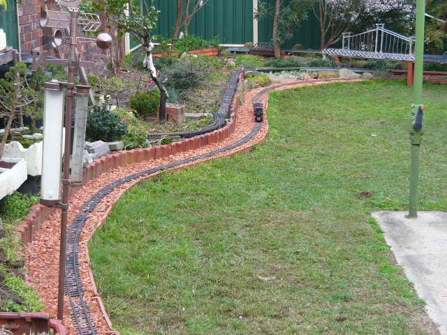

From personal experience I highly recommend some form of edging along the track to;
1. Keep the ballast in place and
2. keep the lawn from growing over the track
Down here we can get cheap plastic edging in rolls from the garden centres with pegs and believe me for the cost, the time saved from weeding out lawn from the tracks an edge will be worth it. I used old terracota roof tiles (got 5 trailer loads for $50 from a house demolition place) for the edge and crushed ones for ballast.

I force concrete into the gaps between the blocks to prevent weeds from filling them. I use rubber glove clad fingers rather than any sophisticated tools.
